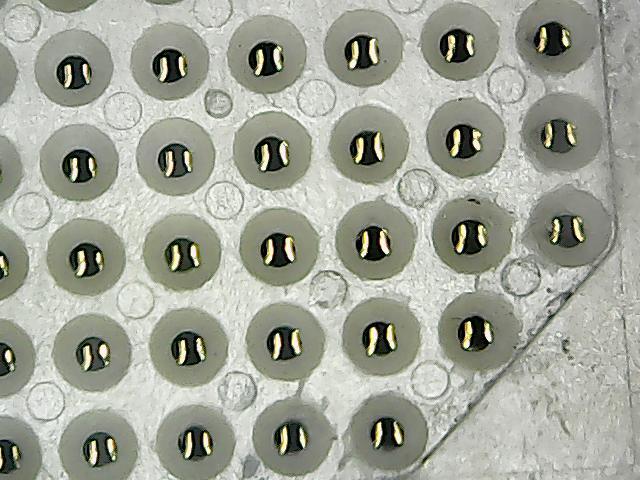

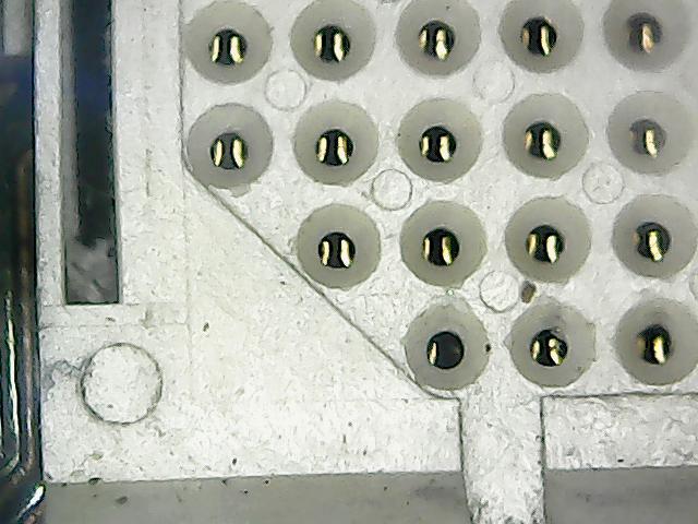

                Maybe due to this?
                Top right and bottom right
                Click image for larger version  Name:	top right near lever..jpg Views:	14 Size:	50.5 KB ID:	3208398 Click image for larger version  Name:	Top left.jpg Views:	0 Size:	59.0 KB ID:	3208421
                Bent the CPU pins a bit, when taking it in and out, so wiggled it into the socket
                Bad move!
                If the CPU doesn't fall in by itself, do not apply any pressure whatsoever
                Tried to open a socket 754 socket once, but destroyed the top of of in the process - they break really easily, and you'd be very lucky to remove it without breaking the plastic,
                and this looks like the same deal
                The damaged hole is MEMDATA[105], but that's to do with the RAM, so it's possibly not the reason why there is no VCORE or any POST
                Checked the holes for VID0 to VID5, and they all look good
