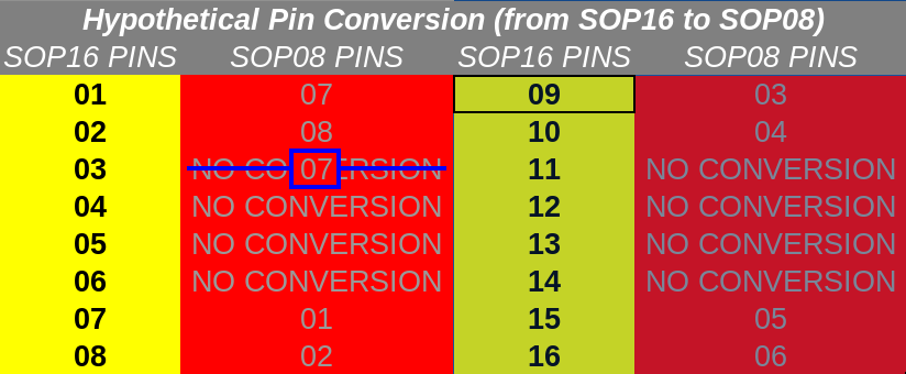

    Re: Archer C9 V.4 Can ch341a be used for programming a 16pin Winbond w25q128fv
    Hi everyone (again)
    I've produced a conversion helper image to explain what's on my mind right now.
    and
    Can anyone please tell me if my reasoning is correct?
    What these images intend to question is: can the pin mapping from the images that I've posted be useful to convert and use the 16 clip to the ch341a 25xx series pinout?
    Thank you tremendously for any help.
      I always remove chips to program them as there can be interference from other components on the board. They make soic16/8 pcbs that fit into the top of the c341a.
          I see no reason the conversion won't work, its just the same as the pre made PCBs that take SOP8 and SOP16. https://www.aliexpress.com/item/1005001815308275.html
                Ok! You're right!
                I've (finally) understood that I could have used (before) a multimeter to check the pinout. And it does check!
                So: these images (from that "alleged" converter), are going to work
                  SOP16 has an extra /RESET pin (pin 3).
                  Therefore, as it might not be wired on the PCB to pin 1, connect both to pin 7,
                  i.e.: SOP16 pin 1 and pin 3 to SOIP8 pin 7.
                  See attached table.
                    See attached table.
                    Hello dear friend @megaraider.
                    I hope you are still out there somewhere and living a merited joyous life.
                    I am answering you only now because gratitude is in the order of the day.
                    Well, with your insight-fullness along with others, I was finally able to use flashrom utility on my systems.
                    (although having had major trouble using ch341a, which I haven't yet figured out how to make it work) I had some luck using a raspberry pi 3b+ to the same (SPI) purpose.
                    And I think that you did have a tremendous impact on this fact. I mean, by pointing out that "detail" of bridging the 3rd SOP/SOIC pin as well!!!
                    Therefore, thank you!
                    Now I am going to find out if reprogramming the bios can indeed sort things out!
