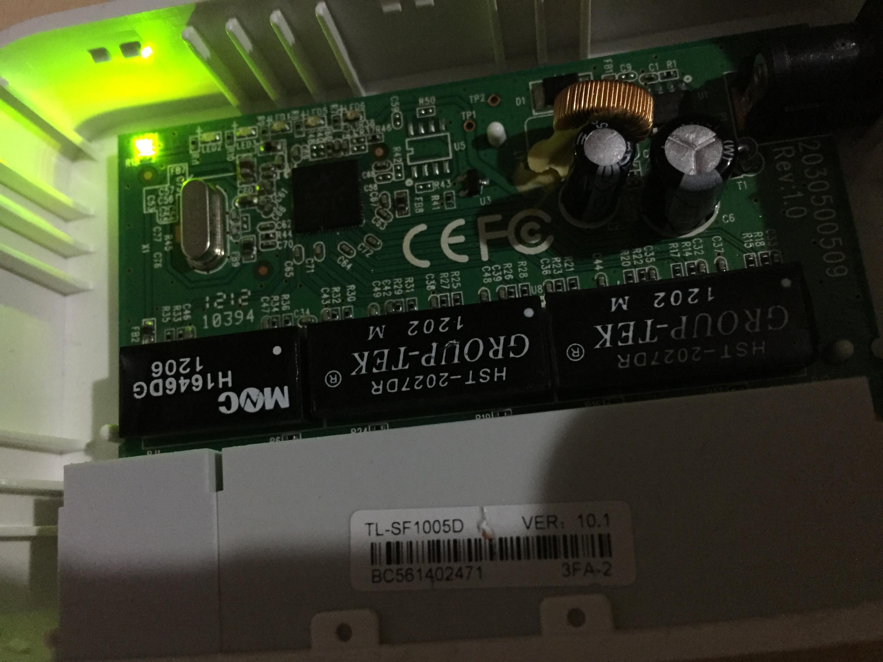

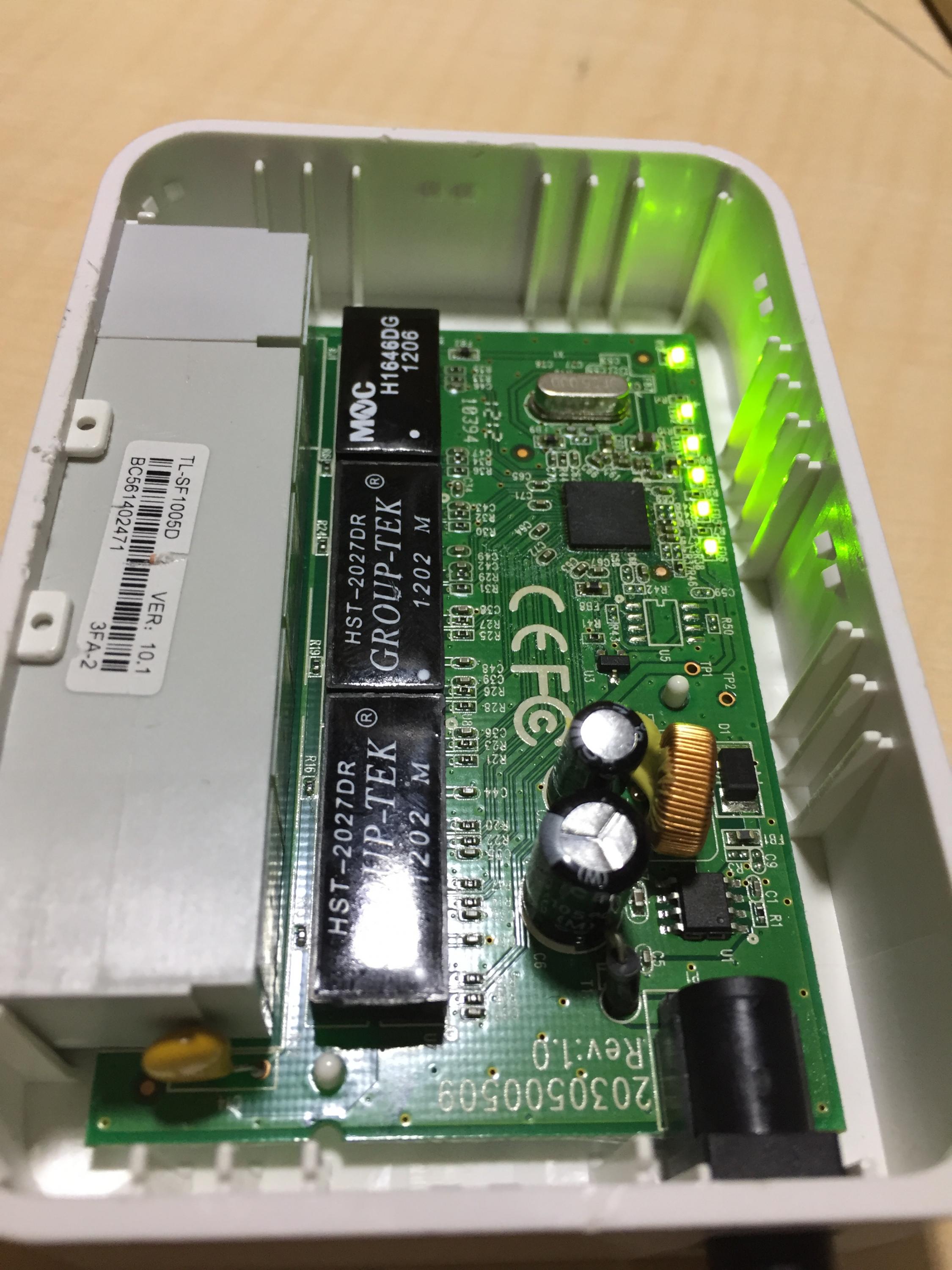

    Hi guys, I have a two switches.(TL-SF1005) but we have a problem. the led lights up constantly sometimes flashing. I gave heat to the main chip but this is not working. what can I do? thanks.

    replace the electrolytic caps with something good like panasonic FR series.
    the smaller one looks domed and caps dont last in this type of gear.

      Hi, which component? Capacitor?
        • 30955
        Re: TP-Link TL-SF1005 Switch Problem
        yes, c2 and c6

          After a storm or overvoltage? I am not sure that replacing the caps will fix the problem.

              • 30955
              probably heat,
              they used to be in fan cooled cases with heatsinks on the chips - now they are often just closed ovens
