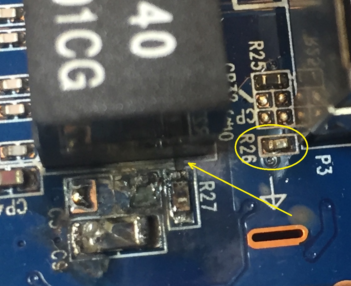

    I just purchased this off an auction site that will remain nameless... When I got it, it was DOA. So, I pulled it apart to find a bad Cap and resistor. Now I just need to figure out what they are so I can replace them and hopefully get this thing running again.
    The parts in question are C9 and R27. C5 is right next to C9 but it does not appear there was anything there to start with, but I would like to confirm that.

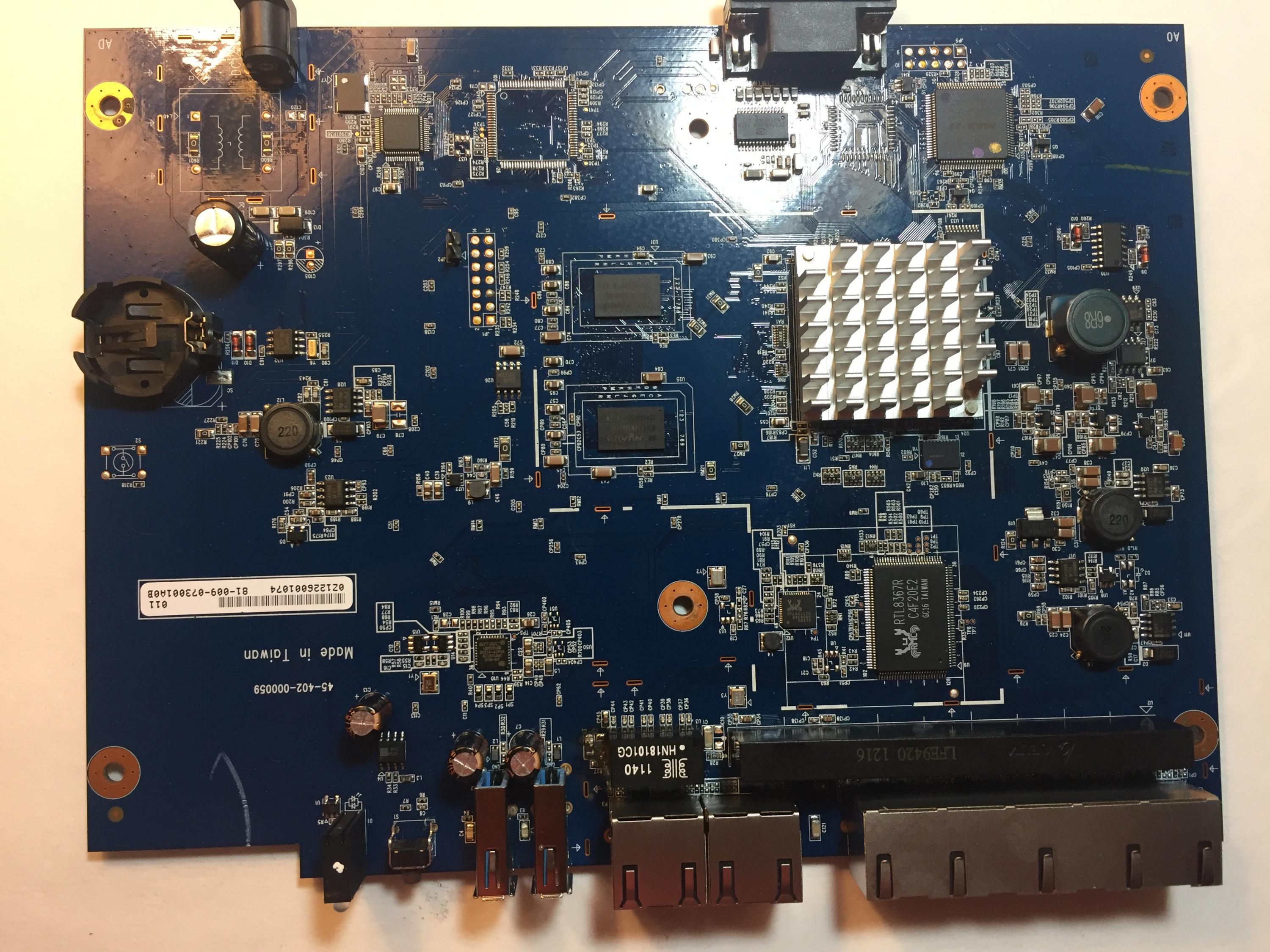

    post a more zoomed out foto,

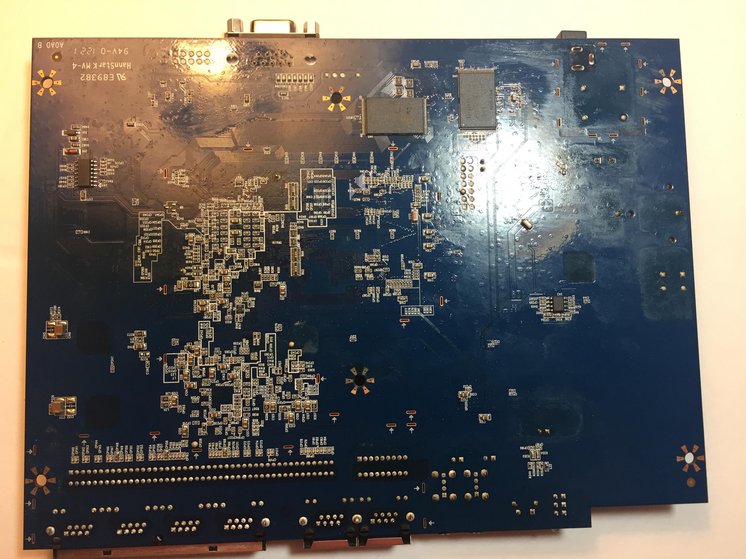

      What is the model number of the router?
      Can you give a photo showing the entire board (both sides)?

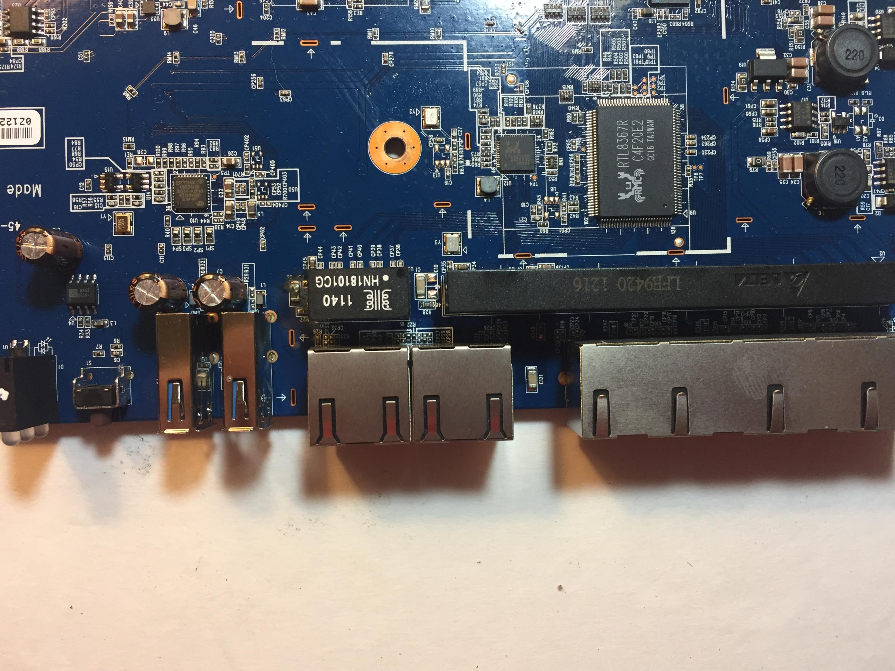

        Agent24; the model is SyWall USG 50
        Agent24/stj; I have attached some larger pics of the whole board and a more zoomed out of the specific area.

          Is that the WAN port?
          Does the router power on and work at all?
          Because if only those resistors and caps where hit it would still work.
          Just without the WAN port that is, but looks like lighting damage so could be more stuff dead...

            Yes, those are the WAN ports (there are 2).

                I was looking a little closer and noticed that there is a burnt trace that goes under the module beside R27. I guess that means I am going to have to pull the module off to repair the trace.
                I also noticed that R26 looks burnt (guess that makes sense).
                I attached a close up of the area.
