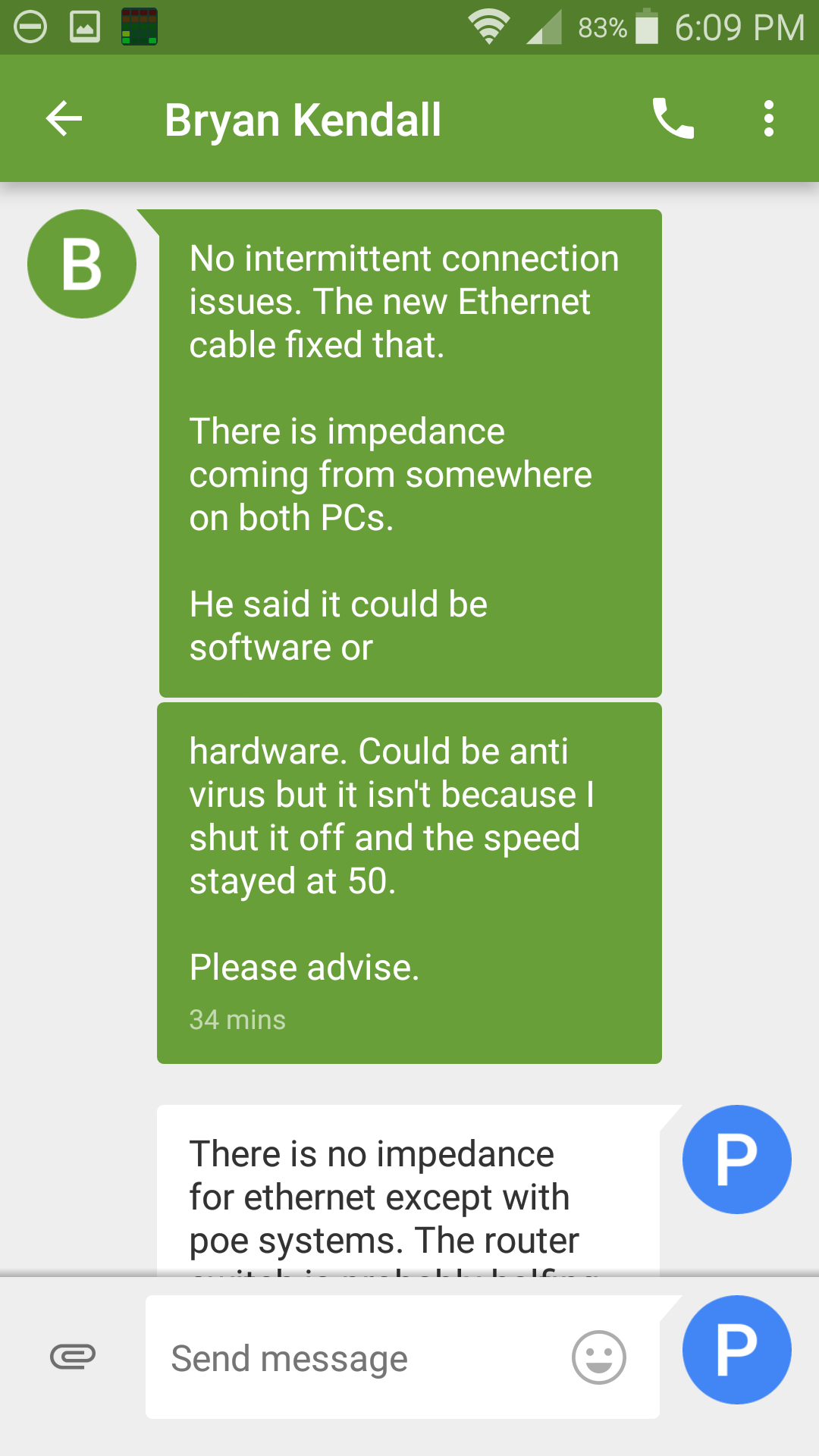

    Am I wrong on this?
    I told him the throughput is likely the switch, or an idiot time warner tech

      There is not enough information in the screen shots to be sure what is being measured. For example, if the tech is reading framing info, or measuring actual throughput to the first hop router (wherever that is physically located), and the user is trying to use speedtest.net, or to download a file from a real server out on the Internet when everybody in the neighborhood is doing the same, it is no wonder that the measurements differ.
      One of my co-workers who is paying for 100 Mbps Internet access over Verizon FiOS asked me to check it, and he was really getting 100 Mbps to speedtest.net.

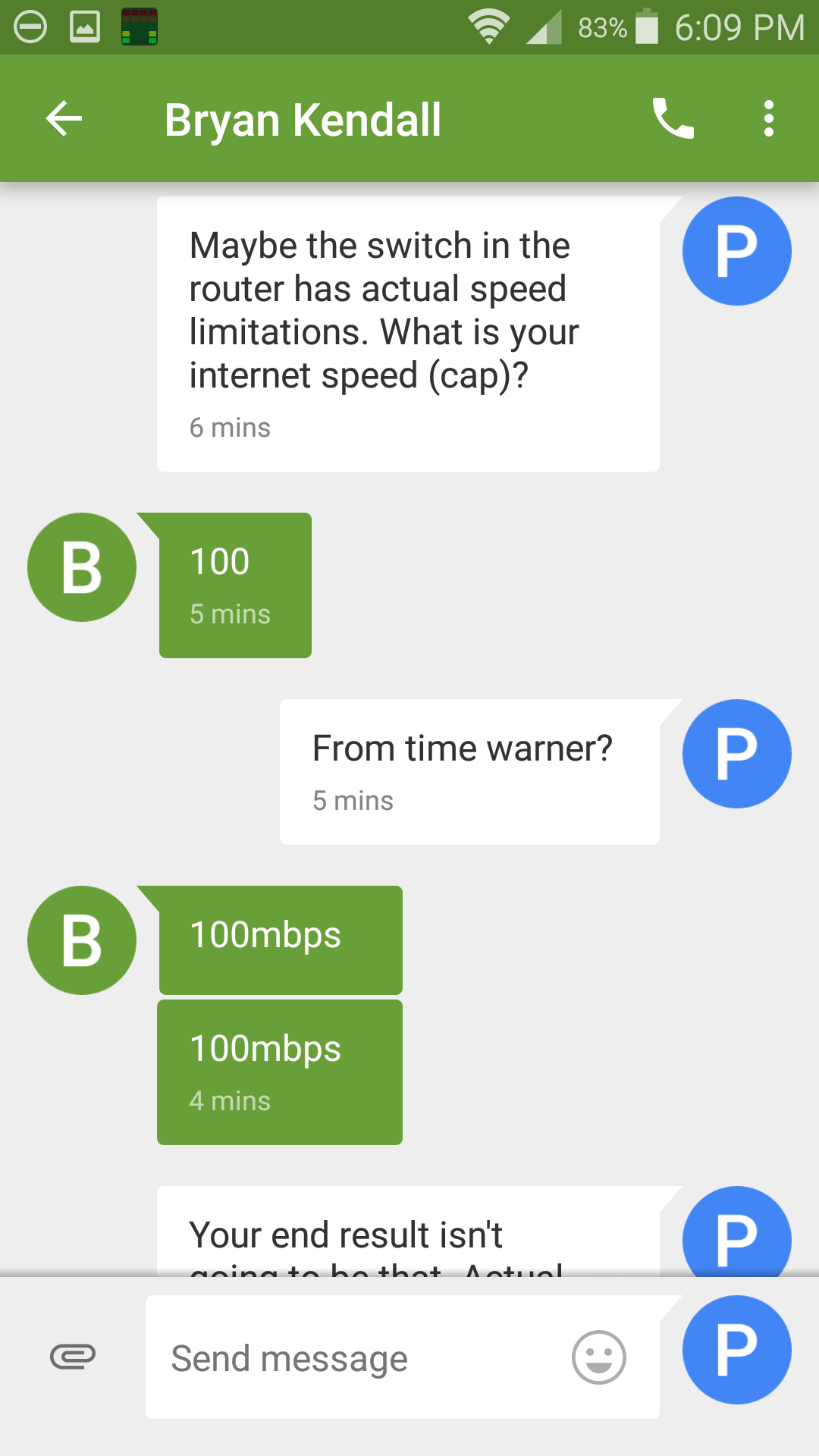

        Re: Am I wrong on this?
        Depends on the speed of the can on the other end of the string (what server you're measuring from). Also, there could be a limit on the modem or router if either was bypassed.
        Also the tech may be using a BS tool that is more marketing than diagnostics.

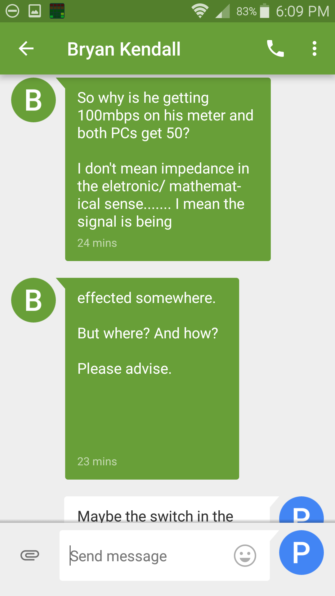

          One thing not included is on two seperate computers hes getting 50mbps on ethernet. So I was thinking perhaps router processing power
            well router ethernet>ethernet port performance is generally crap compared to a hardware switch / hub,
            but exactly half the rated speed is a bit suspicious.
              try plugging in a third pc/laptop/tablet/whatever if the router has a third ethernet port and see how it behaves now.
