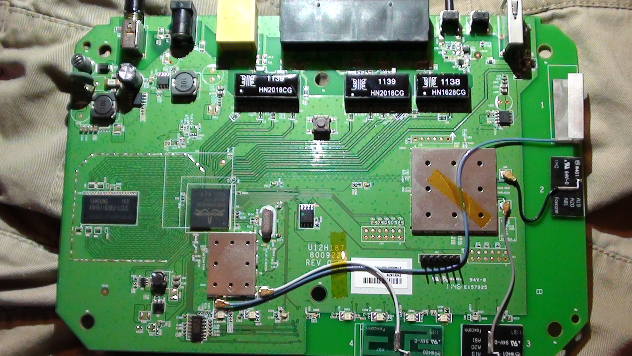

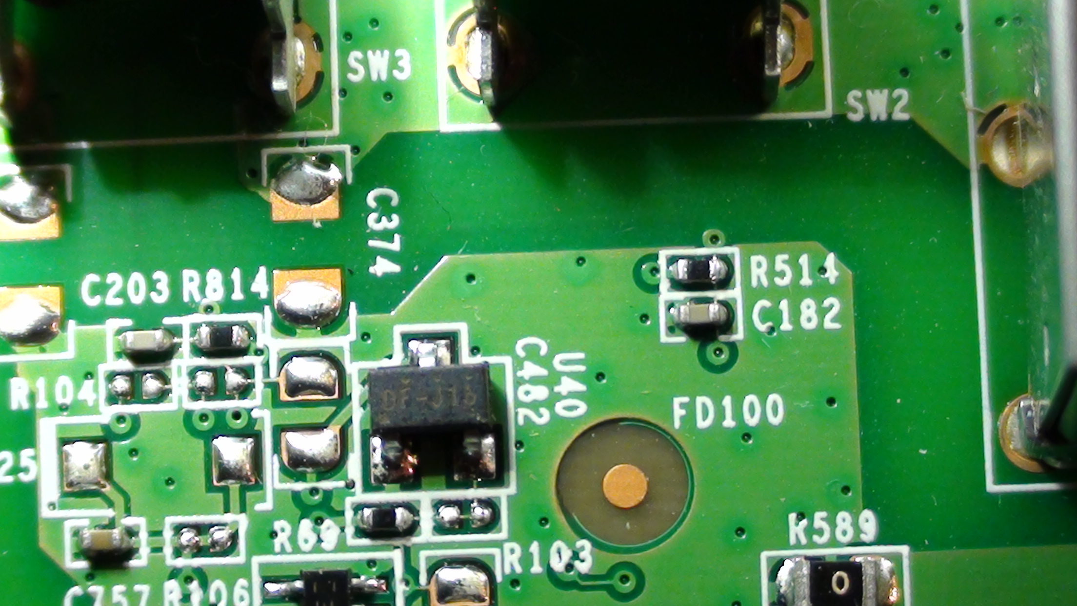

    We have a broken Netgear wndr3400v2 dual-band wireless router. The wifi doesn't work correctly. We can see the wireless networks, however, every time we try to connect via the 2.4GHz bandwidth (for example, using wireless G), we can never access the internet / router. The router sees the device's MAC address but never assigns an IP address. If we try using a static IP address, it doesn't work. Wired works. I believe the 5 GHz band works but haven't checked.
    Anyway, I have taken it apart and identified a component that I think might be bad. It appears kind of burnt, I'm having trouble identifying it though. It's next to the button that allows us to turn the wifi on/off. It's labeled on the board as U40. The device has printed on it, DF-J16. Here's some pictures. The front of the whole board was hard to get a good pic of. I can upload multiple pics in sections of the front if needed.
    Can someone help me identify it please so I can try and find a datasheet for it? I was thinking it might be a BCW68F, package SOT-23 (we measured length and width of the chip and it seems to match the SOT-23 package size measurements).

      Seems to me it is being used as a switch to turn on power to 1138 coil. It is hard to tell being I can see the whole circuit clearly going to this coil. It is partially a guess.
                      Come tomorrow, I'll try to get nicer pictures. I appreciate it. Do you know what kind of component it might be? I was thinking perhaps a transistor of some sort? I couldn't find any service manuals for the router.
                                  I would think in this day and age it is a Cmos transistor. I would think you could check it out with a multi-meter. By connecting one of the meter leads to IC ground and they measure the voltage on the 3 leads, with the button of the wi-fi enabled and then disabled. Then if you look at it as a switch I would think two of the points will connect together while the other enables them when the wi-fi is enabled. This maybe a temporary pulse that triggers a latch. So once the latch is trigger high or low depending one the design the microcontroller or microprocessor reads it and runs a go to routine.
                                        Okay, thank you. Tomorrow I'll give it a shot (I don't have access to the router right now). Thanks!!
