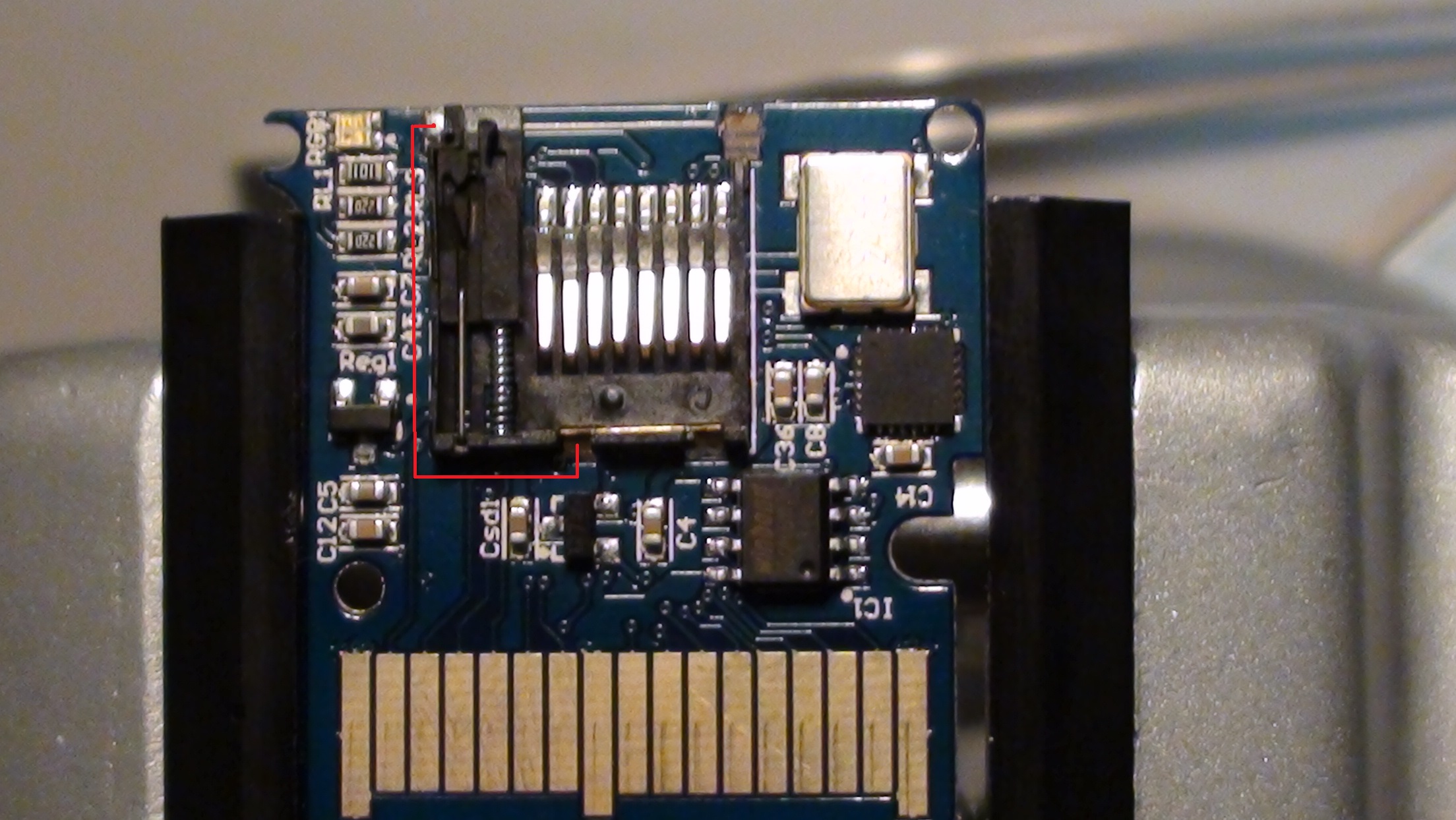

                  I didn't get to work on the router today. I had to fix my brothers Gateway 3DS. The MicroSD card slot has issues. We bought it brand new back in May. It didn't work, we contacted them and told them there was an error, something along the lines of "Error reading filesystem". We sent it back and JUST got it back from China a few days ago. Same issue though. I decided to try and repair it myself this time. I unsoldered the shield to see what was under there (the pins where in the middle, so the shield had to come off first) and low and behold, a broken pad! So I took my conductive pen (which kinda sucks) and used it to try and redraw the pad. I skinned a layer off the board to see the trace and made sure the pen went to it. The instructions for the pen (first time using it) says I have to solder it at no higher of a temp than 350F for no more than 5 seconds. I don't have any solder that melts that low I don't think. So this should be interesting. I have to wait 24 hours for the stuff to cure.

                    I have to solder it at no higher of a temp than 350F for no more than 5 second.
                    Leaded solder should melt around that temperature. Otherwise you would have to get low temperature solder I believe has cadmium added to it. To bad the Chinese Company does not believe in QC departments or even testing the board.

                          Maybe instead of trying to solder the shield back to where I created the pad with the conductive pen, perhaps I should just solder a jumper wire to ground somewheres. What do you guys think? I know this is a little off topic for the router stuff, but I thought perhaps it'd be better than creating a new topic for just a simple question.

                            Yes you can still get leaded solder at radio shack or any electronic parts store. I do not know exactly where you are soldering this jumper wire. If you solder it to a trace you could have problem as they do not make the boards like they use to, where one could scrap the traces on either side of the break and solder a bare wire or a lead of a resistor and then cover it up with lacquer finger nail polish. The traces now are really fragile and are easily lifted from the board. I would think the ground plane would be safe to do this to as long as the jumped wire was not very long.

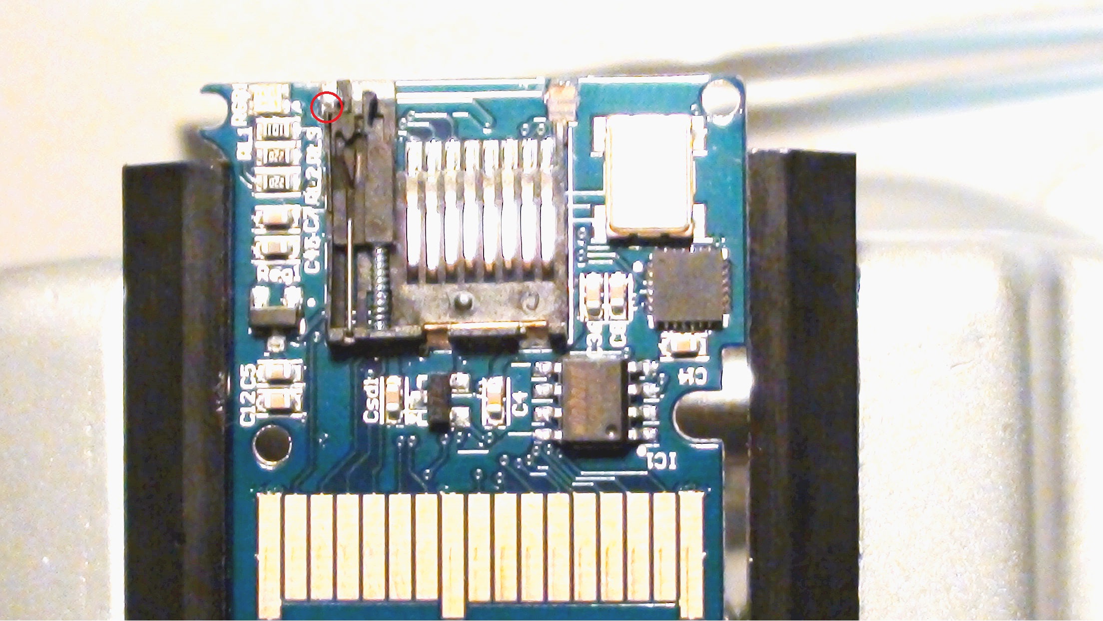

                              Can you see where the missing pad is? It's where the grounding shield was attached. On the opposite side, there's still a pad there. I've successfully scraped the trace to expose the PCB so I can try and solder a wire there...but I'm questioning this...
                              The other side is still a ground. Where does the broken pad lead to? As far as I can tell, it's supposed to connect to the back there (there's two solder pads at the back). They connect to a pin on the opposite side on a big IC, I'm guessing a CPU. So I think all I need to do is solder a wire from the left ground (looking at the pic), to one of the two pads at the back there. Both the back pads are connected.

                                Re: Help identifying a component on a wireless router.
                                You know, something like this.
                                I've checked for continuity between those two points, where the red line begins and where it ends, and there's nothing. My guess is the missing pad connected them. If I'm wrong on this though, it'll probably fry his Gateway.
                                I could try finding on the other side the pin on the big IC that connects to those back pads and finding a datasheet on the big IC to see if it says ground, but there's a LOT!!! of pins there!

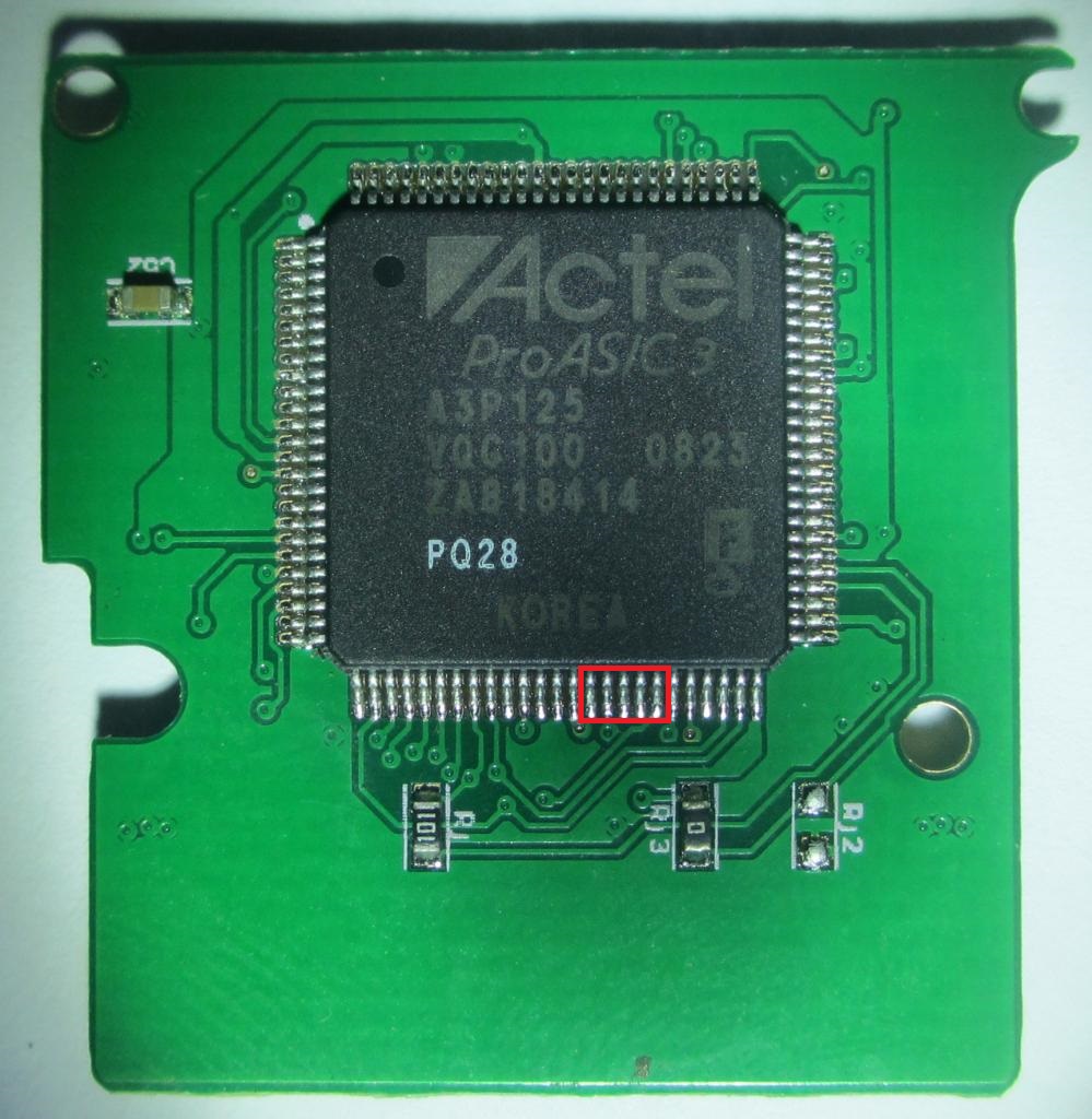

                                Here's a picture of one torn apart. It's not my brothers, but the IC should be the same. The back pads on the front connect to a pin on the bottom of that pic somewheres. More to the bottom left (looking at it) I want to say.

                                  The quality of the picture is not good enough for me to see the broken pad. I guess I would establish the power pins on the chips and the gnd and see what is which. If the pad appears to be going through the board to another pad and that pad is missing. The question becomes did the Chinese Company make a mistake on the art work and then corrected the problem on the board or somehow did the pad get lifted off in assembly and needs to be corrected? So, yes understanding the pin out of the large chip would be worth investigating. Once you know that you can just ohm out the voltage pins and gnd to verify they exist.

                                    I had to readjust your photo. I have circled the broken pad that I think you are talking about. If this is the correct I then would say yes that pad was intended to go through the board. Again if this is the right place I would say you could lightly scrap the pad on the back side of the board and then put a wire through the hole and solder it to the pad on the back side of the board and solder the other end of the wire to the shield when you attach it. It most likely be better to solder it to the shield first as it will take more heat to do this and after it cools off solder it to the pad on the back side of the board. You can use a bare wire to do this. which will also make it easier to put through the hole in the board.

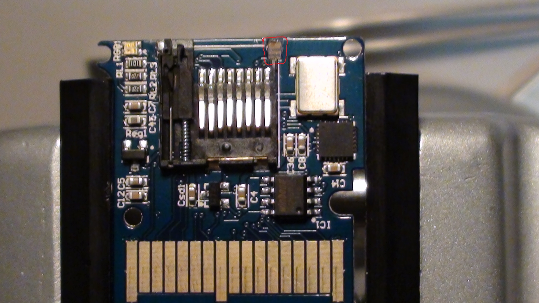

                                      I circled the missing pad. I'm almost certain it's supposed to be there. I heated up the soldering station to melt the solder (I have a Weller WX2 now with a micro-soldering iron attached to it). I only had the iron there for maybe 2 - 3 seconds. I lifted up the shield until it was separate from the pad. Then I went ahead and did the opposite side. When it was all said and done, I removed the shield and my wife noticed the bad wasn't attached. It was floating in the middle somewhere. I think the trace was broke when we got it back, just that the shield was holding it in place.

                                        So how does post 35 come into play? From what I can see the hole going through the board in the upper left hand where I had previously circled is a separate connection from the upper right hand side where you say the pad came off. If you turn the board over and look at the hole going through it, now it will be on the upper right hand side looking at the back side. If you count up on from the lower right hand side of the big IC it goes to 6 pins up from the bottom. It would seem where you say the pad came off it attached the the large gnd plane on the top of the board. It is difficult for me to see because the pad is missing. If you still have the pad you could place it where it came from and see if it does not look like it attaches to the large gnd plane on the top side on the board.

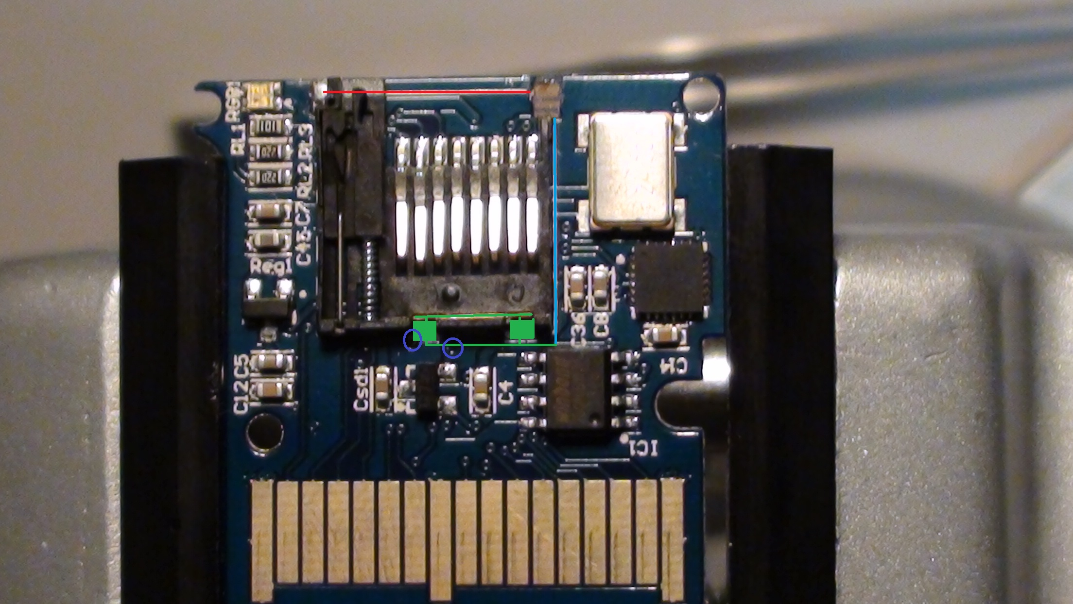

                                          Here, let me try to explain it a bit different with pictures and different coloured lines. Sorry for all the confusion, my mind is a little messed up. Like I think okay, but I don't talk like I think for some reason.
                                          In the first pic here, I know for certain the missing pad goes where the red line goes. However, I'm thinking it might also go where the light blue line goes.
                                          I know for certain, there is continuity anywhere the green line / green squares are. I need to know if those green lines are supposed to be grounded. Somehow, they connect to the CPU. There's 0 ohm resistance from those green lines to somewhere where the red square is in the second picture. I think they might make the connection through the little blue circles on the first pic but cannot say for certain.
                                          I was looking at a datasheet for that ASIC and from what I can see via the pinouts, there isn't a ground around there. Perhaps it isn't supposed to be grounded after all? Which makes me wonder if the missing pad on the front is really causing an issue at all or not.
