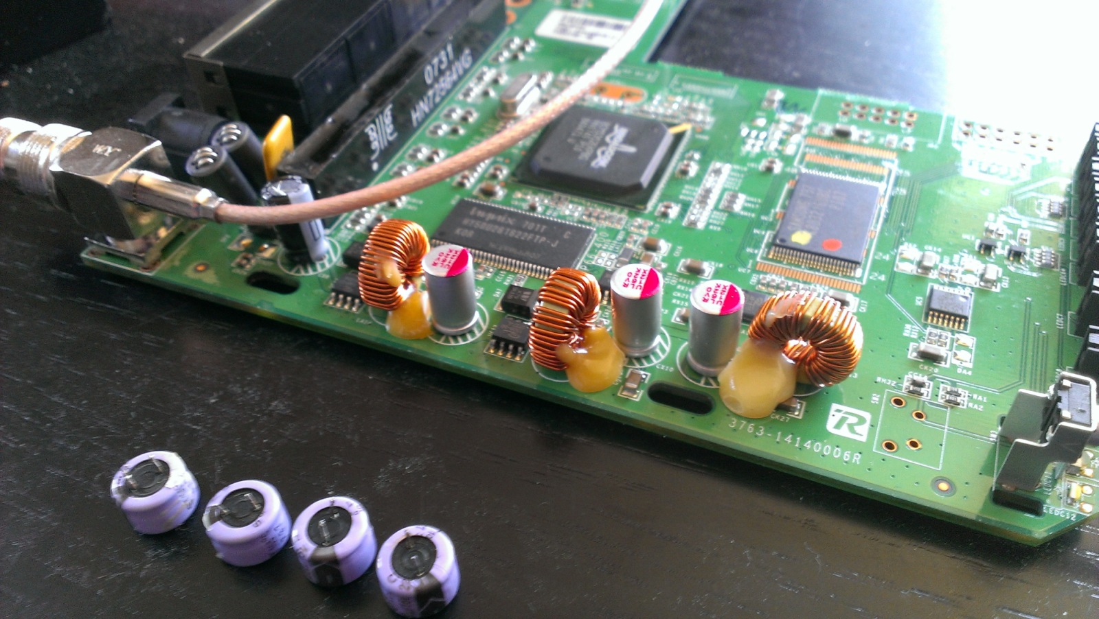

    Friend called me about a non-booting WRT54GL the LED for power in the front was just flashing.
    As I opened it up I found it really hot, there was also a very audible hissing noise from the coils...
    It has 4x CapXon ST 220uF 16v caps, I recapped it with 3x used Samxon ULR 220uF 16v solid polymer caps, and one Rubycon ZLH 220uF 16v for the input.
    This caused the hissing to stop but the router still would not boot.
    Diode DA7 & DA6 become really hot, I was not able to find a schematic though so I gave up.
    The router LED's for Ethernet connections would come on one by one when it was plugged in but without cables connected...
    And with a cable connected the computer never registered a link as up, always showing cable disconnected... (It was like this before the recap too)
    I also tried the "30-30-30" reset but it did nothing at all
    Two of the CapXon's where around 1.X in ESR one had 4.0 but the incoming cap had 50ESR when hot and infinite when cold!
    As he has another router just like this one I opened it up too. (It is working fine).
    It had the exact same caps, and also a little hissing noise from the coils...
    I desoldered the CapXon's: it was the same, only not (yet) as bad.
    The cap for the incoming shows 3.5, rest where around 1.2
    So I moved the caps I had put in the other router to this one, the hissing magically disappeared in this one now
    Funnily I have already recapped this one's AC/DC adapter some months ago, bad caps there too of course!

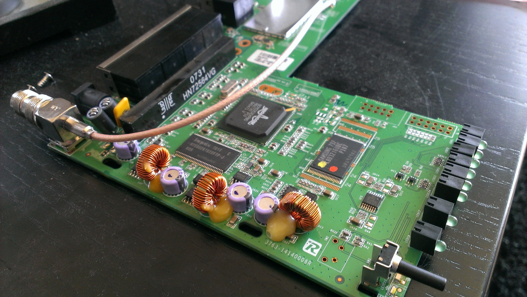

              I had already recapped this router.
              Since the original caps where CapXon ST 220uF 16v I had decided to use something cheap.
              (Instead of poly modding it like in the first post above).
              As the Capxon ST are general purpose caps I had recapped it with UCC KMG 220uF 16v caps.
              But I noticed allot of noise on the incoming bulk capacitor fed from a linear power adapter:
              I swapped the UCC on the input for a lightly used Suncon WX Low ESR 25v 470uF cap:
              -As you can see the difference is quite remarkable:
              All the high-frequency noise that was interposed on the waveform is gone!
              Later I also swapped the rest for Rubycon ZLH 220uF 16v caps.
              At position CX10 (5v) I also noticed allot of ripple, which was reduced to about 1/10:th of what it was before.
              So just because a manufacturer has (cheaped out) and put in GP caps does not mean that is what's best for the device!

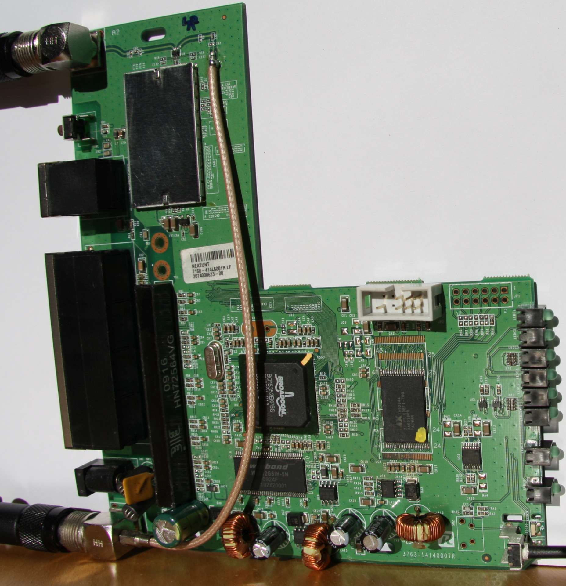

                  Here is an after shot, after as in after recapping the second time and then cleaning the PCB that was absolutely filthy with acetone.

                      Yea the switching frequency is 150KHz for the 5v and 3.3v supplies.
                      Controlled by a AP1509-50 and AP1509-33 respectively
                      The 1.8v supply for the processor runs at 300KHz controlled by a AP1605
                      This picture is from a WRT54GS v1.1 that I recapped yesterday, but they are pretty much identical.
                      On this one I used Rubycon ZLJ 470uF 16v caps, they fit very nicely on the PCB.
                      For input I used a Suncon WX 1000uF 16v cap.
                      I tested a Sanyo SEPC 560uF 4v cap for the processor but it resulted in worse noise.
                      So the switching frequency is too low for ultra low ESR capacitors. (0.007 in this case)
                      I actually did not have a scope when I recapped the WRT54GL in the first post in this thread.
                      Would be interesting to see if the ESR of 0.020 was too low with the Samxon ULR 220uF 16v caps...
                      At least it tolerates the 470uF Rubycon ZLJ caps well, their ESR is 0.075
                      And the 220uF ZLH is no problem at 0.094
