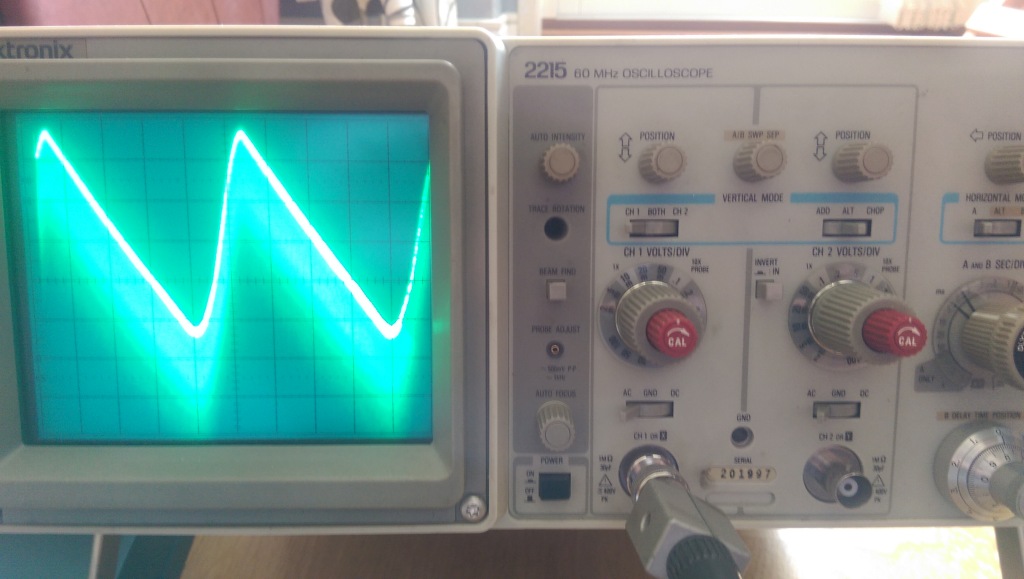

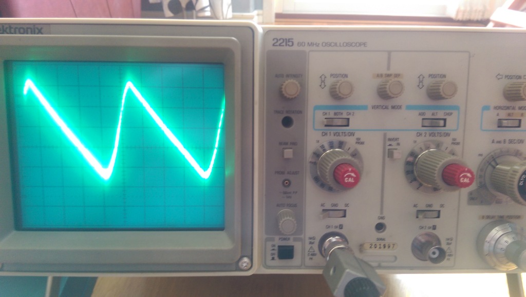

              But I noticed allot of noise on the incoming bulk capacitor fed from a linear power adapter:
              I swapped the UCC on the input for a lightly used Suncon WX Low ESR 25v 470uF cap:
              -As you can see the difference is quite remarkable:
              All the high-frequency noise that was interposed on the waveform is gone!
              Later I also swapped the rest for Rubycon ZLH 220uF 16v caps.
              At position CX10 (5v) I also noticed allot of ripple, which was reduced to about 1/10:th of what it was before.
              So just because a manufacturer has (cheaped out) and put in GP caps does not mean that is what's best for the device!

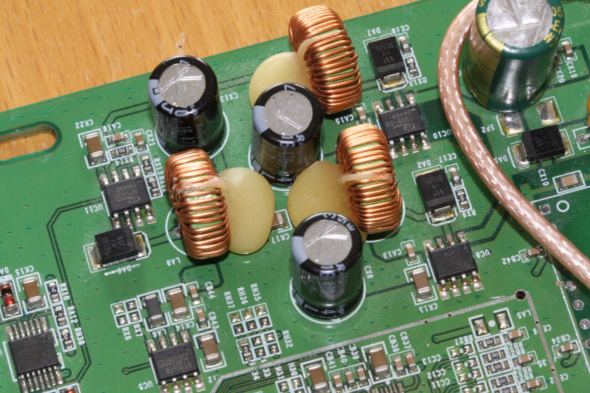

                  Here is an after shot, after as in after recapping the second time and then cleaning the PCB that was absolutely filthy with acetone.

                    Yup. Especially when you are dealing with a buck regulator - in this case, looks like three on the board, going by the number of toroid inductors. Speaking of inductors, looks like those have a fairly large number of turns. That means the buck circuits are probably not running that high of a frequency. So in that case, going up in capacitance may be a good idea. 220 uF is a joke. I would have gone with 470-1000 uF caps for everything, with the outputs getting 6.3V or 10V caps. You can see the board can accommodate up to 8 mm caps. Might as well take advantage of that. Also, 470-1000 uF caps rated for 6.3 or 10V won't cost that much more than 220 uF caps.
                    Awesome save again!
                      Re: Linksys WRT54GL v1.1 bad CapXon caps
                      Yea the switching frequency is 150KHz for the 5v and 3.3v supplies.
                      Controlled by a AP1509-50 and AP1509-33 respectively
                      The 1.8v supply for the processor runs at 300KHz controlled by a AP1605
                      This picture is from a WRT54GS v1.1 that I recapped yesterday, but they are pretty much identical.
                      On this one I used Rubycon ZLJ 470uF 16v caps, they fit very nicely on the PCB.
                      For input I used a Suncon WX 1000uF 16v cap.
                      I tested a Sanyo SEPC 560uF 4v cap for the processor but it resulted in worse noise.
                      So the switching frequency is too low for ultra low ESR capacitors. (0.007 in this case)
                      I actually did not have a scope when I recapped the WRT54GL in the first post in this thread.
                      Would be interesting to see if the ESR of 0.020 was too low with the Samxon ULR 220uF 16v caps...
                      At least it tolerates the 470uF Rubycon ZLJ caps well, their ESR is 0.075
                      And the 220uF ZLH is no problem at 0.094
