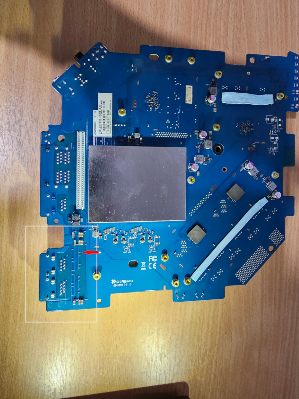

    Hi Everyone, hopefully somebody can help me.

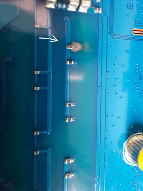

    I have acquired an ASUS ROG Rapture GT-AXE16000 with a faulty 10GE port. It's locked at 100Mbps. A component on the board went pop but I'm not sure what it is. If anybody has a schematic or knows what the component is I'd be extremely grateful.
    I have attached pictures highlighting the thing that went pop.
    Any help is appreciated. Nothing else around it looks damaged and a quick check with my multimeter seems to confirm this. I tried taking one of its brothers off and measuring it but, when I tried to grab it with my tweezers it decided to launch its self into another dimension. So figured I'd ask the experts before I try taking any more off.
    Thanks for your time.

    Going by the colour (which seems to be black) I'm guessing an inductor or probably ferrite bead (or maybe an un-labelled resistor).
    SMD ceramics are usually white or brown.
    A ferrite or resistor will generally only blow up if something else is shorted, thus pulling too much current through it, however.
    -David VanHorn

      Going by the position, resistors. And if they burned, most possibly the ports on the network IC have been damaged also.
      Does it have another port, and that works correctly ?

        If it works on 100Mbps as he mentioned, probably the IC will be fine. That popped resistor means a lost wire pair, so easily can mean 100Mbps. Lets hope that there was just something dodgy on that port and the resistor saved it.
        @OP:Any news? My tip would be to measure the resistors next to it (I bet they all will be 0-10 ohms) So use one that is similar.
