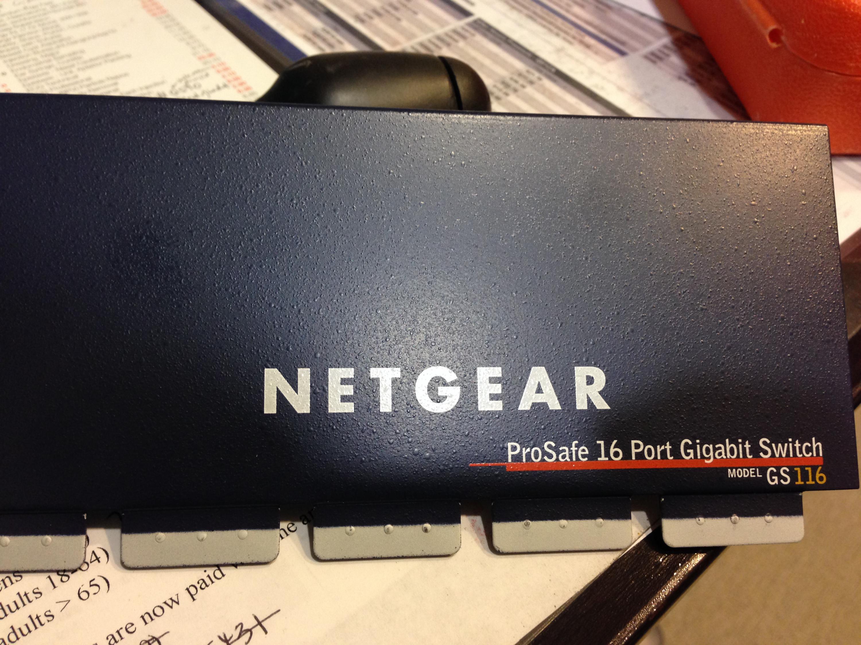

    I know there are internet blogs about the GS108 (8 port version); however no one mentions the 16 port version.
    This is a small business "prosafe" model.
    It is very compact; but gets pretty hot with little circulation.
    After 7 years; the switch would give intermittent connection problems only for some computers on the network (lack of switching)
    also, internet and high bandwidth would crawl along at times. This happened pretty suddenly and was hard to diagnose which is why I wanted to add to the knowledge base.

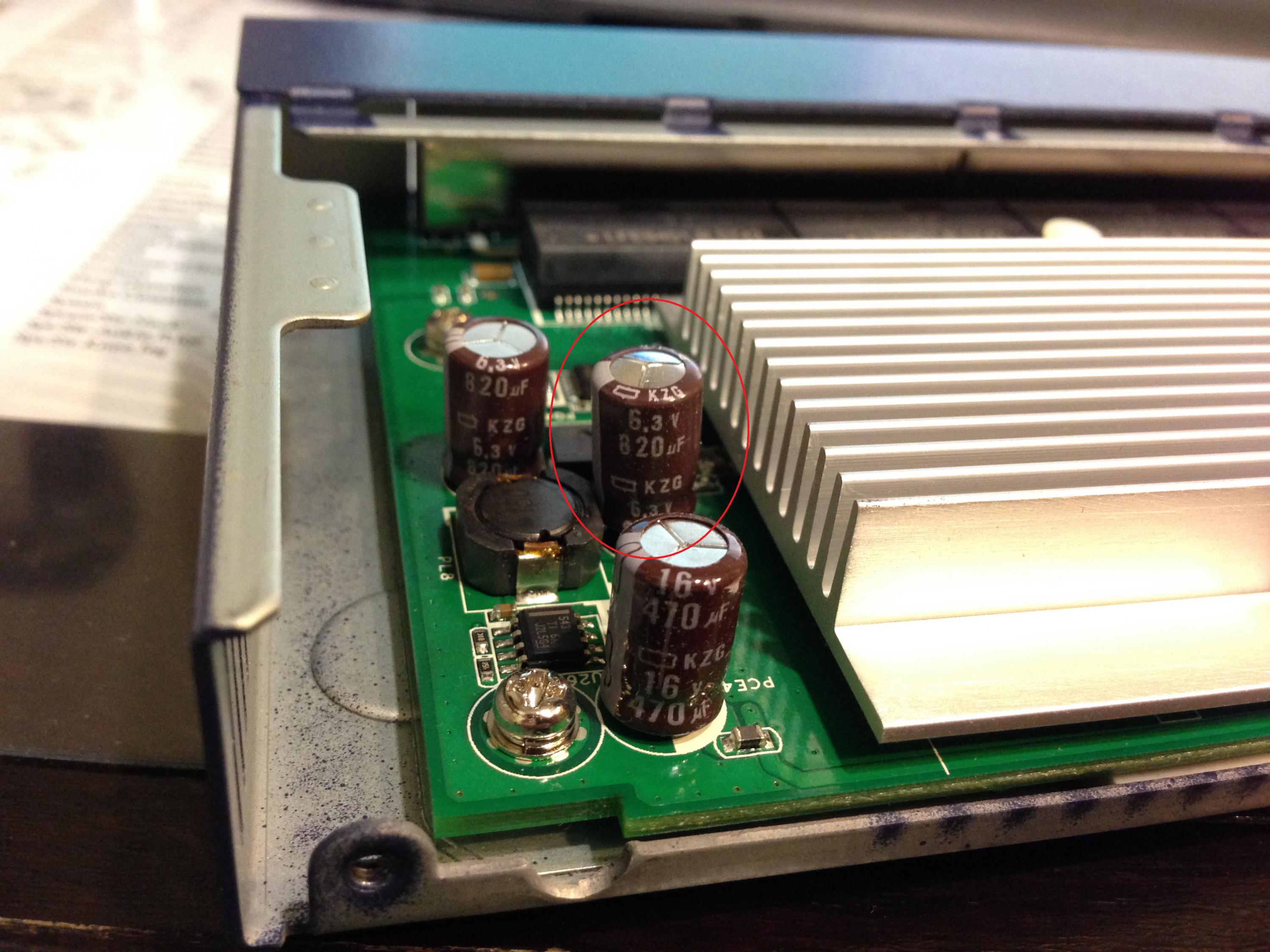

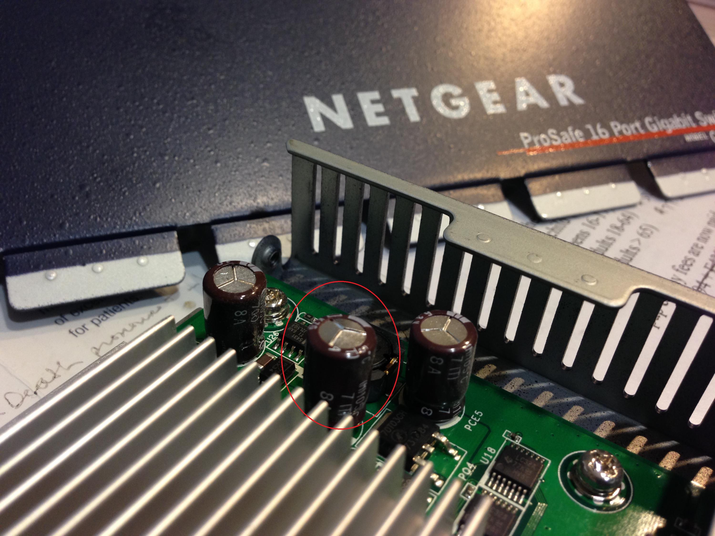

    After disassembly, clearly 1 cap is bulging. However, everything else looked fine.
    Contacted netgear and told them the cap was bulging; got an immediate RMA.
    There is lifetime warranty. In some ways; I should have just recapped myself to save another item going to the landfill.
    HOWEVER, don't have the time these days and also, for a mission critical environment; I would never trust my soldering skills.
    So, off to RMA exchange it goes....

        The deadly thing is that failure is intermittent and inconsistent.
        For example; on my network; the local lan worked but the wan did not. I presume it has something to do with traffic volume issues. Also, only a few of the ports were showing issues (2?) which made it really hard to diagnose the problem.
        I actually went with a cisco switch as a replacement in the meantime. I will get the warranty repair and probably keep that around as a backup switch after inspecting it for bad capacitors of course.

            Chemicon KZG are known to fail in any type of heat situations.
            I'm surprised at the lifetime warranty. Usually, there isn't enough margin in the low end commodity devices to cover warranty claims.
            I suspect companies just hope for the user to upgrade and recycle the old stuff before the device fails.

                Many thanks for posting on this issue kleung. I had no idea they had a lifetime warranty. As soon as I saw your post, I got on netgear chat and had a new one coming to me in less than an hour. The longest bit was finding the newegg receipt. 6 year old and still under warranty! Seeing all the info on heat, mine was in a basement open lan closet, nice and cool for 5 years then it was moved to underneath an office desk. Still open but it was warmer and failed in the next year. I have not torn in down as it is going in for RMA. From what I can see through the sides of the switch it looks like the top of the center cap is swollen just like the one in your picture. Many many thanks for getting me a near free replacement for my 16 port switch. Weird things had been going on in that network segment, and now I know why and can fix them!

                  Have this same switch, Although with one popped cap it would only work somewhat correct on random ports. Changing said cap restored normal operation. Still using it to this day.
