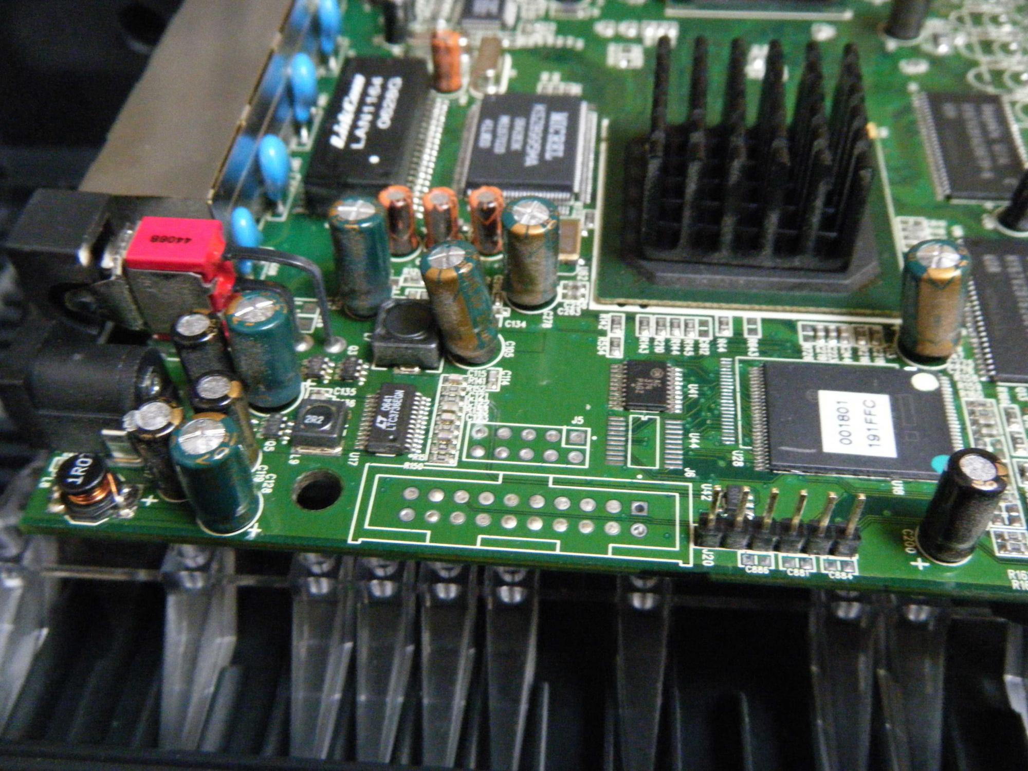

    Our wireless router that has been going good for years just got bad, it would drop connection and crash like once or twice every 30min. Of course, this got annoying, since it takes like almost 5min to boot up.
    I told my parents, and they agreed I could take a look at it. Well, I found 6 bloated/nearly exploded CapXon capacitors inside. They were 2x 330uF 6.3V, and 4x 220uF 10v. The only replacements I had on hand were nichicon VR 470uF 10v caps, although they are 85C rated, I went ahead and replaced the bad caps. Now the router works well again
    None of CrapXon caps vented, but they bulged, and pushed their rubber bung out. Three of them had the rubber bung broken into pieces from the buildup of pressure!
    -Ben
