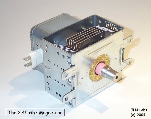

                                If the N access point is in 40Mhz "rape-my-neighbor" mode then
                                solder up a waveguide out of some copper flashing and have a little fun.

                                      Re: Wi-fi is lossy for some but not others
                                      great fun.built several nasty rf "toys" with those.
                                      (looks at a box of 2m172's)
                                      the donor item often has everything you need.
                                      Don't hardboil your eyes.
