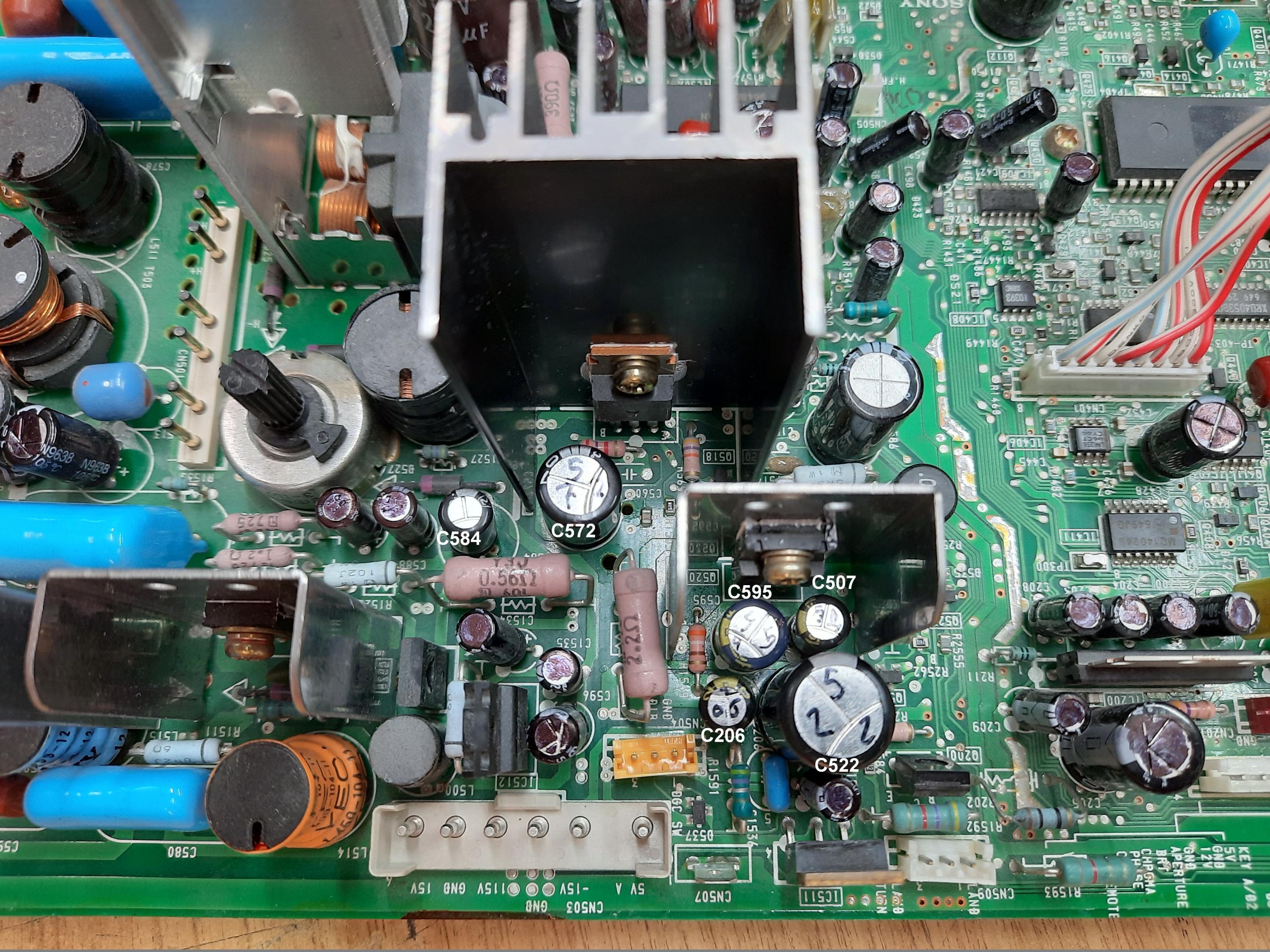

    PVM20M4E Sony monitor geometry adjustment
    Hi all
    Not sure how to access on this set.
    Can anyone help ?

    Re: PVM20M4E Sony monitor geometry adjustment
    The easiest way would be to download the service manual, but you can access the service menu by simultaneously pressing [ENTER} and [DEGAUSS]
      Thanks RJ , now have access to manual.
        Started off by replacing caps known to cause issues on this model (see pics)
        Also discovered a 4.7MF,160V behind LOPTX with high ESR
        Set up geometry best I could, after customers fiddling.
        Enter service mode by first pressing MENU button, then DEGAUSE & ENTER together.
        Once in service mode use MENU & ENTER to move through different adjustments.
        Arrows up & down to alter values.
        DEGAUSE to store. Might need to press it twice.
        Waiting for the retrophile to turn up with his Nintendo WI for the final verdict.
