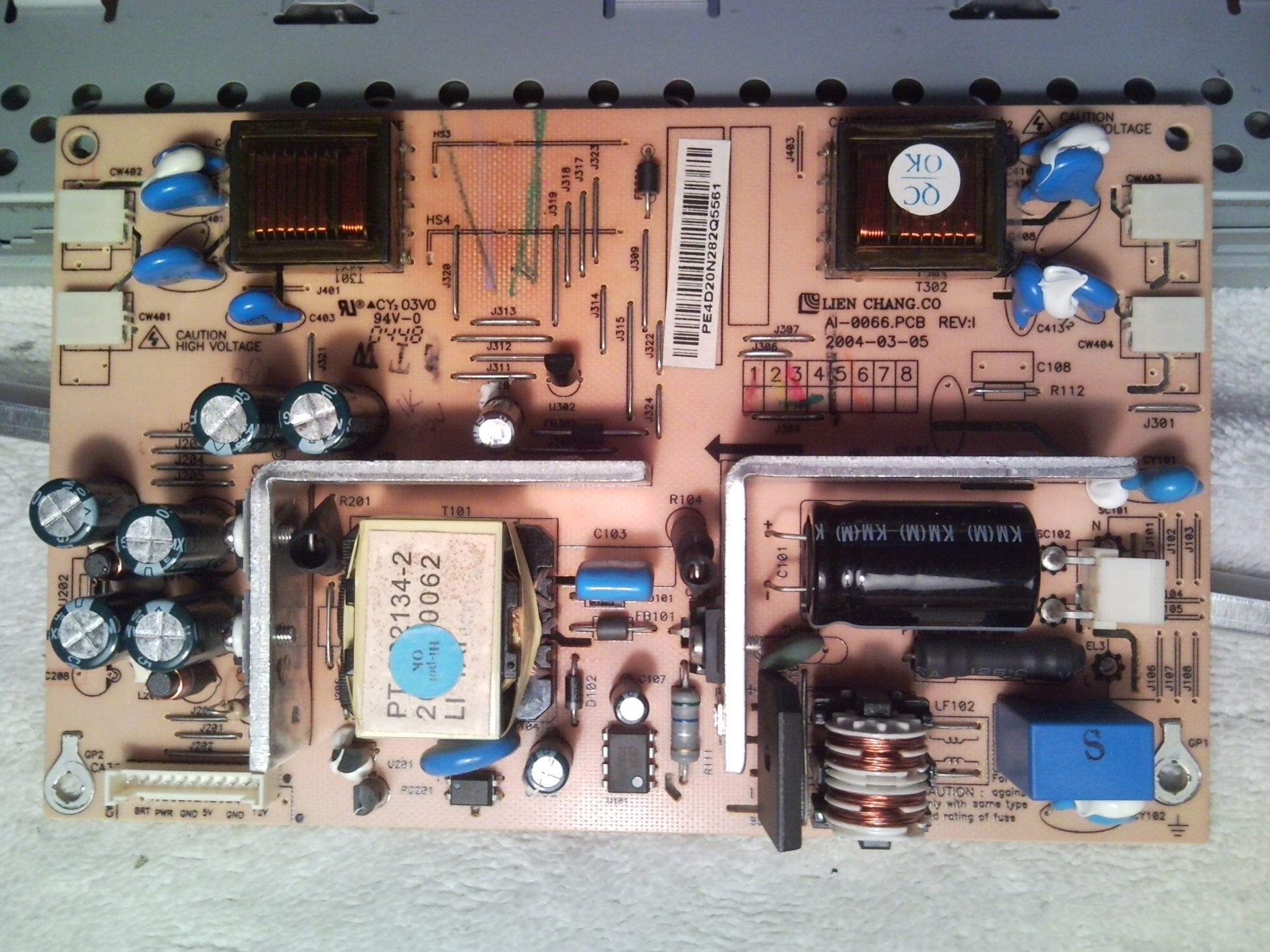

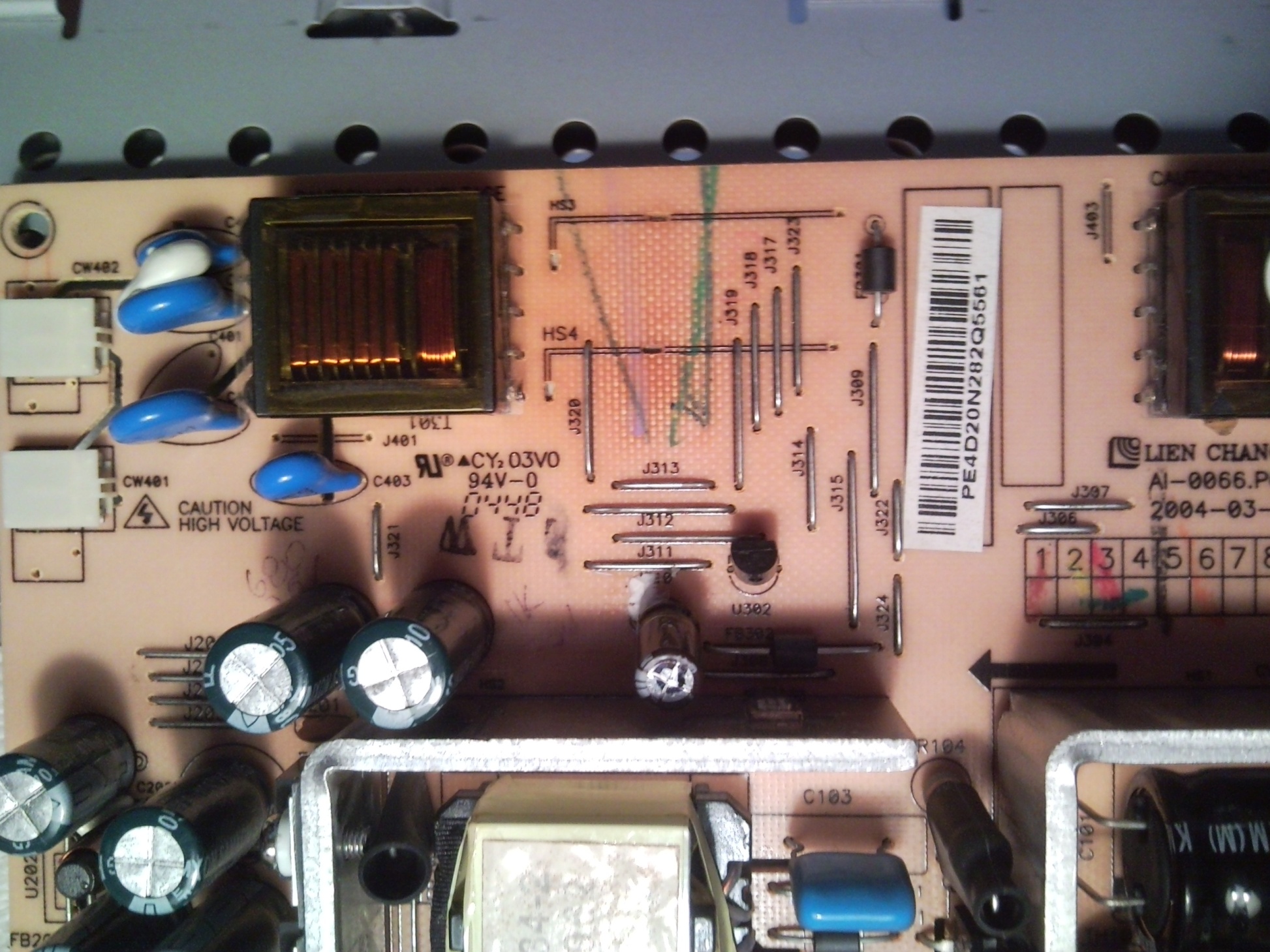

    I got this used, and the first time I plugged it in it worked fine. The next day it was 2 seconds to black, and every time since. The first thing I tried was plugging in some external ccfl's. They came on dim - only about 1/2 the tube lit up, then off. As I replaced caps and resoldered some areas, I got differing results, sometimes the tube would be a little brighter, sometimes dimmer, but always goes off.
    I replaced the smaller cap in the inverter section, C306, 33u, 50v, Nichicon, and c206, 1000u, 16v cap in the bottom left corner. The other caps tested ok, and the ones I replaced weren't too terribly bad on the esr meter. (note: I replaced c206 with a 1000u, 25v - didn't have a 16v handy.)
    On the top of the board between the transformers there is some discoloration, and on the bottom of the board, the components at u303 and u304 look strange, kind of shiny on top. I can't read any identification markings on them. I think it is possibly a mosfet?
    The transformers tested ok with the ring tester, and I resoldered some connections. I don't know where to look next, and don't want to just replace u303 & 4 (assuming I can figure out what they are) if something else needs to be checked.

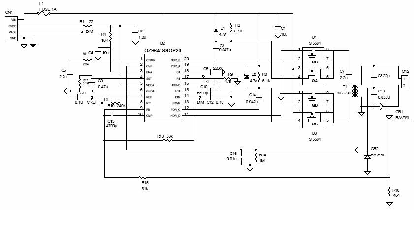

        A common description of a CCFL inverter is 'A constant-current high voltage AC source'. A constant current source will tend to destroy itself if it doesn't have some provision for limiting the output voltage. Also, some provision must be made for the rise in current when the CCFL reaches the end of it's life, especially if there are multiple CCFLs driven by one inverter.
        I've attached the schematic of a typical inverter. Note the circuit running from pin 2 of CN2, through CR1, R16, R15, R13, and to pin 13 of U2. The voltage on that line is proportional to the current through the CCFL. As the voltage on pin 13 rises above the set point, the drive to the transformer decreases, reducing the output voltage. Thus, constant current.
        Next, look at the circuit from pin 1 of CN2, through C8 and C13, CR2, R14 and C16, and to pin 2 of U2. As the voltage out of T1 rises, the voltage at pin 2 of U2 rises. If it rises above a set point, the inverter shuts down and 'latches' - stays off until the control input turns it off, then on again. That protects against a voltage that goes too high.
        Other designs sense the current through the CCFLs and shut down if there isn't enough current through a CCFL. Different design, same reason.
        Many inverters have another circuit in parallel with the current control circuit. If the current through any CCFL rises too high, the inverter shuts down and latches. Sometimes they trigger
        'Two Seconds to black' occurs when the sense circuitry detects a problem - output voltage too high, current through a single CCFL too high. Sometimes this occurs because of a broken CCFL, a broken wire to a CCFL, a CCFL that is dying, etc. And sometimes it occurs because one of the components is defective. For example, if C8 was leaky, the inverter would shut down shortly after the CCFL lit.
        If you look at the back of your inverter, you may be able to see the equivalent of these components. I didn't work with that because it is very difficult to trace green circuit paths on a green circuit board.

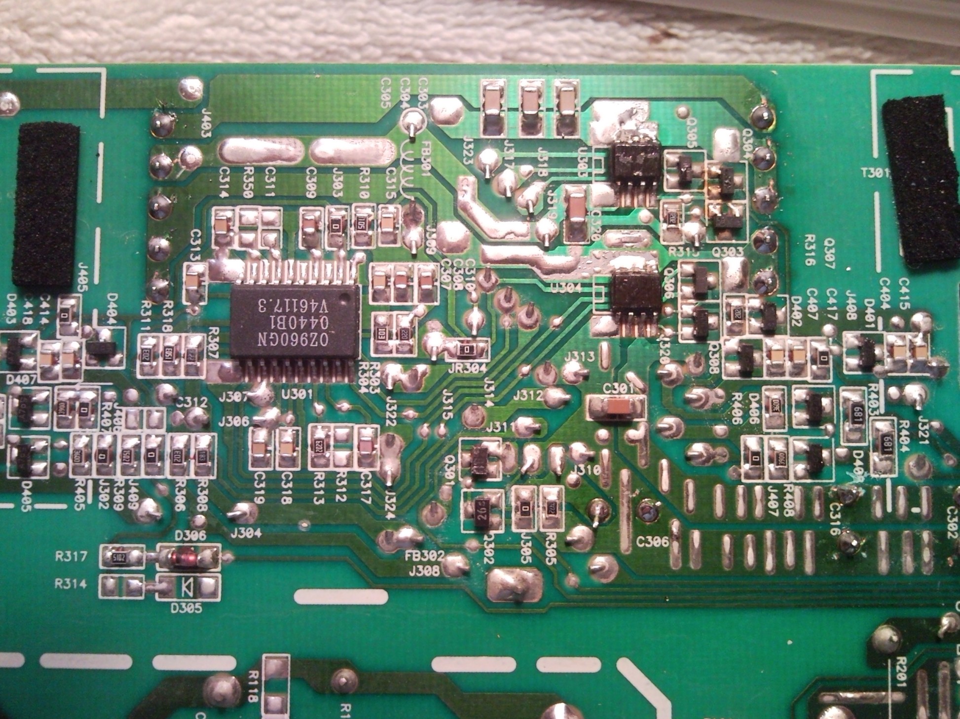

          After checking that out, and not seeing anything visibly wrong, I went back to the area where the discoloration was. I can't keep power to the area long enough to test voltage, but I checked continuity on U303 and U304. From pins 2 to 8 (actually 2 to 5-8 as they are on the same path) sometimes it would charge up to 1. (I mean it would read close to 0, then go up to 1 and stay there.) It would not discharge if I reversed the probes.
          The smd's I am a little unsure of what they are, so don't know what to test. I assume the ones labeled starting with c are caps, d's are diodes, and r's are resistors. But some are labeled jr, q, and some others I forget. Also, the large caps (I think) between the inverter transformer and the ccfl connection - is there a way to test those?

              There is no easy way to check the blue caps, but it's usually not necessary. If they fail it will be obvious by the black color and smoke.
              Here is something to check. If you look at the full-length picture of the bottom, at the right end you will see C403. That is the equivalent of C8 in the schematic above. It goes to C415 and possibly C404. One (or both) of these are the equivalent of C13 in the schematic above.
              Lecture time again. C8 and C13 form a voltage divider. The voltage at the junction of those two caps is .00067 (22/33022) of the voltage at pin 1 of CN2. Since the vast majority of the voltage is already dropped across C8, no significant changes to the behavior of the inverter will occur if a short is placed across C13 EXCEPT that the overvoltage protection is disabled.
              Back to your board. C403 is the equivalent of C8. Other equivalents appear to be C406, C410, and C413. I'm not sure of the other equivalents for C13, but you are smart and can figure it out.
              Double check that one end of C415 is tied to ground. If it is, place a short jumper across C415, then test the inverter. There is one chance in 8 of the CCFLs staying on. If they don't, go to the next C13 equivalent and short across it, leaving the first short in place. Test the inverter again. If you short across all C13 equivalent capacitors and the CCFLs still won't stay on we know the problem is not the OVP. If the inverter stays on after shorting across a particular capacitor you have found a suspect. Now go back and remove the shorts one at a time starting with the one on C415. Test after each short is removed.
              IF the inverter works only if a particular capacitor is shorted, you have identified the sense circuit that is causing the problem. Possible causes would be a bad CCFL, bad wire to the CCFL, bad connector, bad capacitor, or bad diode. The C13 equivalent is the prime suspect, however.

                Sorry, I meant the caps like C401 and C403.
                Who shot JR? I think it was his wife?
                The ccfl's come out of another lcd. I use them for testing.
                I see how you came up with C406/10/13, but does C402 and C403 combine to make the equivalent of C8, or does my board have C8 and C8a?
                If you short across all C13 equivalent capacitors...
                You gave me C404 & C415. I came up with C407 &C417, C414 & C418, and C411 & C419. One side of each of them is ground.
                What is OVP? Over Voltage Protection?
                I will report my findings.
                Thanks.
                    I shorted C415 and BAM - the ccfl's came on bright and stayed on. I couldn't believe I was that lucky, and just to make sure, I removed the jumper and put it onto C404, and the problem re-appeared. And just to really make sure, I put the jumper onto C419 and again 2 sec to black. So the problem is in the C415 circuit. I tested the connector - good, then swapped the ccfl's, and no change. My next thought would be to replace the cap I shorted over, except I have no idea how to figure out what to use to replace it. Any ideas?
                    One other thing, did you see something in the pics, or know something from experience that made you recommend C415 - or just lucky? Thanks.

                      Luck!!! - we don't need no stinking luck!!! I choose C415 because that was the only circuit I could see clearly.
                      It looks like the two capacitors are in parallel. If that is the case there are several possibilities. C415 could be bad; C404 could be bad, or some other component may be bad. If you have a DMM with a capacitance function, check the capacitance of C415 / C404. Compare them to the other capacitance pairs. if all of them read the same, it's time to look elsewhere. The next suspect is C403 - the blue cap. Try swapping it with C406, then see if the problem moves. If it doesn't, D401 is a suspect. And so on. Generally this circuit is rather simple. All of the voltage dividers are 'or-ed' together by D401, etc. Each of them have the capability of pulling the OVP pin high enough to to shut down the inverter.
