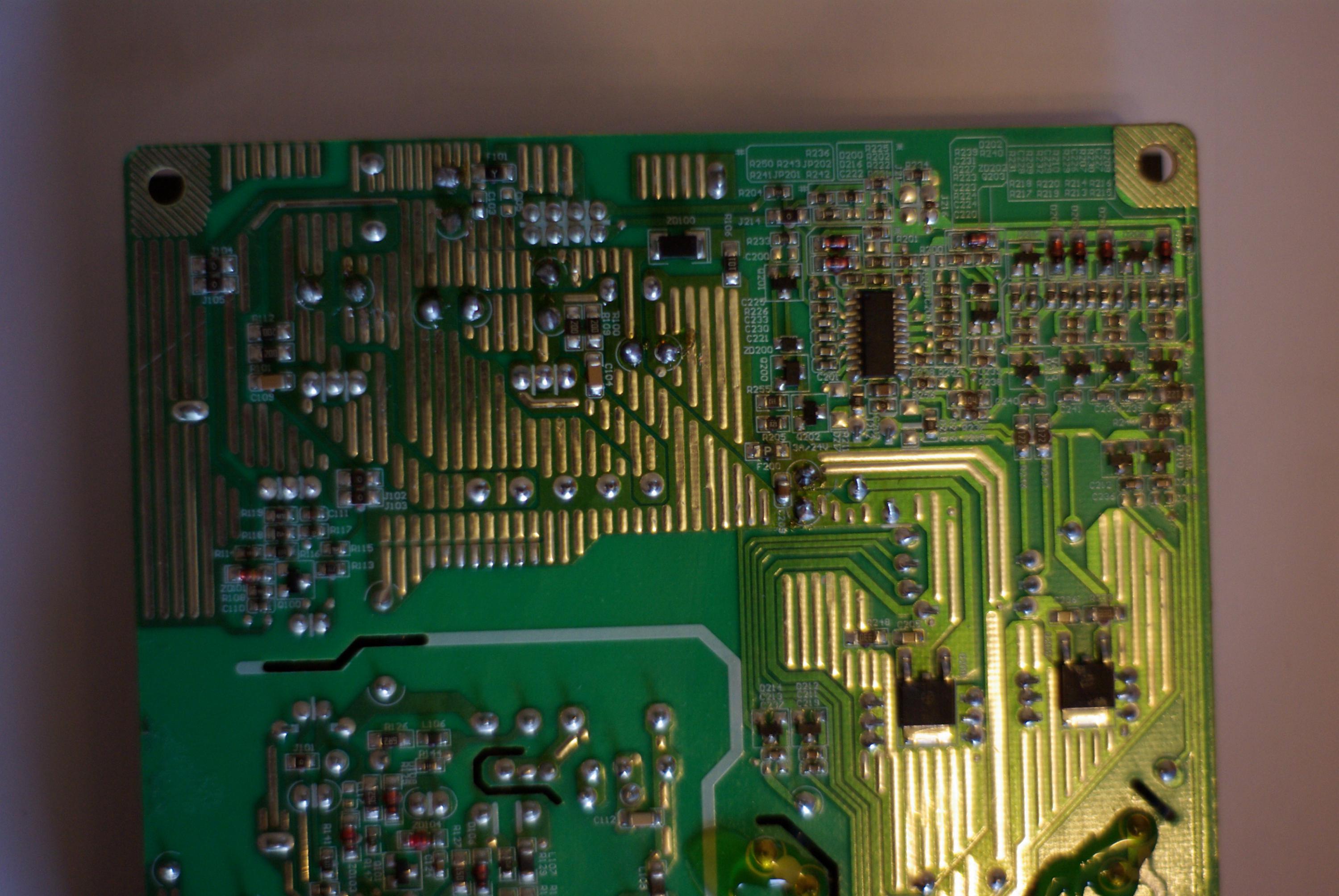

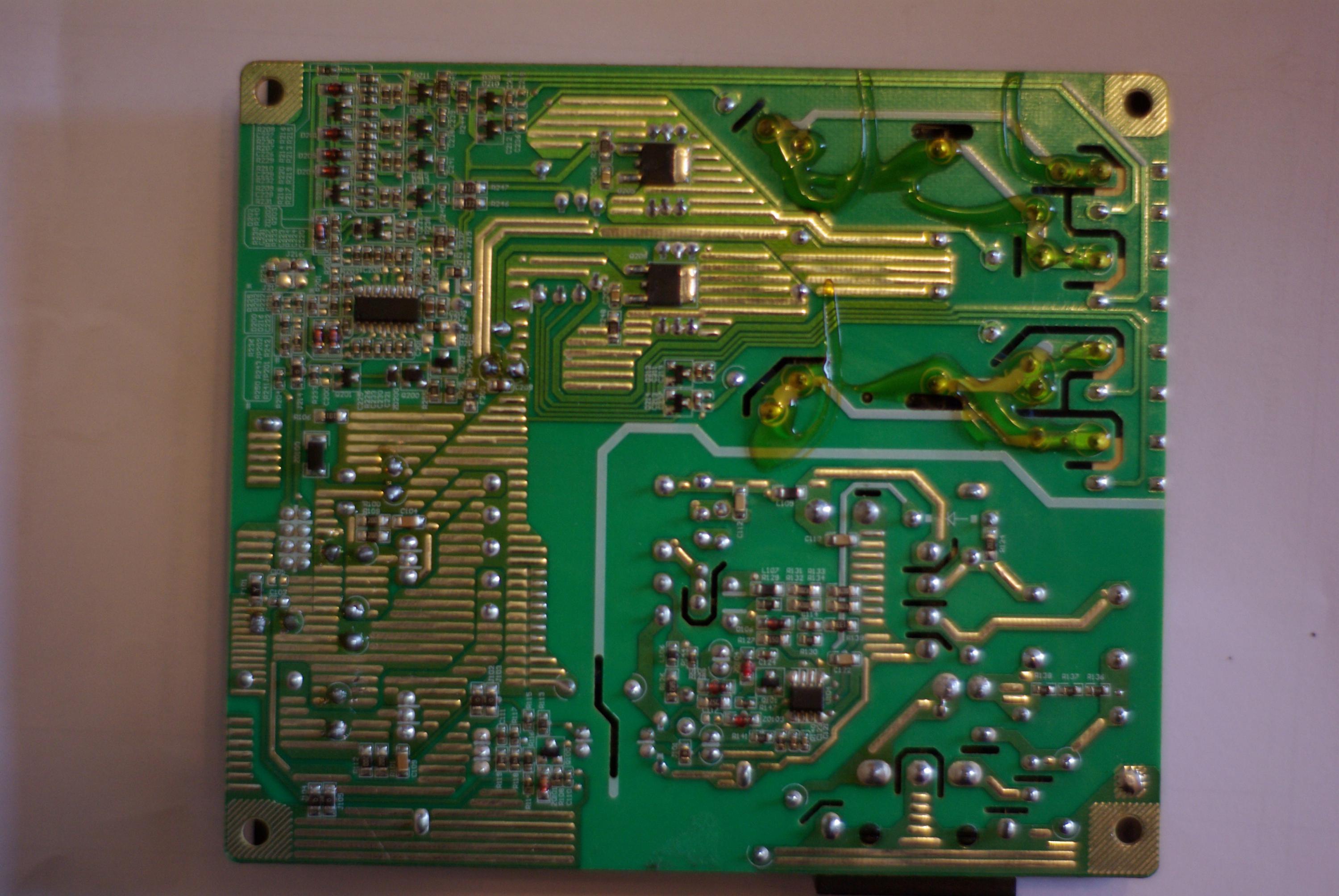

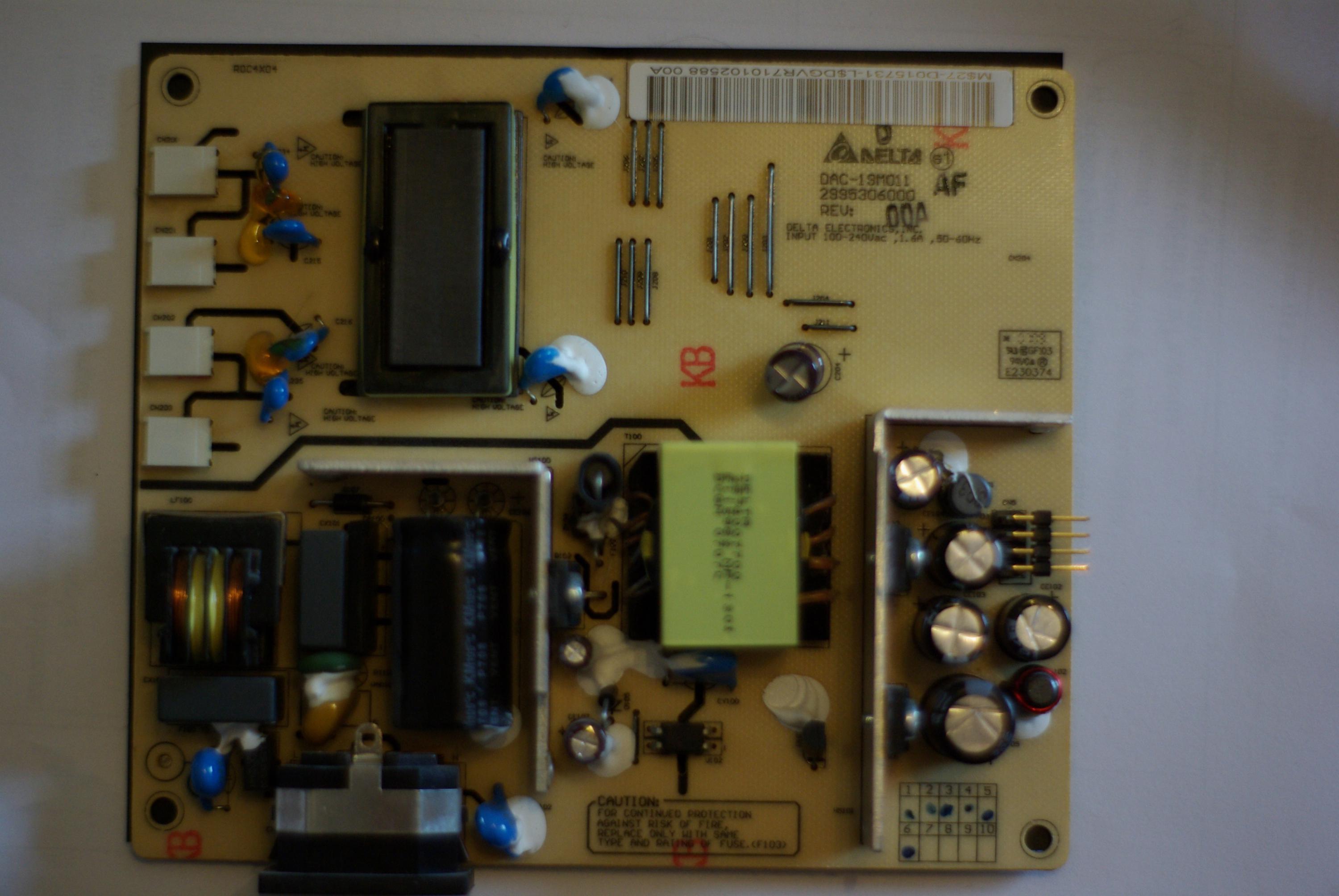

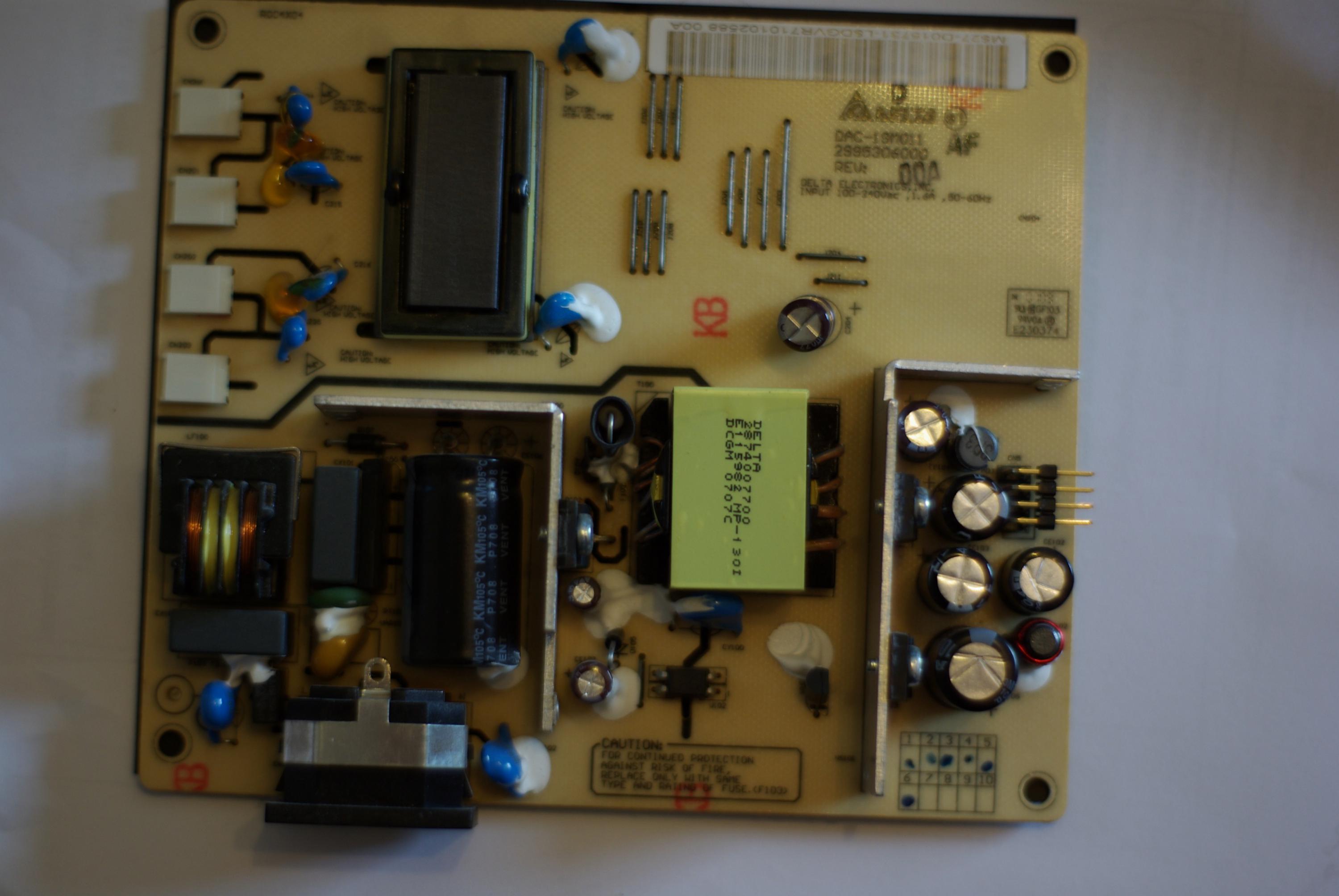

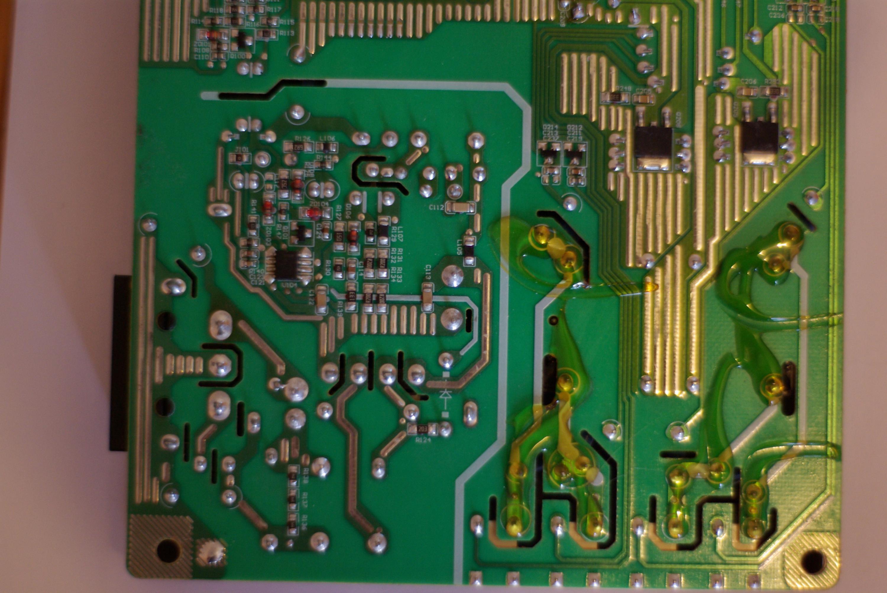

                      Hello, I'm a newbie and I have exactly the same problem, same screen, blue light but no backlight...
                      My fuse F200 P seems to be perfectly working...
                      I had a few bad caps that I replaced, but I still have no backlight.
                      What would you recommend me to test next ?
                      • selldoor
                        Slow Learner
                        • Dec 2010
                        • 7870
                        #31
                        Re: Viewsonic VX2255WMB *New caps still not working*
                        Can you post good clear pictures of your board/s - Use manage attachments
                        JPgs less than 2mb should be good
                        • Peter Horse
                          • Aug 2014
                          • 2
                          • Belgium
                          #32
                          Thank you a lot for your response and your help. I just noticed it today.
                          Meanwhile, I ordered this to test the backlight :
                          http://www.befr.ebay.be/itm/200987005288
                          But I did not yet received it.
                          Here are the pictures of the board you asked for, I hope it's gonna be Ok!
