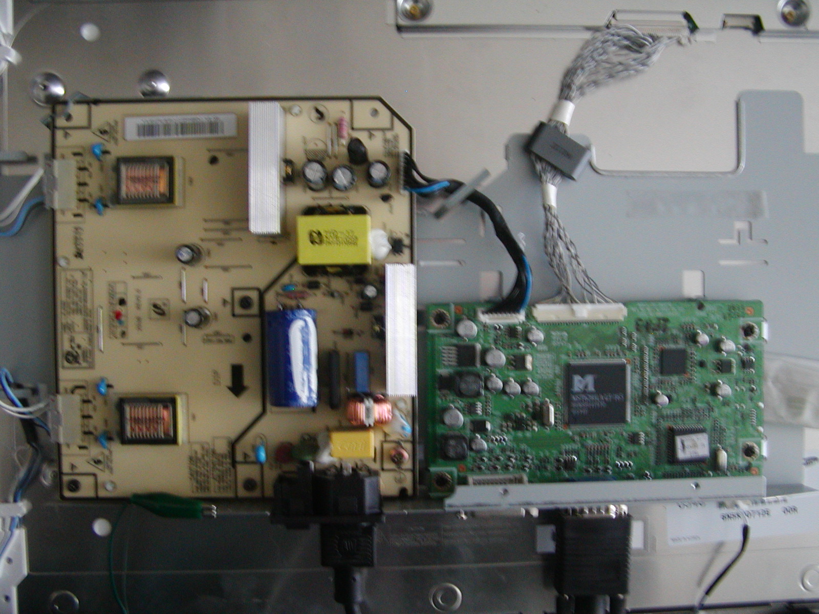

      You've got a problem on the signal card. The pictures supplied in post #1 aren't good enough to provide much troubleshooting assistance. I can identify a voltage regulator, but not much else.
      I would suggest you take a good, clear picture of the signal card and attach it to your next post using 'Manage Attachments' (below the text entry area). We're looking for something like 2000 x 2000 pixel resolution.
      PlainBill

                Re: Samsung SyncMaster 204b
                I'm able to connect all components while monitor is disassembled. I've followed the above directions.
                LED lights blue for one second then turns off. CCFL's don't light up, not even momentarily.
                  john98103, we are still waiting for these pics.
                    It's time to direct your attention to the signal card. The power LED turning off is definitely unusual. A good picture of YOUR card would be very helpful.
                    PlainBill

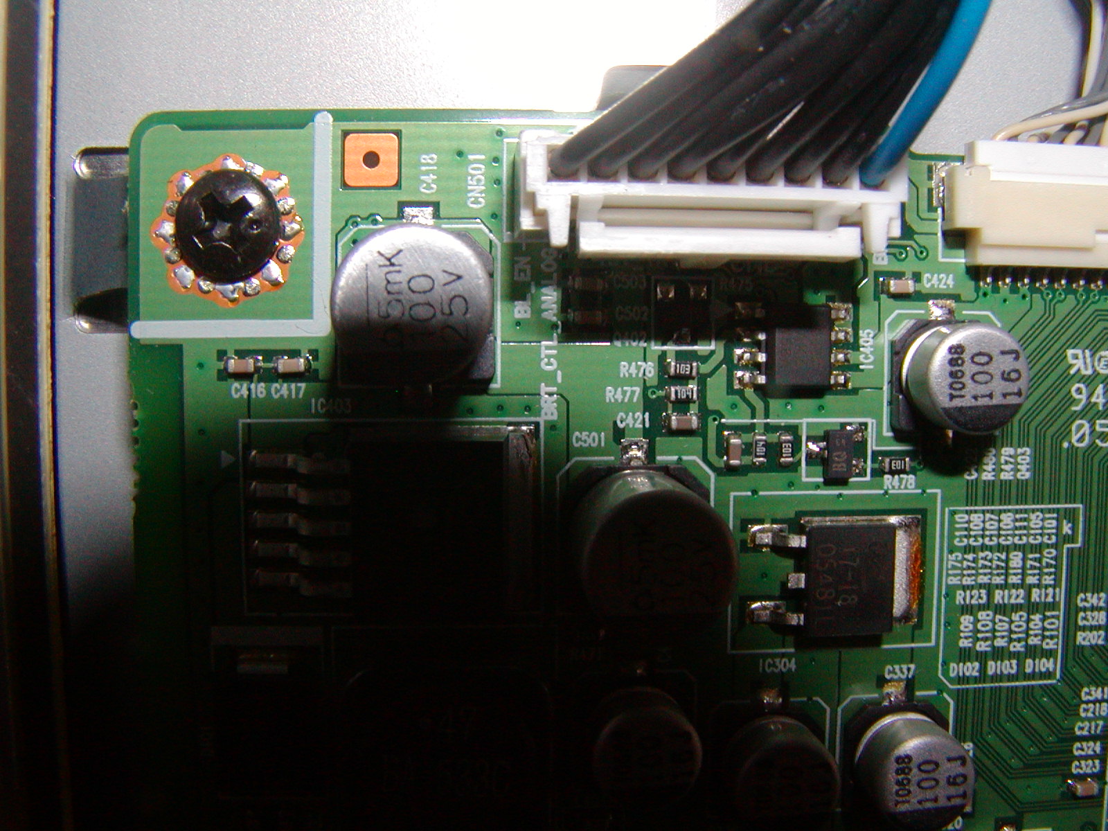

                      Boards for SyncMaster 204b
                      Power Supply IP-45130A
                      Video Board BN41-00620E
                        #31
                        Good pictures, thanks. In the upper left corner of the signal card is an IC marked 1501-33. The is a voltage regulator. Pin 1 has a triangle next to it, pin 3 and the tab are both ground. What are the voltages on the other pins (try to get measurements with both power LED on and after the power LED turns off.
                        PlainBill
                          #32
                          first of all; thanks for all the help.
                          there is an IC just below CN501 (ribbon from CN2) marked IC405 (9933B / W58A). is this the IC I should get voltages from?
                            #33
                            PlainBill wants the voltages from the yellow circled component.

                                That voltage is essentially correct - it's a 3.3 volt regulator. I've identified a few more ICs on the picture (attached). What are their part numbers?
                                PlainBill

                                  On the left of board, top down:
                                  IC405 9933B / W58A
                                  IC304 17-16 / 05481L (very hard to see)
                                  IC203 MP1583DN / 57975819 / MPS541
                                  On the right side of board, left to right:
                                  IC301 LF25 / 6K1DT546
                                  IC604 CCRB / LM / 393M
                                  also
                                  I've had the power off to the monitor for 6 hours. I get no momentary blue led light any more when first switching on.
                                    #37
                                    IC405 9933B / W58A
                                    also
                                    IC405 9933B is a SI9938BDY dual P-channel mosfet.
                                    IC304 17-16 / 05481L (very hard to see) No match
                                    IC203 MP1583DN / 57975819 / MPS541 No match
                                    IC301 LF25 / 6K1DT546 is a LF25 2.5 volt regulator
                                    IC604 CCRB / LM / 393M is a LM393M dual comparator
                                    Well, I'd hoped to do better. 3 parts out of 5 ID'd, only one of the three is of interest.
                                    On IC301, the tab and the stub pin are Gnd. What are the voltages on the other two pins?
                                    On IC 304, what are the voltages on each of the pins?
                                    PlainBill
