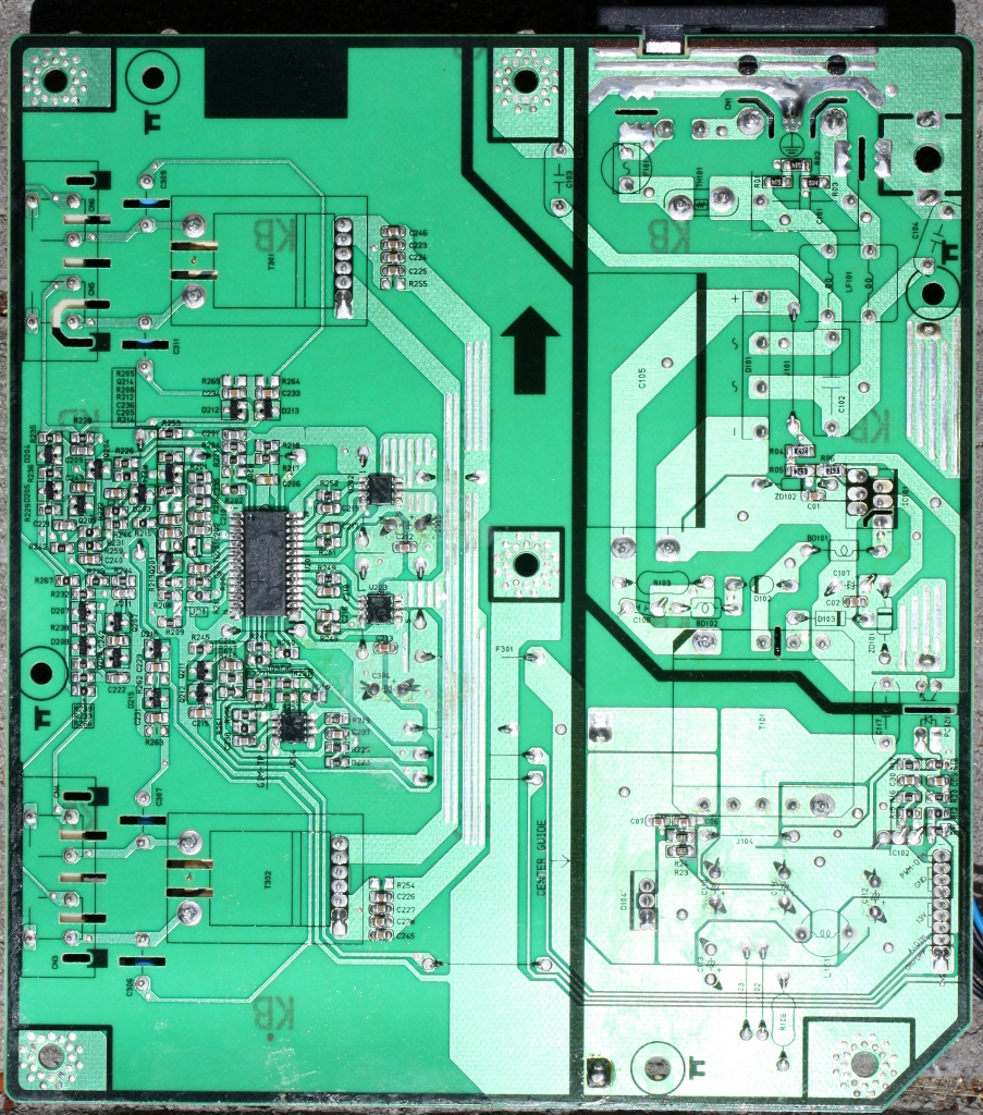

    Recently I was given two broken Samsung monitors; a 204b and a 225bw. I'll talk about the 225bw in this thread.
    The 204b shares the same power/inverter board with the 225bw. The 225bw had 4 obviously bad caps. The 204b had no obvious cap problems. I do not have a cap tester, and since I was already ordering parts for the 225bw I went ahead and re-capped the 204b as well. I replaced C110 and C111 with 820uF 25V United Chemi-con LXY caps (digikey pn 565-1800-ND). I also replaced C112, C304, and C305 with 330uF 25V Panasonic FM caps (digikey pn P12386-ND).
    After the recap the monitor turns on, the backlights power on, but the screen is partially messed up. The top 1/3 of the screen is normal. But the bottom 2/3s of the screen is scrambled and useless. It does not matter which video input is used, even with no video input the "no input" screen is messed up on the bottom. I suspect the video board is the problem, but I don't see anything obviously wrong on the video board. Any suggestions?
    Attached to this post are close-ups of the front and back of both the power/inverter and video boards. I just realized I forgot to take a picture of the screen while the monitor is on. I'll try and get that picture posted soon.

    Great pics. Post the messed up pics as well. In addition, can we also get a shot of the logic board with the cable that attaches to the LCD panel?
    Troubleshooting the logic side is something I'm still learning, but I would check
    1) cable from CN201 to LCD panel is not obviously broken or crimped.
    2) check for continuity using DMM from CN201 to LCD panel to make sure the cable isn't internally broken.
    3) measure voltages at CN201 when monitor is on
    4) examine CN201 traces back to main MST6281LA chip to ensure there is continuity using DMM
    5) check MST6281LA chip for bad solder joints using magnifying glass
    6) maybe check voltage regulators to ensure they are outputting the proper voltage

        retiredcaps - thanks for the great suggestions. I didn't think to use a multimeter to check that cable and traces on the circuit board. I don't have time tonight, but soon I'm going to bust out the multimeter and try that.
        Regarding tests 3 and 6 - I compare voltage while the monitor is running against a grounded part of the monitor, correct?
          You should get 0.3 or 0.4 ohms when tracing out the cable and traces.
          For test 3, pick a ground screw and put your (black) COM there. Put your red probe on the pins at CN201. I'm guessing the first 2 pins will be 5V DC and all the others in the 1.2V DC range?
          For testing the voltage regulators, there are usually 3 pins. One is ground and one is "input" and one is "output". If you look at the markings on the voltage regulators, there should be a part number. Search for the datasheet and that will tell what is ground. Put your black probe on ground and then measure in and output voltage. It should match the datasheet exactly. All the voltage regulators should be measured with DC.
          The other suggestion I have is actually looking at the LCD panel and making sure there are no obvious burn/bad connections.
          I'm having a hard time visually seeing the "big picture" with long video boards. Can you put everything (power, logic, inverter, cables) laid out into one picture? That way, I can see what connects to what and where. A top down view. The details aren't important in this picture, I just want to see the whole thing.
