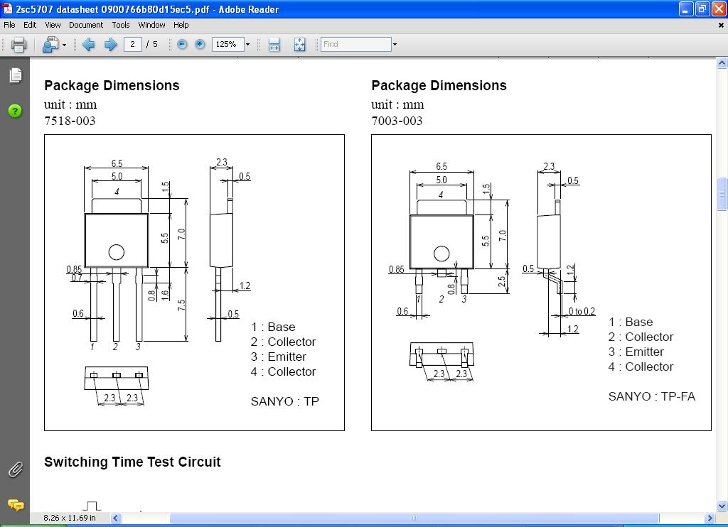

      Hi Mr Plain Bill... .. for the record, i am one of your fan... .. have been following ur posts silently all the while.. i am honoured to receive a congratulation from you..
      what can i say,.. you are SPOT-ON.. i did not notice any physical defect on Q212, because it was facing the big blue caps,.. but since you mentioned it, i did a close-up look again & the black top part is *CRATERED/BLOWN*.. i de-soldered them & it was measuring open on all pins but still inverter transformer (PT202) pins 1-7 shorted.. removed the other Q211, and PT202 pins 1-7, is NO longer shorted... .. measured Q211 B-E is shorted, which is what you are trying to tell me, i believe.. ok, now to get the replacemnts, any thoughts on replacing the 2SC5706 with 2SC5707?
      link to 2SC5707> 2sc5707
      for the record, schematic of Viewsonic VX715 can be found here
      > vx715
      From what I understand, the C5707 is an upgrade (probably higher voltage) from the C5706. I have a very limited experience with these monitors, but have heard that the C5707s work perfectly.

              c5707s arrived today.. but., horror upon horror... they are not the through hole type... sigh!.. .. ..
              however, managed to extend the middle lead by soldering the old leads ontop of the new c5707s & re-soldered them onto the board,.. double confirmed using DMM that Pins 1-7 of PT202 are no longer shorted.. yay..
              power-up the baby &... 'ITS ALIVE! ITS A.L.I.V.E.!'.. no more '2 sec to black'.. ..
                I would love to see a picture of the soldering above. Just curious and may need to do something like that in the future.
                  Glad you got the monitor working.
                  oh man!.. should have snap it before closing up..
                  to be honest, it is tricky, a bit of 'touch-n-go' & sure doesnot look pretty...
                  what i did was firstly using a plier, i 'un-bent' pins 1 & 3 of the C5707 (type 7303-003, see attachment).. then i applied some solder to the shorter Pin 2..
                  i then cut a pin from the faulty C5707 & apply some solder on it.. using a tweezer i align it to the shorter pin 2 & quickly heat them-up with the solder to join them together.. quite tedious as u need steady hands to hold the tweezer & the other hand to quickly heat them.. too much solder & it won't fit in the hole.. too less & the extension lead will drop off.. if your alignment is off-set, then the pin will be crooked... sigh!,, took me around 15-30min to successfully manage to get 2 C5707 to fit properly.. the protusion of Pins 1 & 3 out of the holes will also be lesser.. but as for mine, i can see the Pins 1 & 3 tip on the other side, so i assume it should be safe contact... i guess.. Actually, my plan B if this doesnot work, is to use a wire to extend the 'Collector' hole from the board & solder it to the heatsink of the C5707.. because from the datasheet Pin 2 (the shorter pin) & the heatsink (Pin 4) are both 'Collector'.. maybe some other experts here have a better way than what i did..
