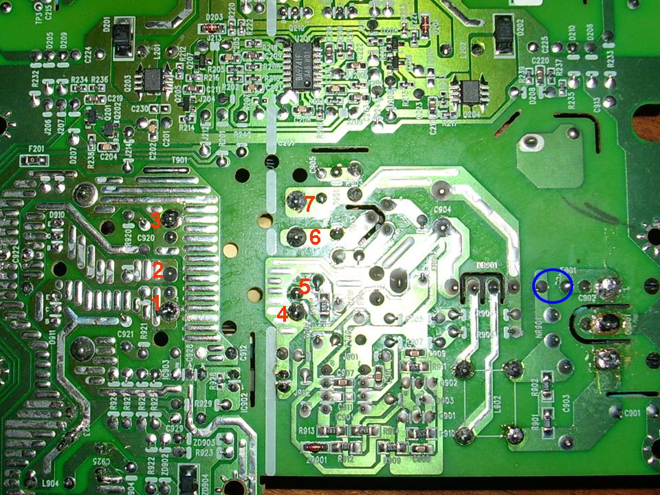

    Got a Viewsonic VX715
    symptom - screen display flashing every 2-3 sec,
    so I changed one of the 1000uF/16v cap (the one lying down) coz it was a little bloated,
    no change, the screen display still flashing every 2-3 sec,
    so decide to leave it there while I enjoy a good game of soccer (World cup 2010),...
    during halftime, I discovered screen display is black.
    Switch off & on again, it now becomes the classic 3 sec to black..
    so I inspected the board again, did some touch-up soldering on some components
    but was surprised to see the other 1000uF/16v cap (the one standing up)
    -ve is facing the heatsink while I saw clearly on the PCB marking printed that it was supposed to be -ve facing outwards.. YIKES!
    desoldered it,.. another surprise comes,
    beneath it there is a marker pen indicating -ve is should be facing the heatsink,..
    confused..
    so decide to follow the PCB marking printed.. power it up..
    then >>>> *POP*.. + acrid smell.. DAMNED!..
    traced to be around the transformer, I think,
    inspected the board again, but can't see any burnt area/component
    1000uF/16v cap (the one standing up) swelled, but display is still 3 sec to black..
    changed the swelled 1000uF/16v cap... THIS time -ve facing inwards.. power it up
    Hope somebody can help me out on my next step/s....
    1)how do I know, did I fried the transformer or any other components?
    2)Where do I need to measure (resistance or voltage) to determine whether to change any other components?
    Any other suggestions are welcome
    i've attached the images of the power board.. apologies if its not good enough.. ignore the pix dates as i have forgotten to set it..
    btw - manage to resize it using this website> http://www.resizeyourimage.com/...
    p/s: this is just the beginning.. currently beneath my bed is cluttered with 3 other faulty panels awaiting my attention.. or they can be great nests for insects to mate & form a colony.. hehe..

    1) Use your dmm and test each component. You can test many components without the power plugged in. Use ohm to look for shorts in transistors and transformers.
    2) I learned by looking at videos on youtube. You can search by entering
    how to measure transistor using dmm
    how to measure transformer using dmm
    how to measure diodes using dmm
    etc
    etc
    The front pic of the board is way out of focus. Take this board to a window on a sunny day and put your camera on macro mode. This will yield nice clearly focused pictures.
    Here is a pic I took next to the window. It is top down and you can see everything clearly.
    https://www.badcaps.net/forum/attach...chmentid=16690

          1) updates
          measured the below (power unplugged)
          *F901 (circled blue) - short
          *transformer - (i labelled them in red in the pix attached)
          shorted > points 1-2, 1-3, 2-3, 4-5, 6-7
          fluctuating resistance (600k) > points 4-6, 5-6, 5-7
          open > all other points
          now i realized i missed F201, and all the transistor (measure C to E, right?)...
          will update when i get back home

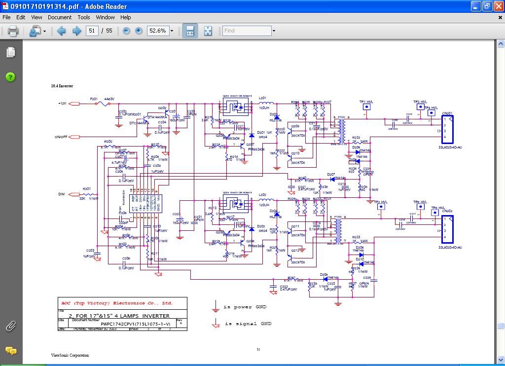

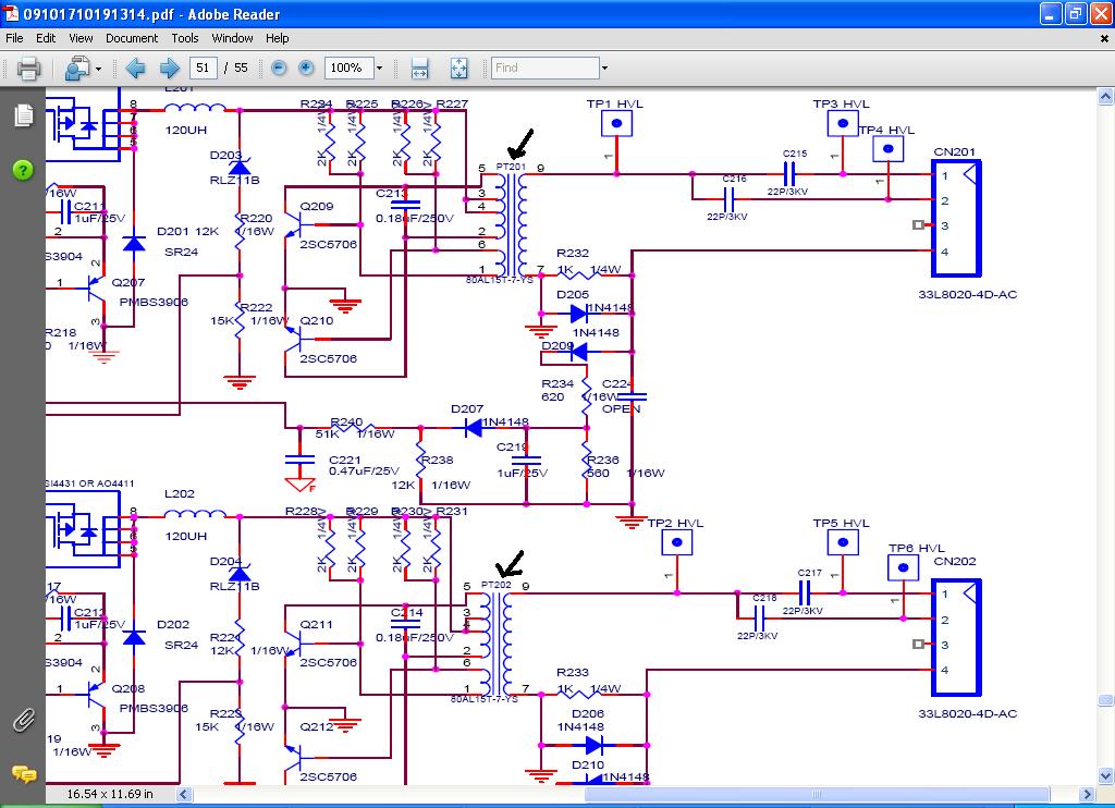

                      updates (sorry it is a long read)
                      * measure for shorted (unplugged)
                      - fuse F201 > shorted
                      - all transistors (C-E) > not shorted
                      - C213 & C214 are shorted on board, but desolder one of them & it measured open.. so i assume they are ok?!
                      read in one of the thread to measure the voltage going into the CCFL, with POWER plugged, when the screen is 'ON' state, just before it goes blank.
                      so decide to build the courage to do so.. GULP!..
                      *measure volt (just before it goes blank) on
                      CON201 (red circle) and CON202 (pink circle)
                      >CON201=2.64V
                      >CON202=3.7mV!!!!!!!! hmmmm..
                      continue tracing the line & saw 2 components (not sure whats its called)
                      linking to them-
                      Q203 to CON201
                      Q204 to CON202 (with less voltage)..
                      so i measured the line before (blue circle) and after (light blue circle) them
                      *measure volt (screen blank)
                      >Q203 (blue) =13V
                      >Q203 (light blue) =0V
                      >Q204 (blue) =13V
                      >Q204 (light blue) =0V
                      *measure volt (when screen ON)
                      >Q203 (blue) =12.1V
                      >Q203 (light blue) =8.5V
                      >Q204 (blue) =12.1V
                      >Q204 (light blue) =12.1V ????
                      marking on them
                      4411
                      BE3424
                      found the datasheet it is AO4411 (FET), no?
                      http://www.aosmd.com/pdfs/datasheet/AO4411.pdf
                      unplug the board,
                      *measure pins 1-8 on both Q203 & Q204, all with same result
                      > pins 4 not shorted to any other pins
                      > pins 1-3 all shorted
                      > pins 5-8 all shorted
                      questions:
                      1) am i right to say only Q204 is faulty?.. since CON201 (Q203 linking to it) is showing 2.64V to the CCFL... or both are faulty?
                      2) any other volt measurements do i need to measure?
                      thing is,
                      firstly am not sure whether i can get the parts locally here (S'pore),
                      saw some on ebay, but not sure its pricey or not with, shipping of course
                      secondly de-solder & soldering the parts will be tricky for me, esp there are smd parts near them.. sigh!..
                      any inputs are greatly appreciated..
                      hope u guys have a great weekend,,,

                        Re: Viewsonic VX715 problem
                        updates
                        * i replaced Q204 with IRF7406PBF & the 2 470uf/16v KME with panasonic fc but with 470uf/25v,, and the result is still 3sec-blank
                        * i unplugged the power & measure resistance D202 shows 242ohms both ways, unsolder D201 and solder it on D202 location and confirmed it is still showing the same result (242ohms both ways).
                        * i continue measuring pin-pin resistance of PT201 vs PT202 using 20k scale
                        (see yellow circles)
                        PT201 PT202
                        Pins 1-8 3.93 0.25
                        Pins 7-8 0.25 0.25
                        Pins 1-7 3.61 0.00
                        the other pins 2-3-4-5 (shorted=0.00) and pins 1-6 (shorted=0.00) are the same on both PT201 and PT202.. would appreciate if anybody could confirm that the readings i took above is showing that PT202 is faulty?.. or isit something else shorted/open?!?!..

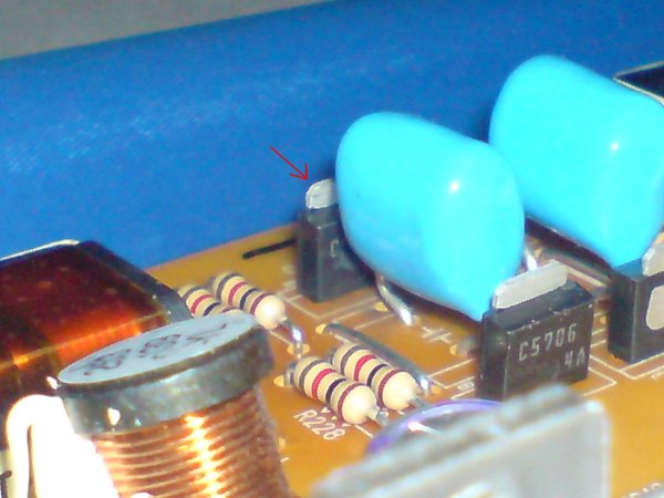

                                First, I have to congratulate you on your persistence. It's refreshing to see someone with limited electronics knowledge who is willing to really WORK at learning about electronics troubleshooting rather than simply giving up. Also, thanks for supplying a schematic. It makes this a LOT easier.
                                Here's a quick lesson in troubleshooting. You found pin 1 and pin 7 of PT201 shorted. Pin 7 is one end of the secondary winding, pin 1 is one end of one of the primary windings. These two winding would normally be well insulated from one another; the secondary produces the high voltage (700-1000 volts) for the CCFLs. Also, the secondary usually has a high resistance - 1K or greater. So, lets assume it's not the transformer or the other end of the secondary.
                                Where does that leave us? Well, where is pin 7 connected? To ground!!! Now, look at pin 1. Where is it connected? To the base of Q209 and to a pair of 2K resistors. It is very rare that resistors short, but how about transistors? Well, they do short out, and what's more, the emitter of Q209 goes to ground.
                                Now, this circuit is very common for anyone who has worked on monitors, particularly Dell monitors. It's called a Royer oscillator. And it's well known because it is quite common to find the two C5706 or C5707 transistors shorted!!! The last little tidbit? A transistor is very tiny. It is difficult to fit the full part number, so manufacturers often skip the first two characters - which are always 2S for bipolar transistors. And the schematic says these are 2SC5706 transistors.
                                So try removing both of them from the board and see if the short from pin 1 to pin 7 of PT201 goes away.
                                Now the other encouraging news. One common cause of these transistors shorting is bad solder joints on the transformers. So it was not caused by anything you did. But you WILL want to resolder the pins on both transformers before trying the monitor.
                                      PlainBill
                                      Hi Mr Plain Bill... .. for the record, i am one of your fan... .. have been following ur posts silently all the while.. i am honoured to receive a congratulation from you..
                                      what can i say,.. you are SPOT-ON.. i did not notice any physical defect on Q212, because it was facing the big blue caps,.. but since you mentioned it, i did a close-up look again & the black top part is *CRATERED/BLOWN*.. i de-soldered them & it was measuring open on all pins but still inverter transformer (PT202) pins 1-7 shorted.. removed the other Q211, and PT202 pins 1-7, is NO longer shorted... .. measured Q211 B-E is shorted, which is what you are trying to tell me, i believe.. ok, now to get the replacemnts, any thoughts on replacing the 2SC5706 with 2SC5707?
                                      link to 2SC5707> 2sc5707
                                      for the record, schematic of Viewsonic VX715 can be found here
                                      > vx715
                                        The c5707s are mainly used on boards made by Benq and they are often shorted. You can see the many posts on this subject. Resoldering the transformers on the benq boards is recommended.
                                        I can't tell from your blurry power/inverter pic in post #1, but does it say Benq anywhere on the board?
                                        I'm fairly sure you can replace the c5706 with a c5707, but I'll let PlainBill confirm.
                                        You can find many sellers on ebay selling the c5707 separately or as a "kit" to fix Benq monitors. The kit usually comprises of 4 c5707s, 3 fu9024, and 1 picofuse 3A/125V.
