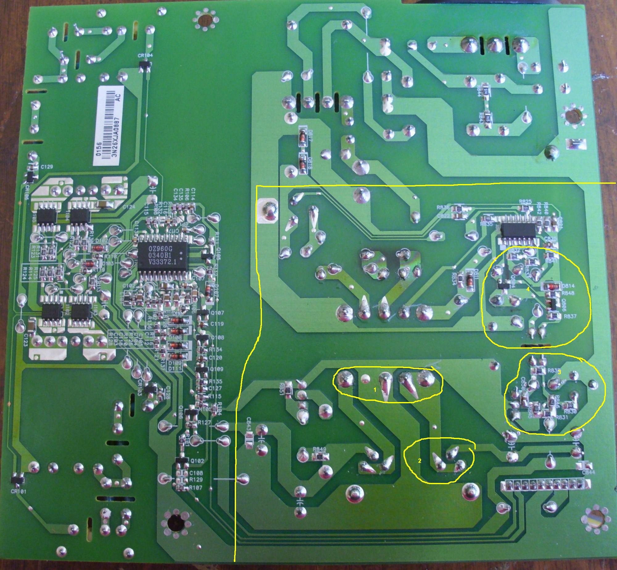

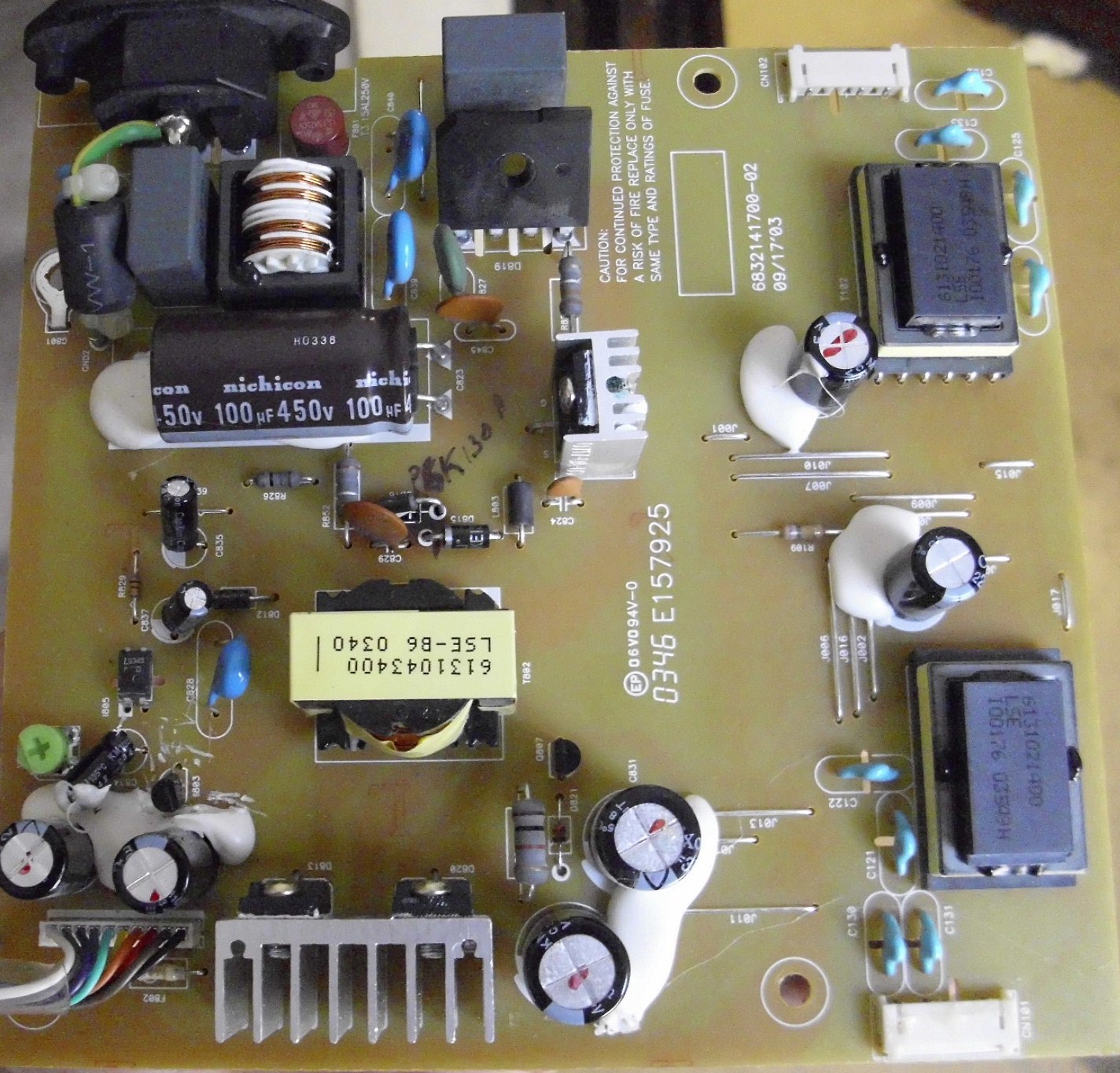

    I have a dell 172fpt.Initaly there was no sign of life.D815 a transient voltage suppressor was in a real bad way, It has been replaced
    .I have 165v across the big cap c823.I also am reading 23v on the 35v 470uf caps in the c831 area.
    I am calling the 5v rail 0v although sometimes I will see about a voltage of 3.5 v to 4v that is very unsteady. Most of the time its 0v
    .On the back of the power supply there is a 14 pin ic #i801 Three numbers are on it #1 Lta201p---#2 4e843343 #3—h603421.
    I have been probing around checking voltages. And one thing I have noticed on pin #4 of L817 optocoupler I see 12v most of the time but sometimes the voltage goes down to 5v and at this time the voltage somewhat comes back to the 5v rail but it is low and unsteady.
    Direction on this would be welcomed.
    Thanks Al.

    Replace C834, C835, and C837.

          Well The test did not work, I tried them.Also this time with power on my 23v rail was down to 20v powering down and hooking up logic board 23v came back.Was the test with the kt valid?I will order some fm series those are just some I had on hand?

              Probably not, it depends on how you hooked it up. An 1157 bulb is a dual filament bulb rated at .6A and 2.1A. If you hooked the two in parallel that would be a total of 2.7A at 12v. If you use only the smaller filament, the power supply should have the capacity of lighting it - at least for a few seconds before it burns out. I would suggest hooking the smaller filament to the 5V output - that's the one that is regulated.
              You mentioned replacing D815. Obviously something BAD happened in that area. R852 also looks like it may have overheated, even though there is no sign of damage to the PC board.

                  R852 has About 156v on both sides.It is red-purple-silver-gold .27ohms?And its reading so close to 0 with my meter.

                    Probably a load sensing resistor.

                                  That kind of change indicates a bad solder joint. I would suggest 'touching up' all the solder joints in the area of the SMPS and the secondary. I've outlined the general area, and numbered some that I consider suspect.
                                  I've been unable to locate a datasheet for the SMPS controller. Have you been able to find one?

                                    Something realy strange is going on here.I have double checked all voltages.Today I am reading 2.5 vto 3.2very unsready on the center leg of d813.And 23v on the center leg of d820.
                                    I am doing my best to ask the correct questions so thanks for staying with me.
                                    You say check the 5v output,Is that going to be on the hot side of the board.
                                    I do not know If it is imporentent or not but on pin 4 of the octocoupler I am reading 10v this is on the hot side of board.
                                    I will touch up solder joints as recomended.
                                    You did ask if I replaced the correct diode that was damaged,I beleave so It was d815 and the markings on it were p6ke130a, and it was replaced with mouser part#
                                    576-p6ke130a.I am not good at adding links yet.
                                    D816 has been removed from board and tests ok.
                                    C829 the brown cap has been replaced with on from annother board
                                    Thank you Al.

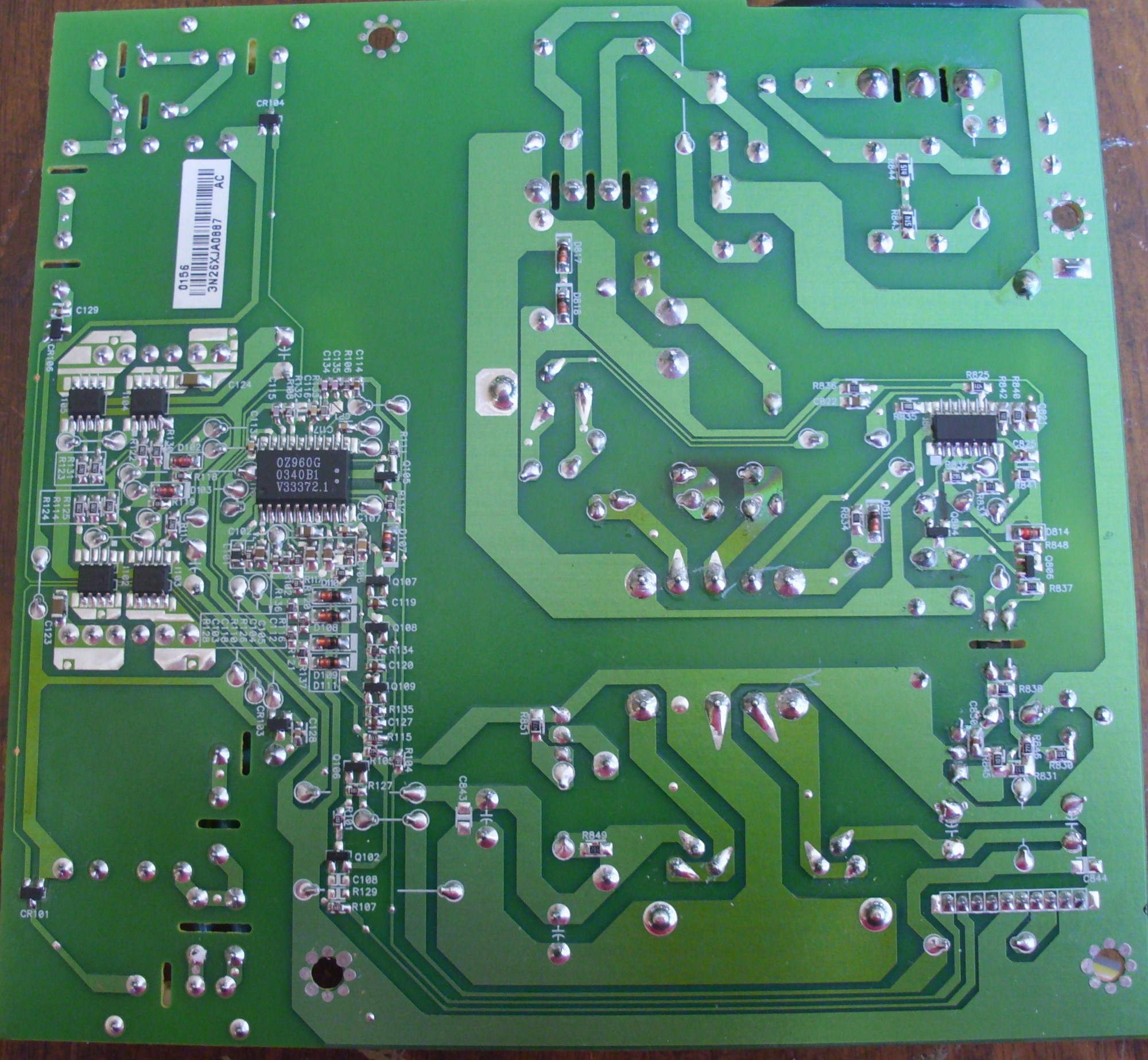

                                      No on the datasheet.
                                      Well Is any body else having trouble opening the attachement?
                                      Or did i do some thing wrong?
                                      Whatever I do, I consider it a success, if in the end I am breathing, seeing, feeling and hearing!
                                      • alexanna
                                        • Mar 2010
                                        • 1346
                                        Re: dell 172fpt 23v but no 5v
                                        PlainBill
                                        I have done a bunch of resoldering.But I am unable to open any atatchments to see your suspect ones.May be tommrow?
