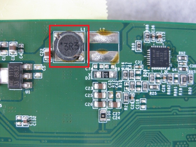

    This is on a Viewsonic VX2235WM. The circuit board is attached to the LCD screen at the top. I'm trying to ID what it is, and what it does.
    Any direction as to where I can get one would also be GREATLY appreciated!

    L = inductor. You can likely get it from digikey.com, mouser.com.
    I don't know enough about inductors to know exactly what you need though. Perhaps someone else can recommend the exact part number?

      As retiredcaps said, it's an inductor. It's part of the power supply (a boost regulator). They are a very low failure rate item, why do you believe you need a new one?

        You can ohm that (with a multimeter) to make sure it is not open circuit.
        Otherwise, it is raely a problem (at least from your picture it does not seem to have anything unusual about it).
