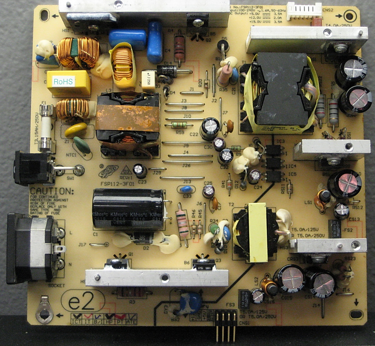

    Hey all... My Acer AL2423W (24" LCD monitor) died on me. No LED, no power, nothing. Completely lifeless.
    Googled the issue, and learned it has cheap caps in it, so I recapped the entire secondary side with Nichicons. The caps looked fine, sans two 100uF'ers that had spit the bottom plug out (lead end).
    Still dead.
    I took the PSU to a local TV repair joint... They were not interested in diagnosing it. They just want to replace. Are there no more real old school local corner electronics technicians anymore? Just parts swappers?
    A month of fighting this thing and now I've taken it as a personal mission to fix it. It's a sweet monitor and I simply don't want to throw it away. I've even replaced it already with a Samsung 2333hd but I still want my old monitor back.
    So let me know what else to check on this one. I really want to fix it to bring this monitor back to life and sell off the Samsung.
    Already checked the fuse, the power cord, and switch. Verified there is 120VAC in the board after these components. All the diodes seem okay, as well as the resistors altho I did check everything in-circuit and surely didn't check all the SMD components on the greenside.
    Thanks for the help, fellas! I'm new here and I like the get-it-fixed attitude on here as opposed to the usual just-chuck-it guys that keep turning me away.

      I'm presuming you have checked that you are getting a DC voltage reading across the large cap ~ 1.4x the line voltage (measure with care, both leads are hot), and that you have verified that all three fuses are intact.

          Topcat, I will have a look under the ground shield and see if anything pops out at me. Will take pics.
          Pedro, I have not checked voltage at C1 but will and report back. Should be a little over 160 VDC, right?
          The only fuse I checked was the obvious F1 main fuse. Where are the other two?
          Dondrusco, yes I have seen your thread and wish I had your success rate, haha Nice pics and fixes!
          I have not looked much at my video board as the caps look fine on it. Then again, I didn't have any bloaters on my PSU, just 2 pushed out plugs on C13 and C16. Everything else seemed fine. Maybe I need to replace the remaining 5 caps on the primary side? (C22, 23, 25, 30 & 32) They look fine visually.
          Could the video board be causing a no power issue?

            Re: Acer AL2423W: Recapped, Still Dead!
            Hello
            I think THere are 4 fuses
            As you have seen F1
            There is FS3 black box fuse by connector CNS1
            Also FS2 black box fuse by lower H/Sink on right side of board
            As well as red box fuse by connector CNS2
                Quick update...
                All four fuses are good. .3 ohms or less thru each.
                Input voltage of 118VAC gives me 154VDC at C1.
                Did not have time to fire up the soldering iron today to check under the ground shield. Will do that tomorrow.
                What should I look at next?

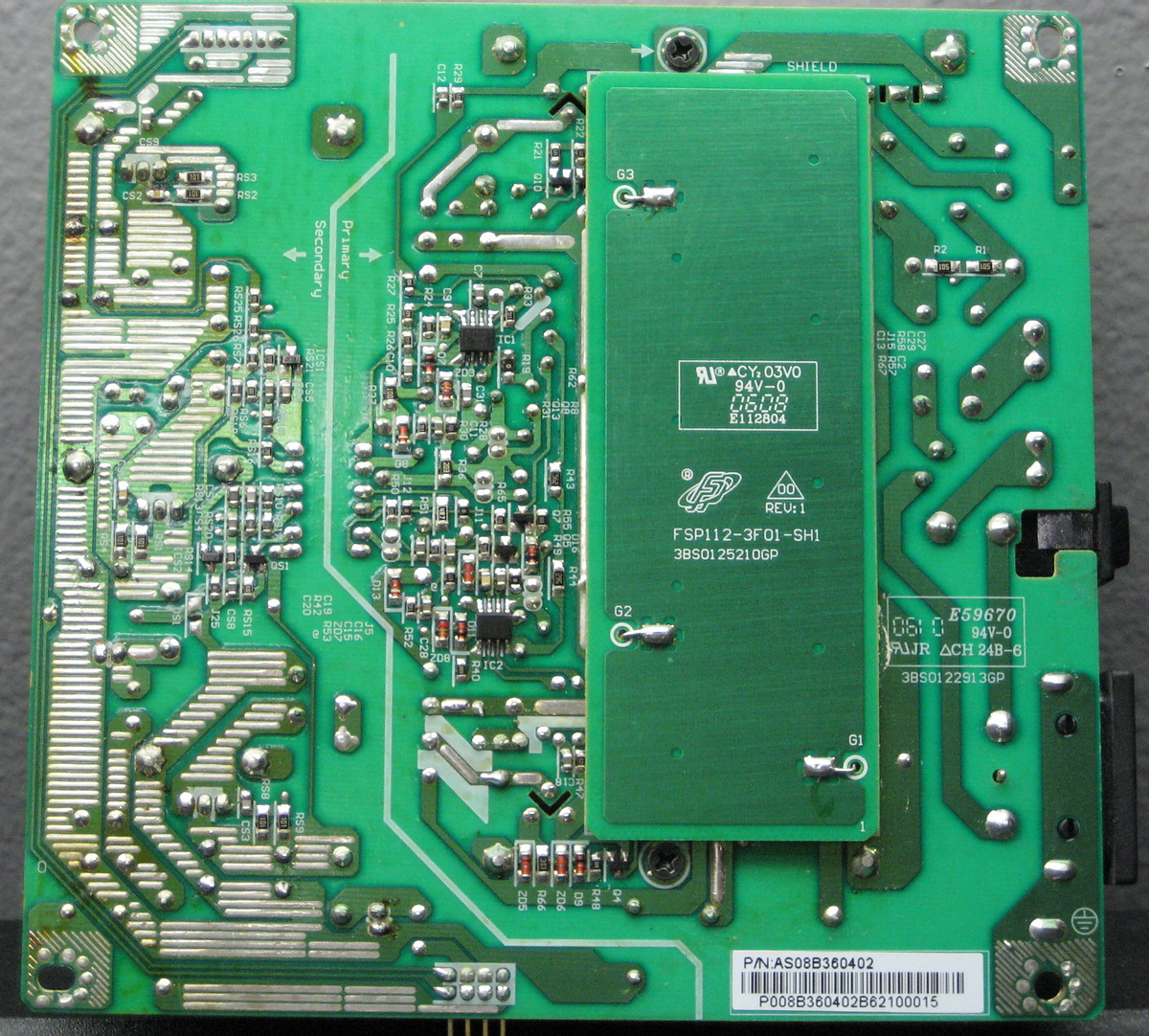

                  Okay got the ground shield off. Don't see anything obvious there. See pic.
                  I'm out of things to check. What should I look at next?
                      So just to confirm, have you changed EVERY cap on the PSU board (small and big)?
                        Good question...
                        I have replaced every cap small and big on the primary side.
                        The secondary caps all look fine. Funny you should ask because at the moment I am about to pull the trigger on Digikey for the 6 small caps on the Secondary side. Might as well do those before I give up completely.
                        I'm also debating replacing all the video board caps but there's 28 of those. Maybe I'll do just the 8 330uf ones and the 100uf (the same ones TopCat changed) I have most of these on hand so I might as well order the last three with this current order and swap 'em out.
                        That should put me in a pretty sorted spot to finally figure this out.
                        Thanks for the response! I will report back after I install all the new caps.
                          CleanSC
                          Please update your profile to show what country (at least) you are in.
                          So exactly which caps did you replace? The two by CNS1? Can you circle them on your pix?
                              Hey Lucky...
                              Sorry about the profile, it's updated now.
                              I changed all the caps on the secondary side (I mispoke earlier), which are all the caps to the right of the dividing line. They run along the right perimeter of the board down to the lower right corner.
                              The primary caps are the 6 clustered on the center of the board and are on order.
                              All the output pins are dead. I'm testing them by probing each of the +v pins and the ground pin. Nothing. Is this the proper procedure?
                                Something caught my eye on the solder side of the inverter board. Is there a burn mark in the upper left hand corner coming down from the screw ground points to the heatsink near the red fuse? What is the writing on the part attatched to the heatsink?
                                    Nope, it's just some flux. It scrapes off clean.
                                    What part on what heatsink are you referring to? There are 5 heatsinks.

                                        CleanSC, in the first picture of the bottom of the board, it appears pin 1 is at the upper right corner of IC1 and IC2. Pin 2 is the pin to the left of pin 1, while pin 8 is at the lower right corner. With the monitor plugged in, what is the voltage from pin 2 (gnd) to pin 8?
                                        Oh, if you get a chance, a closer picture of that area would help.
