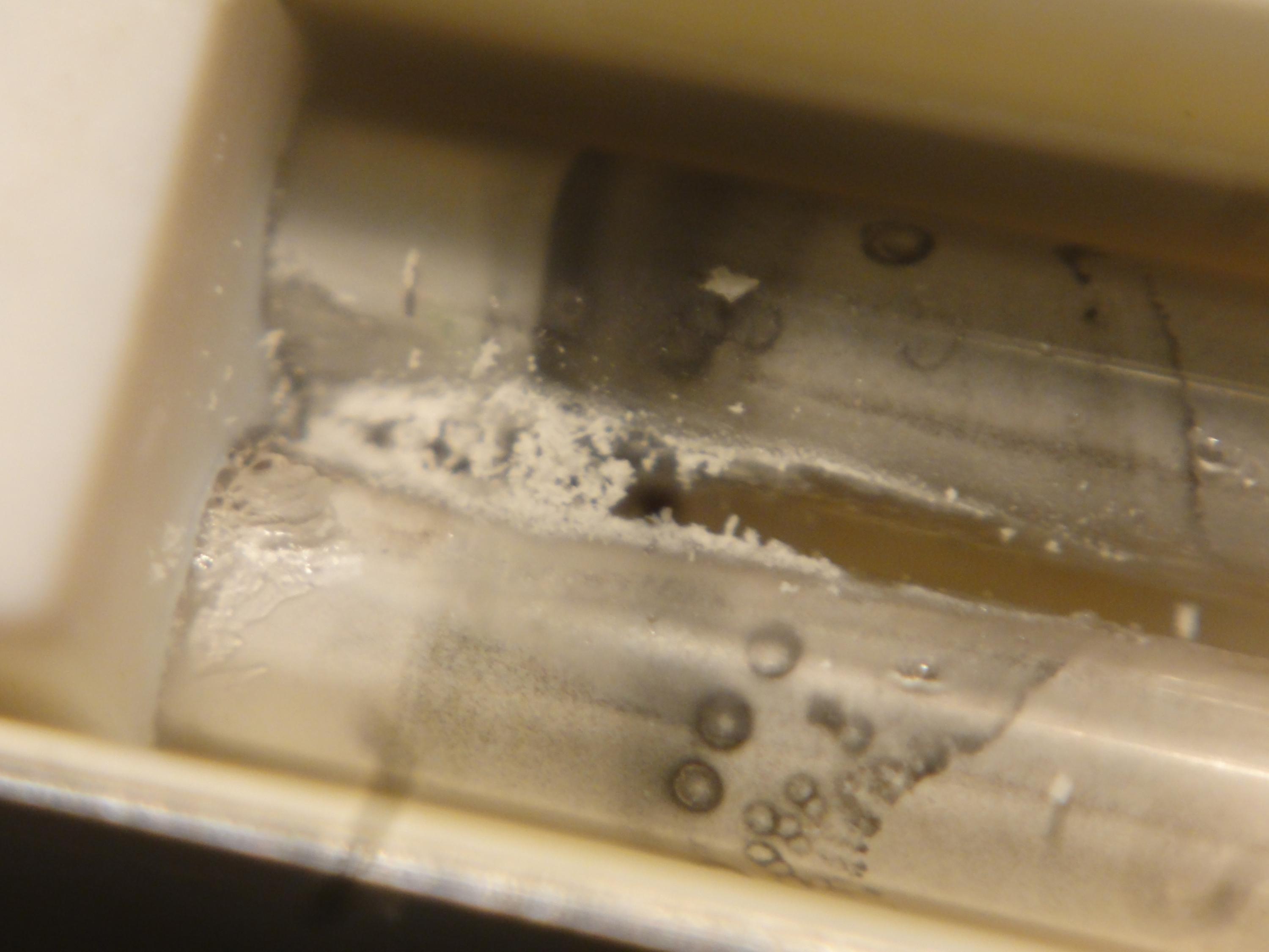

            Last year I finally fixed this monitor, the fault was indeed bad CCFLs. At the time I originally posted this, I wasn't confident to replace the lamps without breaking the panel, but after doing other monitors since then I thought I would give it a try.
            I tried Budm's CFL test trick and found the monitor stayed on just fine with the two upper lamps replaced with external ones. Upon very close inspection I noticed when those lamps were running, I could smell ozone in the top right corner where the yellow patch is.

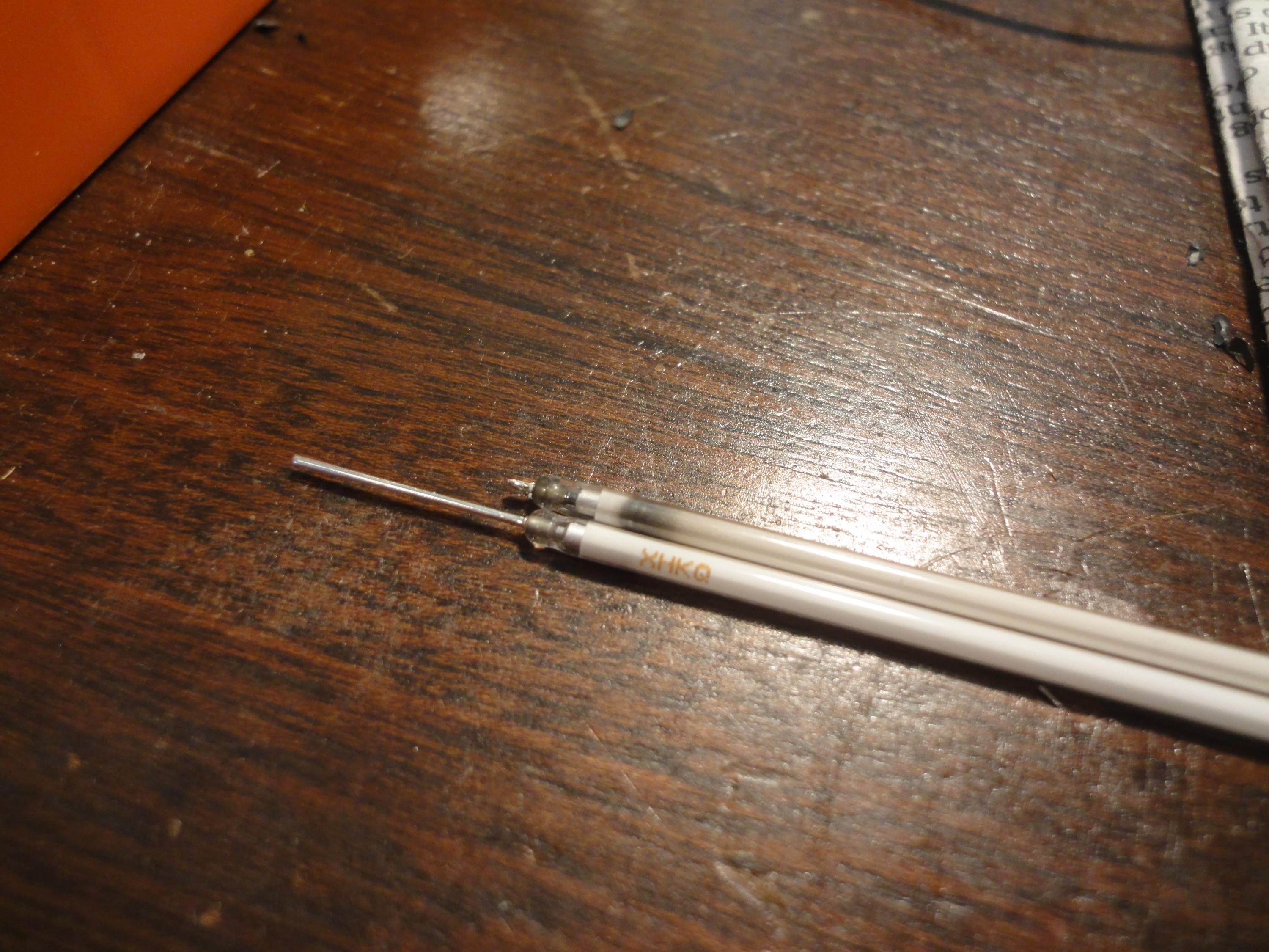

            I bought new CCFLs for it (Pack of 10 actually to have some spare) from a seller on eBay in Hong Kong. They were shipped wrapped in bubble wrap and put individually into sections of PVC pipe. None arrived broken. They are branded XHKQ if that is of interest or means anything to anyone.
            I cleared my table and disassembled the panel. Once I removed the old lamps it was obvious the problem - the top two had cracked on one end, and one even fell apart when I removed it.
            With the new lamps it was fine but unfortunately the white plastic backing layer of the panel assembly was yellowed as well as the CCFL reflector channel and this was unfixable. Fortunately the yellow is not that noticeable in normal operation being up in the corner anyway so I still don't care.
