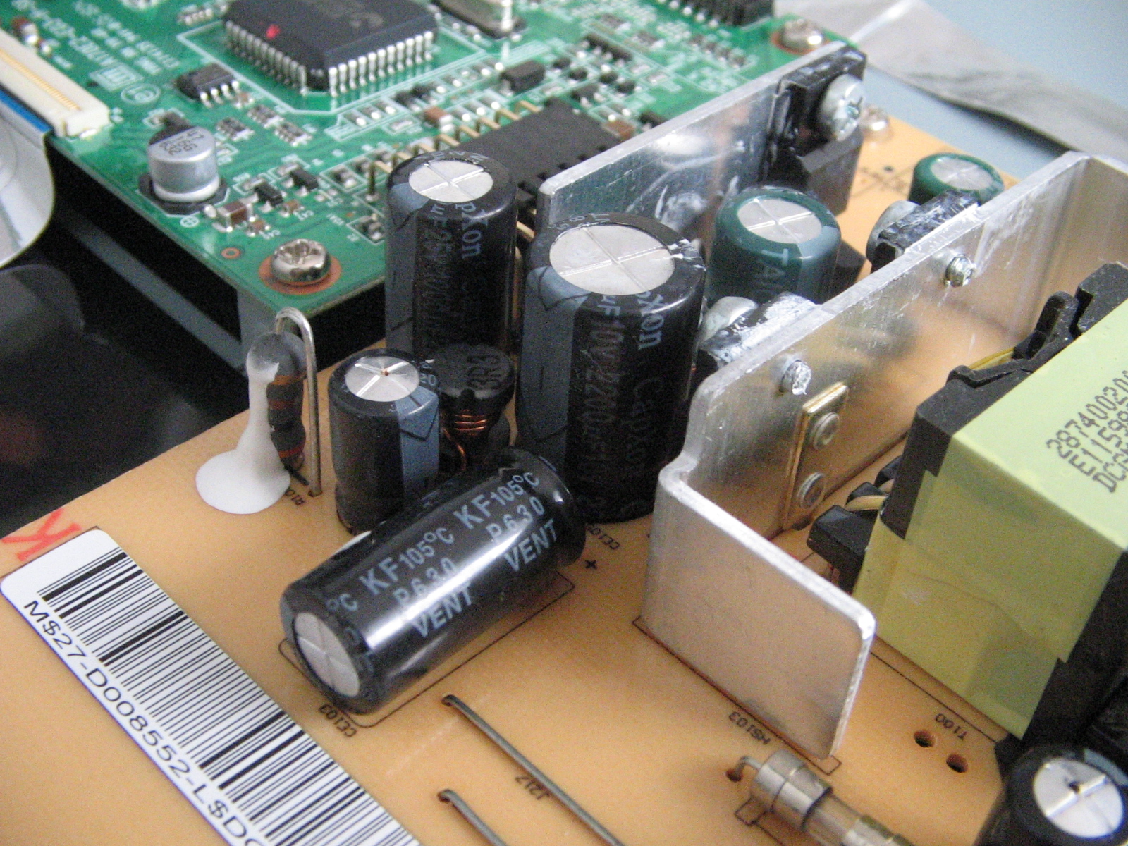

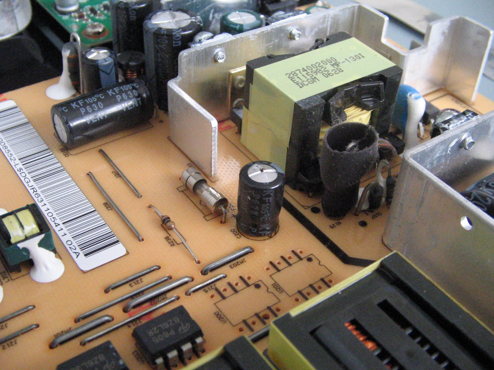

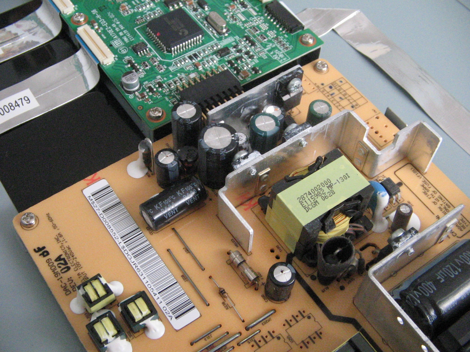

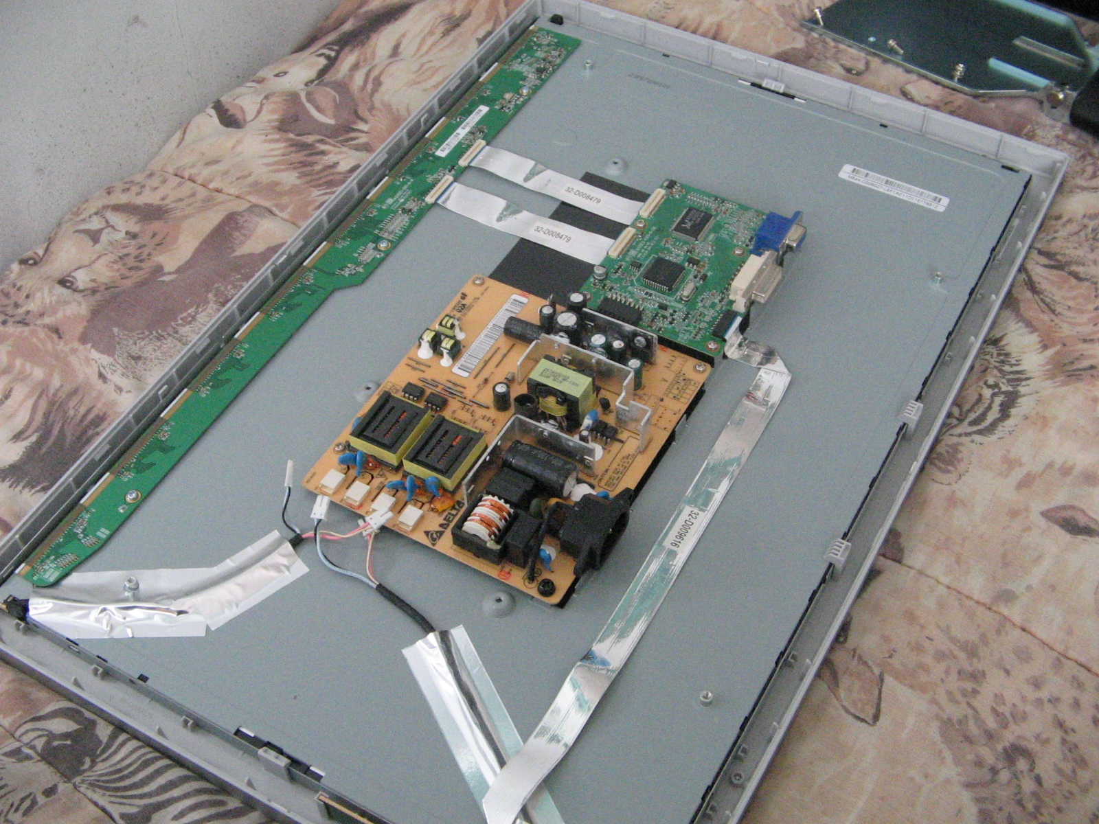

    Got a Chimei 22" LCD, faulty of course, otherwise I wouldn't be posting here
    It powers on, tries to start the lights but fails. Previous owner tells me the picture is showing if you put it in a very dark room (I have not verified that)
    PSU\Inverter is using CapXon and Taicon.
    Three of the CapXons (220uF 25v) are bulging and I suspect all the rest aren't great either.
    I'm wondering if Nichicon HE are good? I think I read something here that they weren't. Because for one capacitor value they are the best replacement (meets or exceeds old capacitor specifications in ESR and Ripple but is cheaper than others) Also they have highest life (10,000 Hours)
    -David VanHorn

    The full list is here. Nichicon HE's are most likely better than the originals, just not the best possible series. I'd say use them.

        Looks the same as my 22" Viewsonic (Cheimei panel inside).
        I re-capped with Panasonic FM all round, working fine apart from a whine in standby - still not got round to troubleshooting it.

          How did you deal with the 2200uF capacitor?
          In my case, no capacitor can be taller than 20mm or so. I looked up the specifications for the FM series, and the 2200uF 25v is 35mm high
          Funny thing though, the CapXon datasheet specifies this capacitor as being 25mm high, but the one I have is 20mm high

              Never mind, I'm an idiot. It's actually a 10 volt capacitor...
              That explains the size difference!

                    Panasonic FM are much lower ESR than Nichion HE, but if they're what you have to hand and you want to test it, try them.

                      I don't have anything to hand. I'm looking at what I can order from RS Components
                      The FM sure is lower ESR than the HE, but in comparison to the original Taicons the FM are actually closer.
                      HE seems to match closest to the CapXon KFs though.
                      I think I'll end up buying a mixture of FM and HE actually.

                        For the 1000uF 10volt, I already have some Rubycon ZL 16volt.
                        However the ESR is 3 times lower than an HE or FC and original Taicon PW\PZ (0.023 vs 0.068)
                        Do you think these ZL would be OK to use instead or is the difference too great?

                          Nippon Chemi-Con KZM or Rubycon ZLH or Nichicon HV (if you can get them) or equivalent have a 6k-10k hour lifespan under worst-case conditions.
                          LCD monitors and TVs can get quite hot inside...

                            There is a lot of confusion about the ESR spec. The value published is the guaranteed MAXIMUM value at the stated temperature, when new. The actual value will be much lower than that.
                            Two things to remember: First of all, the lower ESR results in a higher surge current at the moment the monitor is plugged in. The power supply stays on as long as the monitor is plugged in. Once the power supply reaches operating voltage (less than a second after the power cord is plugged in) the low ESR doesn't result in a higher surge current through the SMPS.
                            The second thing to remember is low ESR is better.
                            Somewhere last fall I described the results of testing a number of new and used caps in a TV I had repaired. Several (that had bulged tops) had an ESR of several times the rated value. Most of the original caps read well below specs. Some of the original read lower after two years of use than the new caps I was installing.

                              But isn't higher surge current from lower ESR a bad thing and may damage components in the PSU?

                                    Well I've ordered new ones, trying to match the specifications of the original CapXons and Taicons as best I can.
                                    The originals seem to have lasted about 3 years so these new ones of much better manufacture should be good for a long time to come I guess.
                                    Hopefully they fix the problem as well
