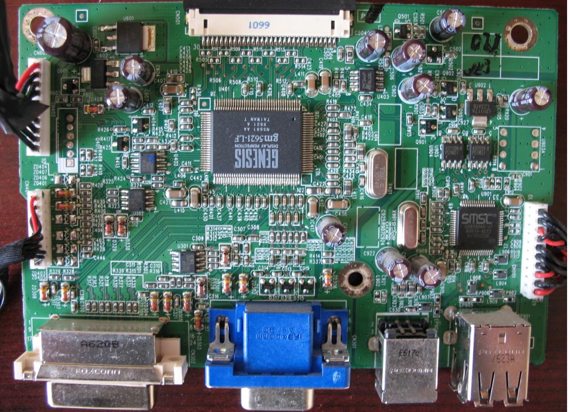

    I have a Dell 1707FP which when connected to mains power shows no sign of life - no power light nothing and no response when pressing the buttons. I have taken the monitor apart and there appears to be no blown or damaged capacitors. Does anyone have any ideas as to what could be wrong with it? I have tested the LCD panel itself with another monitor and that works fine.

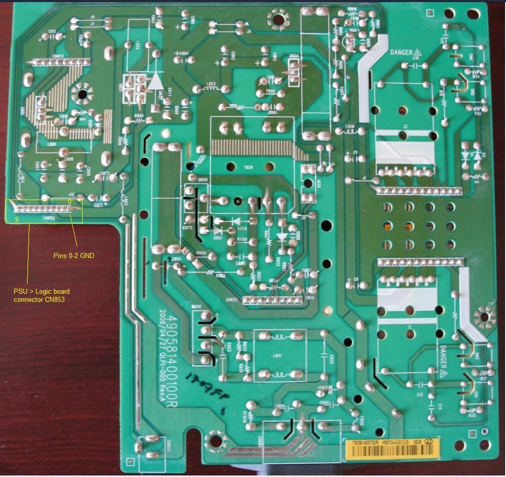

    There's no rampant signs of cap failure to me in the pics or the symptoms.
    First - power OFF - check the red fuse to the left of the AC inlet for continuity, then if that passes measure (carefully) - power ON - the voltage across the large 450V cap to the right

      I've measured the resistance across the red fuse (T 5A 250V) with power off, on the lowest resistance setting on the digital multi meter (200ohm setting) I get a reading of 0.4 which to me sounds like a good fuse? (low resistance but not open circuit). The highest setting on the DMM (2000Kohm) shows 0 probably as the fuse is low resistance (i assume - correct me if i'm wrong).
      When testing the 450V cap, do I need to connect the rest of the parts, ie the logic board, inverters, LCD etc? or can I just plug in the AC to the board as pictured? I also assume that the DMM will need to be set to AC as this cap is on the AC side? Thanks

        Yes, continuity is there.
        Just in case there is a glitch, reconnect to the proper configuration then test.

          Ok I hooked up all the components, testing the voltage across the 450V blue large cap, (DMM set to AC - 600V scale) I measured 735V AC and (DMM set to DC - 600V scale) 330V DC. I did notice the first time I took the measurements there was a ticking noise coming from somewhere on the board. This was not apparent when I unplugged - reconnected mains for the second retest. - I've on EU power so 220v-240v ac.

                                I've measured the voltage from ground (or what I think is ground - please correct me if i'm mistaken) - the three pins on the right of the (pins 0 - 2) connector CN853 (PSU -> Logic card) which appear to be connected to the ground track of some nearby caps and that track also goes to the chassis mounting screw hole so I assume thats a suitable ground location (see attached underside pic). The voltages relative to these GND pins (right to left as shown on underside pic):
                                Pins 0-2: GND (0V)
                                Pin 3: 0V ---- (as expected as this appears to be connected to the 12V optional speaker attachement - not attached)
                                Pin 4: 5.18V
                                Pins 5-7: 5.21V
                                Pins 8-9: 0V ---- (appear to go to one of the inverter transformers T2?)
                                All parts where connected: LCD panel, inverters, logic board (but not the usb header board)
                                No ticking noise heard now, only the constant buzz/humm of something.
                                Thanks for all your help so far!

                                  One thing is apparent; another can be inferred.
                                  1. The power supply is working.
                                  2. You have very good ears.
                                  As I've said repeatedly, the power LED is controlled by the processor on the logic card. It's time to post pictures of the logic card and see if we can find the problem.

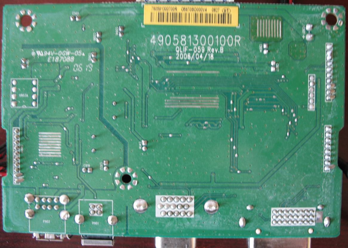

                                    I'm dreading that the logic board is dead, probably hardest to source/repair i'm assuming! Here are two pictures of either side of the logic board (model is a 1707FPt). Nothing appears to be burnt out visually.
                                    Sorry about the blur in the second pic, camera doesn't like to focus with no flash in macro mode.

                                        We may have a winner!!! What is the part number for U404 (three pin device to the left of the gm5621-LF).
