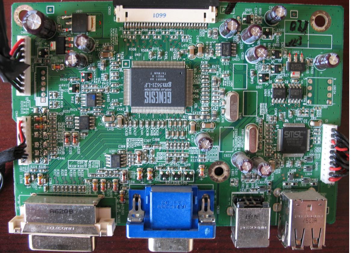

Dell 1707FP no power
  • bob12345
    • Apr 2010
    • 31
    Re: Dell 1707FP no power

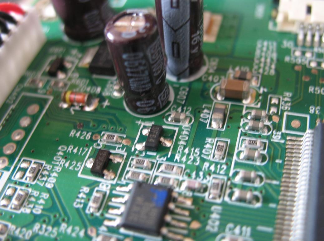

    We may have a winner!!! What is the part number for U404 (three pin device to the left of the gm5621-LF).
    PlainBill
    If my eyes aren't play tricks on me, the part# is DF64
      A better pic - Is that device a voltage regulator of some sort?
      • PlainBill
        • Feb 2009
        • 7034
        If I'm correct, it's a reset controller. A quick background: Processors often have internal charge pumps, etc that require a finite time to stabilize after the chip receives power. Plus of course, the power supplies themselves require time to stabilize. The common way to do this was with a resistor/capacitor network holding the processor in reset until the cap charged. The problem is the timing was not consistent, and the relatively slow rise time of the reset line would cause problems. It also doesn't reset quickly in case of a power glitch. Thus the reset controller. That busy little circuit holds a comparator, an oscillator, a counter, and a driver. When the power comes on the driver holds the processor in reset. Once the comparator senses the supply is above a preset level (90% of nominal supply voltage, it allows the oscillator to drive the counter. Once the desired delay has been reached, the driver releases the reset and the processor starts.
        Measure the voltage on the three pins of U404. Also, there are three voltage regulators to investigate. Measure the voltage on all three pins of U601, U602, and U902.

            Ohhh, my head hurts. These numbers aren't making sense to me. OK, let's try to make some sense of what is going on here. In the upper left corner of the board is a mounting hole, which seems to be designed to contact the metal mounting screws. That SHOULD be ground. Verify by measuring the resistance to the - lead on several of the caps, please. (This should be low - under 1 ohm).
            Set the meter on DC volts, and with the power on measure the voltage from ground to the pins of U404, U601, U602, and U901. ALSO list the part numbers of U601, U602, and U902, please.
