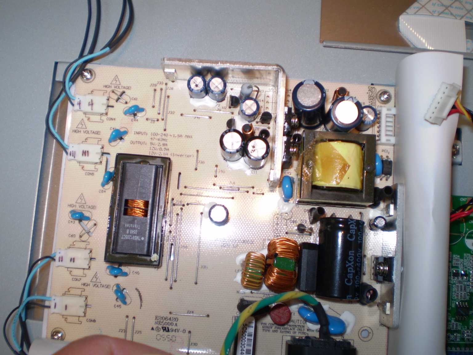

    I have been looking for the answer to fixing my DCLCD 19" Monitor. (Specter)?
    1. turn on the monitor and the red led comes on then turns blue.
    2. then the screen flashes a silver screen. the led flashes red then blue again and stays blue.
    3. however the screen goes black with no image at all and stays that way.
    4. Took the monitor apart and checked for any bad caps with bulging domes.

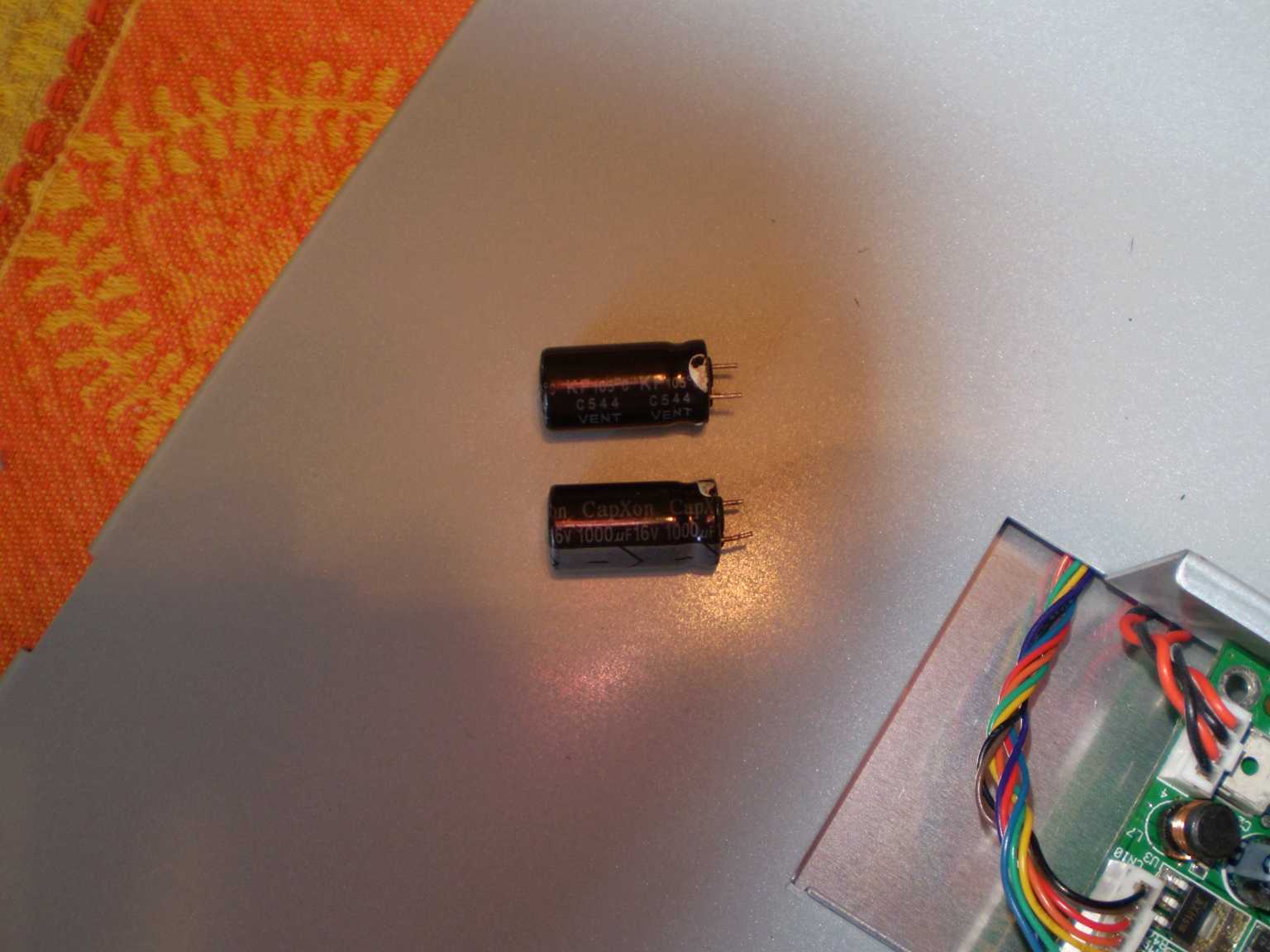

    5. found 2 they read CapXon 1000uf 16v KF 105 degrees C vent
    6. have nothing to test any parts with so am just looking
    7. pulled the 2 bulging caps off the board (power inverter)tried to replace them with 2 of equal value but they are larger then the ones pulled off the board.
    8. no luck at all so the question is even though the new caps are the same as the ones pulled of the board, just larger is some thing else the problem or is it the new caps?

    What did you use as replacement? (Brand/series).
    Pictures would help

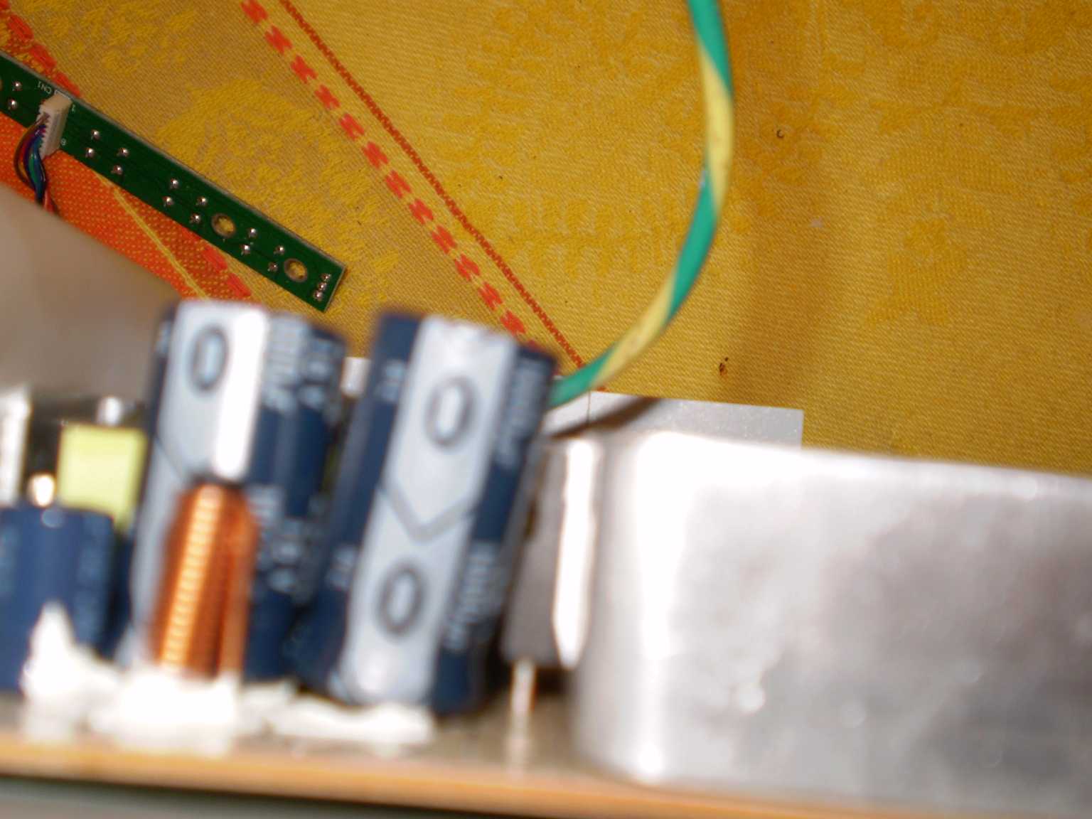

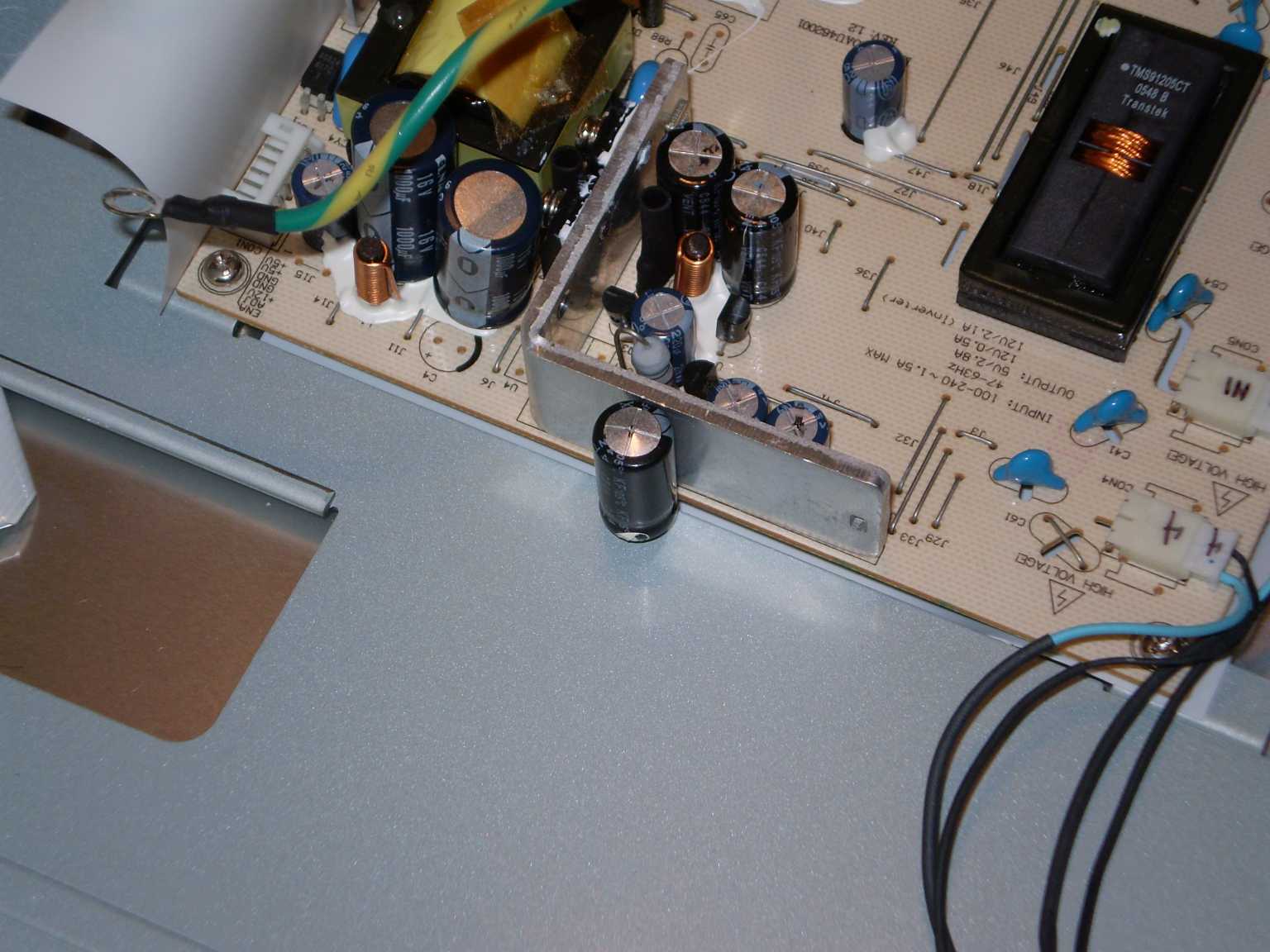

      the new caps are ELNA CE 85 degree C
      here are the pictures

        Better get the right parts. Read this FAQ.

          Agree.
          Low ESR (and 105c temp rating) are needed here. Without proper caps, you can't go further.
          Also, replace them all, not just the two bulged ones.

                Standard suggestion: Make a list of the electrolytic caps, showing capacity, voltage, diameter, and height. If you want to, follow the steps here. Or simply post the list. Someone will make suggestions (or verify yours).
