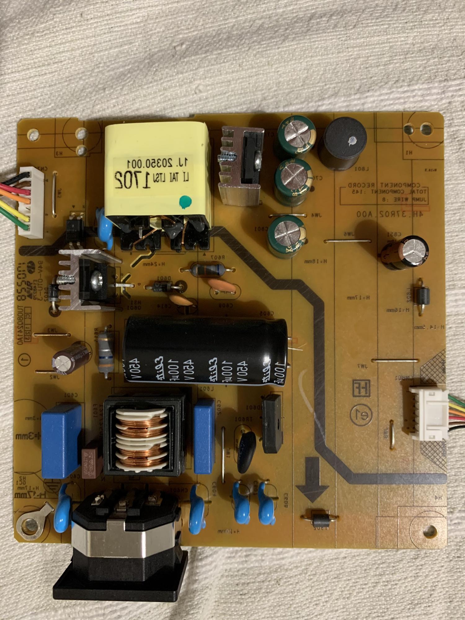

    I have this monitor that turns on but doesn't have BL and it seems no image too.
    Isolating the PSU, I get voltages on the mainboard connector (red+orange is ground):
    Green+yellow: 18.9V
    Black+brown: 0V
    The BL connector gets 18.7V
    I checked the caps visually and with an ESR meter and seem fine.
    Also the panel is ok because I hooked it up to a spare PSU and mainboard from another 24' monitor and works well.
    If it helps D701 is MBRF10200CT. I am looking at a faulty transformer here?

    Re: DELL P2417H no BL no image
    If the transformer was bad you would not have 18.7 volts, It could be that the main board is not sending the BL on signal, Since there is 18.7 volts being supplied to the main board, I suspect there are other regulator ic's on the main board, I would check their voltages.
    Looking at main board pictures, there are a couple fuses, TH121, TH751 & Th752 on the main board

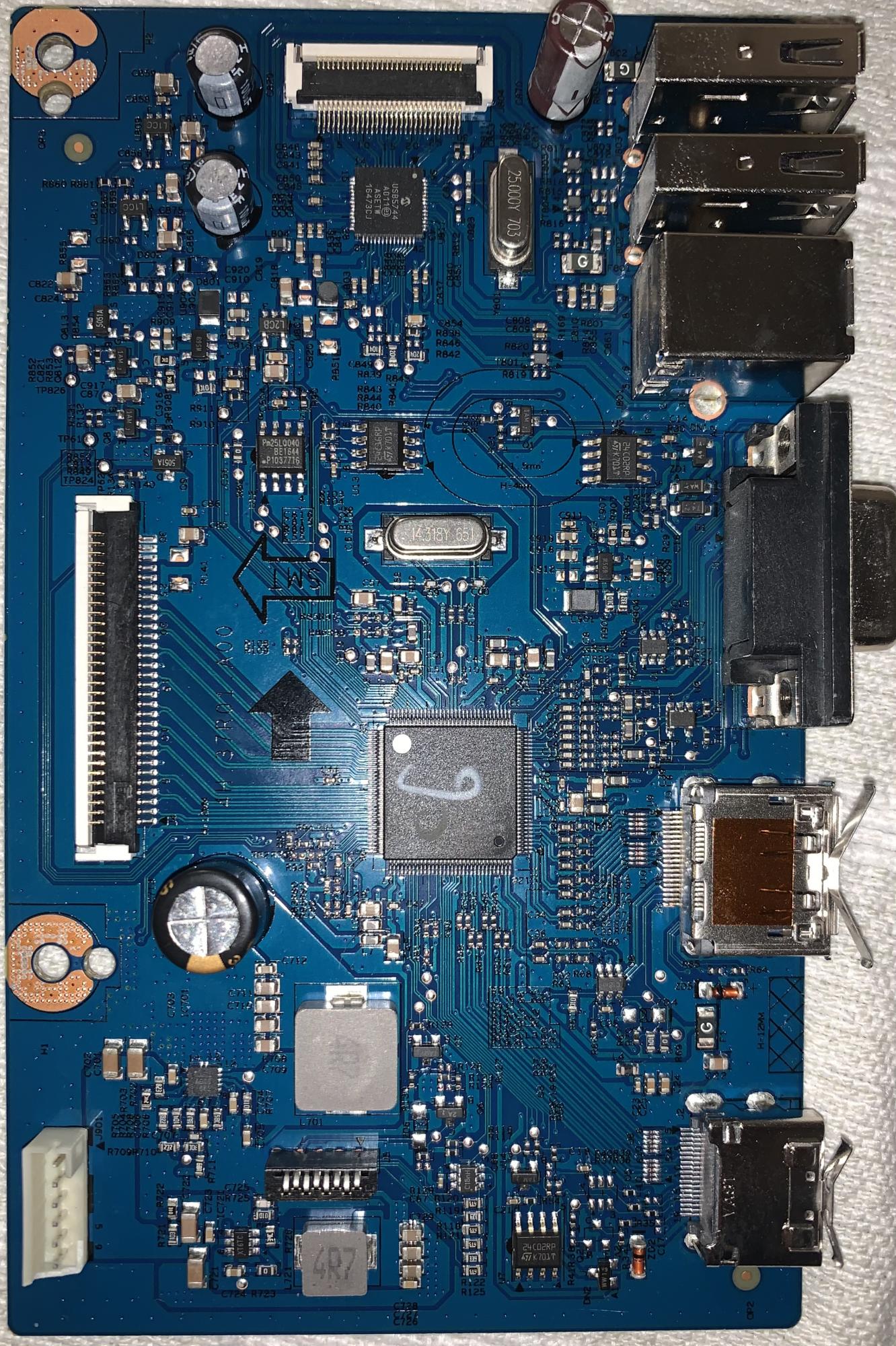

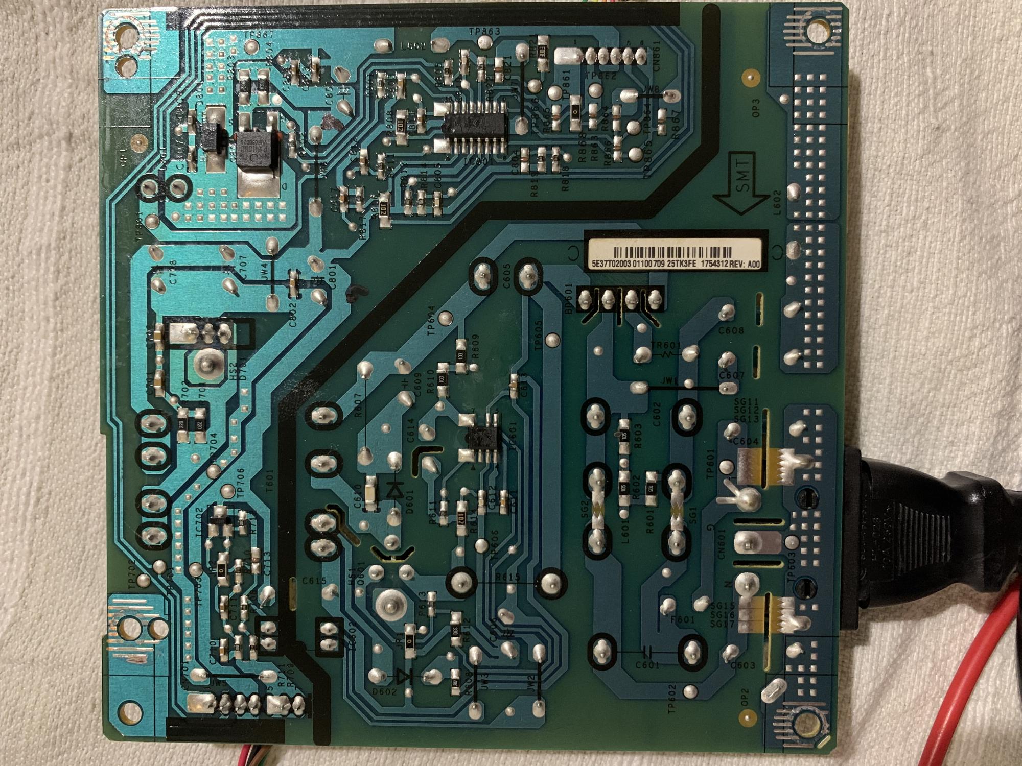

      I am uploading a picture of the mainboard.
      The pins of black and grey are connected directly on the main chip U1
      Update: I cleaned the mainboard with alcohol and resoldered the chip and I have 3V no in black and grey BL_ON. But the backlights still won't go on. I checked again with a flashlight and can see image now, but to be honest I can't tell 100% in the beginning if it already had one.
      Anyway, at least now we know it's the PSU?

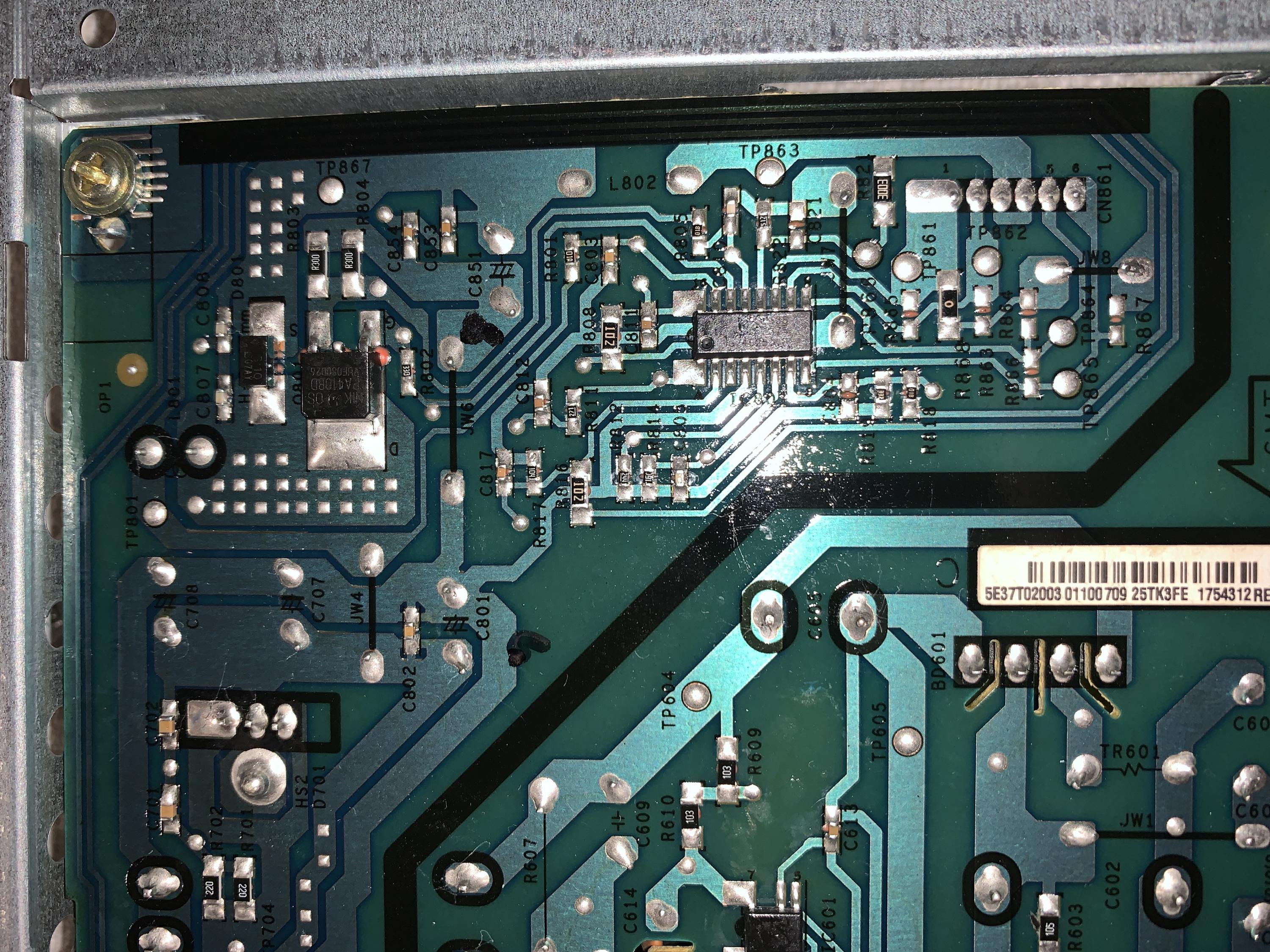

      I am uploading another image closer to the circuit
            I didn’t know this for the transformers! I will never forget now...
            Ok so I checked all the resistors and caps on this area around IC801, Q801 and all seem in order.
            Q801 is PA410BD Vgs(th) is 1.3V min and I have on the gate 0.03V and at source 0V.
            Diode D801 tested on diode mode with PSU off ok and PSU ON forward voltage drop 0.5V
            The voltages on the pins of the IC801 that lead to G-S pins on Q801 are the same.
            Btw I found another PSU board also from a non working DELL monitor 22’, almost identical to the 24’ and has exact same problem.
            I had a general idea how this part of the board works, for the BL but your explanation was great, so thanks!
                I don’t know what else to look for.. I checked again everything and can’t find sth faulty, so maybe it’s the IC itself? I measured the pins of the ic801 and they go:
                V1(hole): 0.02 V2: 3.24 V3: 0.25 V4: 0 V5: 0.06 V6: 0 V7: 2.4 V8: 0.25
                V9: 0.22 V10: 0.25 V11: 19.02 V12: 0.3 V13: 0 V14: 0.02 V15: 11.4 V16:0.25
                But unfortunately I couldn’t find a datasheet for MP3375 which is IC801
                I found another datasheet from MP3398 though which looks quite similar
                https://www.monolithicpower.com/en/d...n/sku/MP3398A/
                              Originally posted by Sraros
                              But what still gets me thinking is this with PWM. The datasheet says:
                              “If PWM dimming is not required, pulling this pin to high voltage(1.25V<Vpwm<5V)”
                              So if it is required then must be less than 1.25V
                              Mine is at 6.18V so in any case looks wrong.
                              Well, it appears that pin 3 (PWM) of the IC is not connected to anything... so it will likely have a floating voltage on it. Since your Vcc = 6.2V and pin 3 is floating, it's probably normal that it's at 6.18V. Of course, if you want, you can just inject 5V into that pin through a 1-KOhm resistor, just to be compliant with the datasheet.
                              And no, PWM dimming is likely not used here, since you can see that pin 2 from connector CN701 goes to pin 7 (ADIM) of the MP3375 IC. That means IC801 should be getting an analog dimming signal from the main/logic board. According to the MP3398 datasheet, though, the analog dimming voltage should be somewhere between 0.4V and 1.5V for backlight brightness of 0 to 100%. So just check what DC voltage you get on this pin. If you have an oscilloscope, you can also check if the voltage is PWM or not, since MP3398 datasheet says you can also used this pin for PWM backlight dimming (which doesn't make much sense, since it seems pin 3 can be used for the same function... but whatever.) On that note, check that resistor R818 (looks like "01b"... so probably a 1-KOhm) is not open and that the resistor next to it (R819?? looks like "332", so 3.3-KOhm) is also not open.
                              Another thing I noticed is that the area around resistor R801 ("01A" - so 100 Ohms) looks a little darkened. Make sure this resistor is not open or high resistance either.
                              While at it, check R811 (270 Ohms) - it should measure at or very close to 270 Ohms. If it measures lower, ceramic cap C812 may be bad. If in doubt, remove and check C812.
                              Same goes for R812 (looks like 240 KOhm) - this is the resistor that sets the oscillating frequency of the IC. If R812 is bad, IC will appear dead and not work.
                              Next, check R814 and the ceramic cap next to it (C803?). Like the above, the value of R814 should be pretty spot-on to what is printed on the resistor. If it isn't, remove it and check it out of circuit. If it checks out OK, check the ceramic cap (C803?) out of circuit as well. R814 sets the current the backlight should use, so if it is bad, the current may become set too low and not allow the backlight to work.
                              Also check resistors R821 and R822 - these set the over-voltage protection of the LED driver circuit.
                              Finally, resistors R803 and R804 - these both appear to be 0.3-Ohm resistors and they are in parallel. So unfortunately, you may not be able to measure them accurately in circuit. But if they have gone even slightly high on resistance, then IC801 will think the MOSFET is drawing too much current and stop the backlight. So it may be just a good idea to replace them if you can. On that note, make sure R805 ("01b") is not open. This resistor reads the voltage across R803 and R804
                              And that's all I can think of to check. If all of this checks out fine, it may be just time to "shotgun"-swap parts. I personally dislike doing this. But sometimes, it may be the quicker way to get things working.
