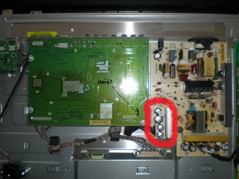

    Unless it's a trick of the light, I see connect 4 on your power supply!
    That's 4 bad capacitors....

      I agree with Sean, those four in the lower left hand corner of your power supply pcb definitely look domed. Would need higher resolution shots to be sure though. Your inverter pcb is to the right of your power supply board.

          Is this the area your talking about?
            You mean the part that has the ribbon to the touch controls/power button?
              In the circled red area, they sure look domed in the picture. If unsure, post clear focused pictures with a resolution as close to 2000x2000.

                Yes, exactly! As retiredcaps says, please post a higher resolution shot of this area (maybe the whole power supply board if you would please).
                I don't think the inverter board has the FFC to the touch controls, this should either be on the main board or the USB sub-board (I forget which on this model).

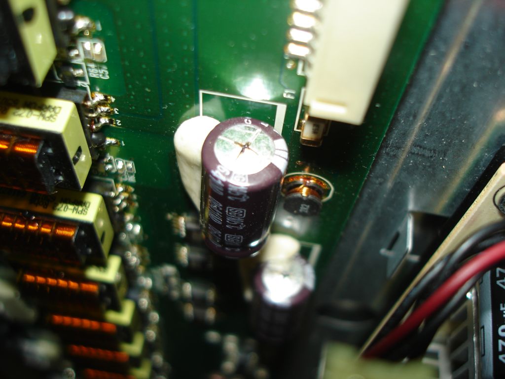

                        Better?

                          Better, yes. But the focus should be on the caps and not the wiring. The way to do this (on many digital cameras): push down halfway on the button to focus, then move the camera to frame the rest of the picture. This will allow you to focus on anything and include anything surrounding that may help. That being said, I still can't tell if they are bulging but it does look at least a little like they are. If the tops are not completely flat, then it's time to replace them.

                            The four on that side are all domed, not seriously but none the less not completely flat like the others.
                            Guess it wouldn't hurt to replace them all.
                            Could these be found at Fry's?
                              The only radial caps I see at Fry's are NTE brand, and I've never heard of them. Safer to go with Panasonic FC or FM from Digikey or Mouser. I would also recommend replacing all of them on the power supply except for the large one on its side. It looks like there are 11 not including the big one. If you want help picking out replacements, list the uF, volts, make/series, diameter and height of each cap you are replacing and someone will make recommendations (the easy way is to just stick with Panasonic FC/FM though).

                                Domed, no matter how convex, indicated a bad cap -> i.e, definitely needs to be replaced as Wrog suggests with low ESR caps like Panasonic FM or FC series.

                                      First off, thank you for such a great resource and, in advance, any help that you gurus and experts will be able to provide!
                                      I recently acquired a Gateway FPD2485W that is having the following problem: Unit powers on, displays blue power light on lower right hand corner, fades to purple and then orange/amber. When powering on, the "chimes" do sound, however nothing appears on the screen - whether that is the Gateway logo or input from any source (component, DVI, VGA). Even with a flashlight on it, the LCD does not display an image.
                                      I pulled the casing apart (pain in the butt) and found a few capacitors that appear to be bad - I am hoping you experts can help identify and confirm, by visual, that these are indeed bad and would be causing the problems I am experiencing. With my limited knowledge, atleast one on the power board and (2) on the inverter board are bad.
                                      Any assistance is greatly appreciated!

                                        Looks like 3 caps on the power board are bulged. However, with the exception of the large 450V cap, replace ALL of them with something like the Panasonic FR,FM or FC series of caps. Order through digikey.com and select USPS First Class ship for lowest rate.
                                        Also, replace BOTH caps on the inverter board, since they are starting to leak. Use same series caps as above.
                                        On the inverter board, check fuse, F1 (lower right), for continuity and mosfets, Q1-Q4, for shorts.

                                          Based on your advice, I checked the F1 fuse for continuity, and it appears to be blown. Q1-4 appear to be fine.
                                          Anyone know where a replacment fuse can be found, or can I just wire up a regular fuse with wire leads to make it easier?
