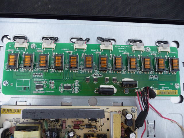

              Hello everyone, another new member here. I just inherited a Gateway LP2407 (also refered to as FPD2485W). I don't know the history of the monitor, but it has the same symptoms as posted here. When I plug it in, it makes the musical sound, and the blue power light comes on and the lights above it flash on, but then after a while the light turns orange. There is absolutely no picture being displayed. I already took the monitor apart and found quite a few caps that were bulged on the top - on all 3 boards, so I replaced all the caps but the biggie on the power supply board -the 150uF 450V one (it wasn't bulged and appears to be hard to find). So after putting it back together, I still get no display. I'm sure a lot of the capacitors were bad, so they should have been replaced, but now I'm wondering if there is a bad fuse. I checked the fuse on the power supply board (F850) and it checks out ok. I looked at the inverter board, and I'm guessing that F1 may be a fuse. If it is, It doesn't appear to be ok. If I touch DVM to ground and the other lead to one side, it buzzes, but if I put it to the other side of F1, nothing. I replaced both caps on this board because they were swollen. Assuming F1 is a fuse, and it is bad, could the swollen caps have caused the fuse to blow? If not, any advise what else to check? If it is a fuse, does anyone know where to get it and/or part#? Thanks in advance for any help. Russell
              • retiredcaps
                • Apr 2010
                • 9271
                #47
                Re: Gateway FPD2485W - capacitor related?
                The way I measure a fuse is to put the multimeter (if manual) on the lowest ohms setting. Then I put red on one side and black on the other. A good fuse should measure less than 0.9 ohms depending on your multimeter.
                A clear focused picture of your fuse would help. Manufacturers can change board revisions and may not use the same components even though the model number on the front of the LCD are the same.
                If you are in the USA, I'm sure Digikey has a replacement fuse.

                        All it shows is IE 5A, so I assume it's a 5 amp fuse. When I say I'm tempted to jump a wire strand across, I mean literally a single, very thin wire that you would get from a strand. I would never put a complete wire strand across, that would defeat the purpose of a fuse. I think this part # from Mouser is the same...576-0453005.MR.

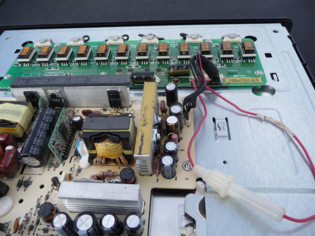

                                I found a 4 amp fuse (the round glass type that are often used for car radios, etc) that had a wire on each side. I soldered each end to each end of the fuse on the inverter circuit. After doing this, I plugged it in and first thing I noticed is that it didn't make the muscial sound that it did before. The display is still blank however. One problem I have is I don't know how this monitor behaves when it does work. Is there someone who is familiar with this monitor? Does it normally turn itself on, or at least play the music when it is first plugged in, or do you have to push the power button? I hooked up the thin 5 strand wire and it doesn't power on when I push it. I'm not sure what to do or check next. Hopefully someone here can give me a few pointers to try. I can check for some voltages, etc. if someone can tell me where to. If you need pics, I can upload some, but there already are pictures at the beginning of this thread from others.
                                Thanks,
                                Russell
                                • seanc
                                  • Nov 2008
                                  • 1319
                                  #56
                                  If it is now playing dead, take that fuse out. Sounds like it's detecting a short.

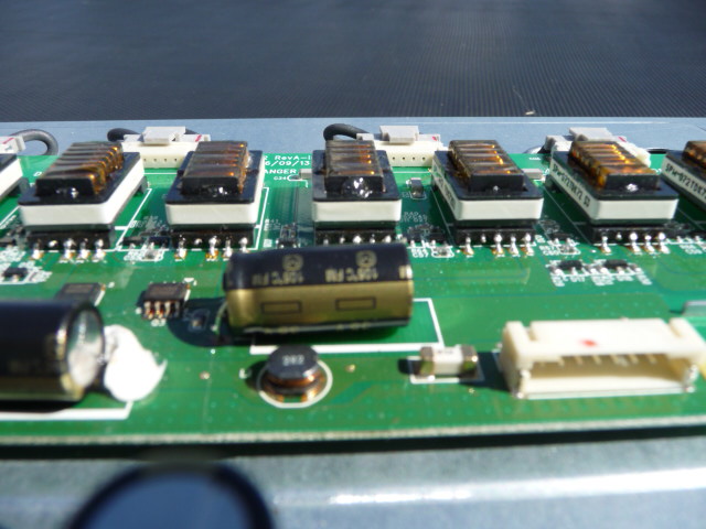

                                    Thanks, I took the fuse out and now the music plays again. Any idea what on the inverter board could be shorted? I attached 2 pictures to show the inverter board and the fuse that I soldered in. Thanks, Russell
                                    • seanc
                                      • Nov 2008
                                      • 1319
                                      #58
                                      Any number of things, I can't make out what's what.
                                      Can you take higher resolution photos?

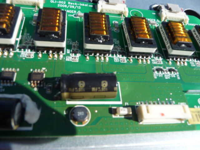

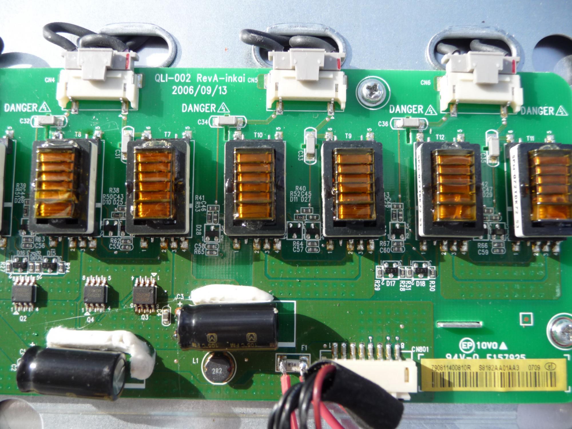

                                        I took 2 pictures. The first one is the right hand side, and the second is the left hand side. You can see the capacitor in both, so everything should be there. Thanks again for your help. Russell
                                        • seanc
                                          • Nov 2008
                                          • 1319
                                          #60
                                          Q1 & Q3 look like they've gotten hot.
                                          What are the numbers?
                                          9905GM
                                          645032
