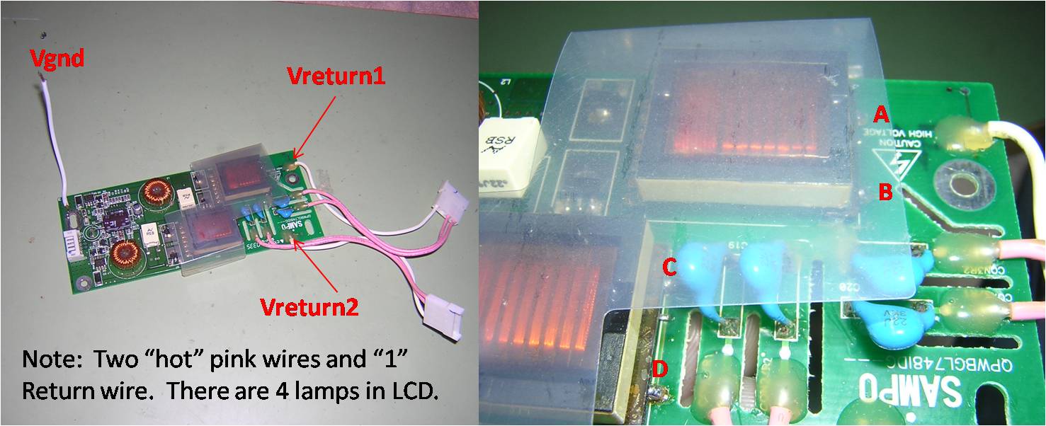

                          From what i can tell you want me to do the following:

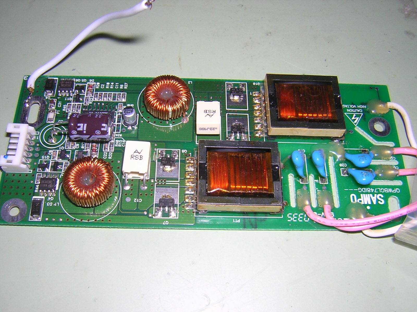

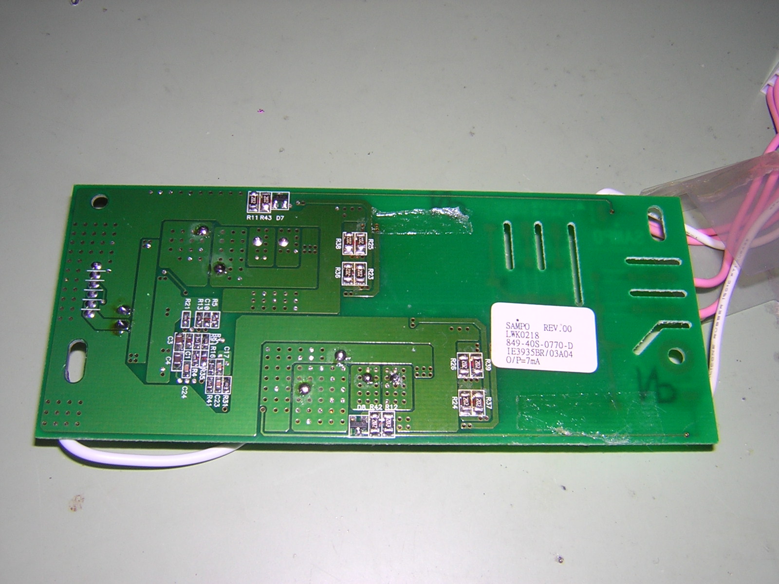

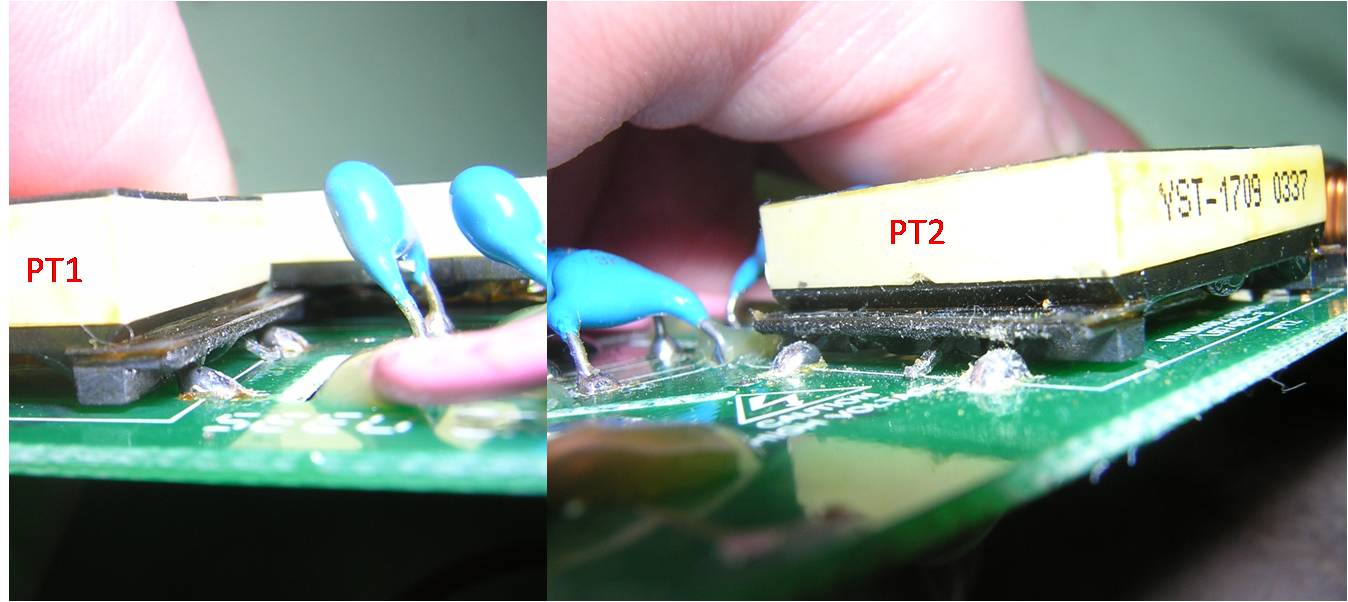

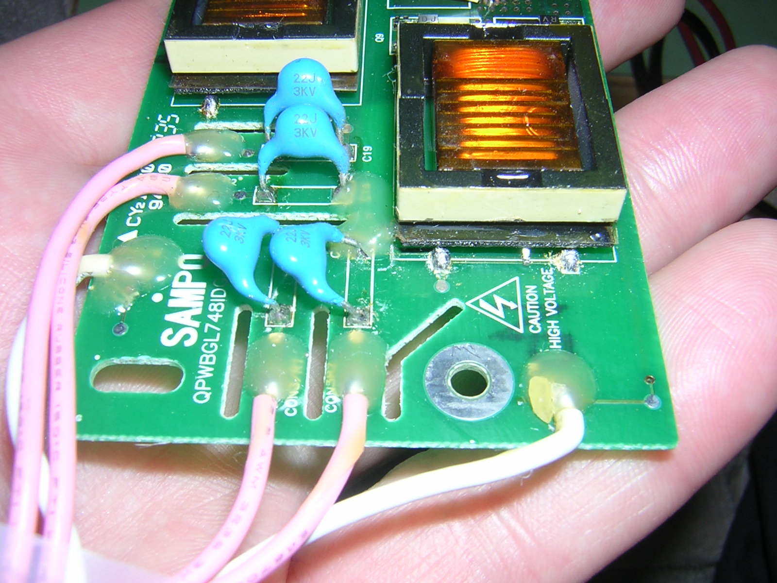

                          1-Measure secondary resistances of transformer (on inverter board). I have enclosed a pic as reference. So i measure A-B and C-D.
                          2-Also you want me to hook up everything (including ccfl bulbs) and measure from Vgnd to Vreturn of the lamp (again see enclosed pic). Note: I have 4 lamps in this LCD. I have 4 "hot" wires but only "2" return wires. So, the bulbs are shorted together for the return.....thus why i have only 2 return wires.
                          Question: Measuring the "Vgnd to Vreturn voltages.......i read somewhere that this voltage would be very high and could harm my DMM........is this true? Or is this only if i measure from Vgnd to Vhot............
                          Also, i have included photos of the front and back of the inverter board.

                              #34
                              Re: Mag 780 LT776S Not working....cap question on inverterboard
                              Originally posted by Welchs101
                              I measured the resistance
                              A-to-B: 0.2ohm
                              C-to-D: 0.2ohm
                              I will measure the Vgnd to Vreturn voltages once i get a response on my question from my previous post.
                              Something isn't right about the resistance. I'd expect something around 1K ohms.
                              The return voltage should be less than 10 volts. The output voltage could be as high as 1000 volts.
                              PlainBill

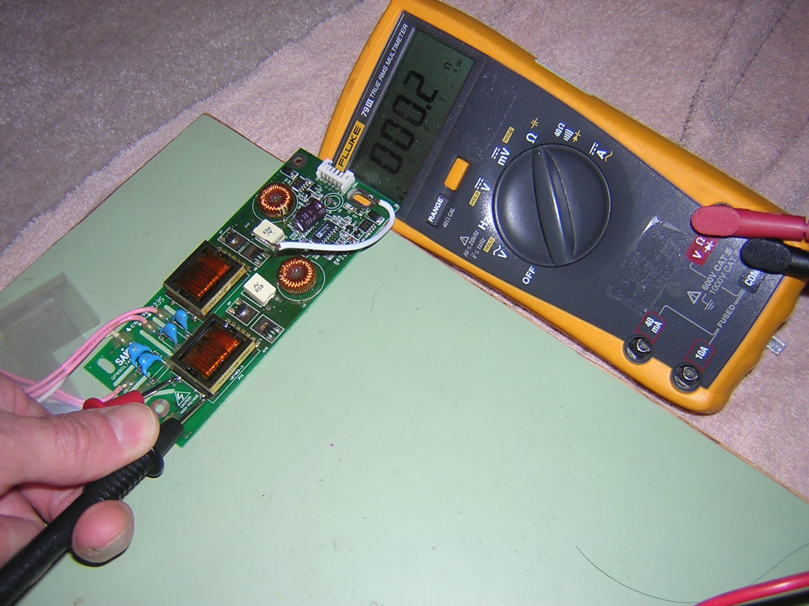

                                #35
                                I am enclosing a pic of how i measured the 0.2ohms........am i measuring across the right terminals?
                                • PlainBill
                                  • Feb 2009
                                  • 7034
                                  #36
                                  You appear to be. How about a close up of the end of that area.

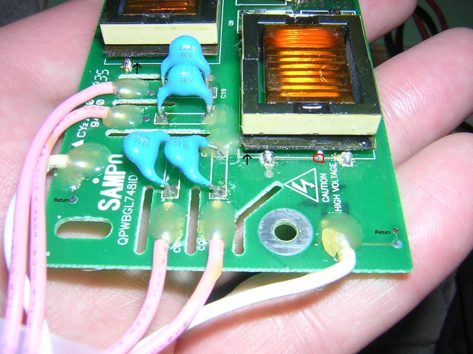

                                    #37
                                    Here is a close up of that end....let me know if i can provide more info.
                                    • PlainBill
                                      • Feb 2009
                                      • 7034
                                      #38
                                      The black arrows point to the output terminal. The red circle MAY be the other end of the secondary. Or there are 7 terminals at the other end of the transformer. One of them may be the other end of the secondary.
                                      I've identified the return test points.

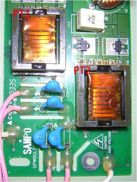

                                        #39
                                        Bill,
                                        When i measure the resistance between the black arrow terminals and the red circle i get an "open"....for both transformers. I am not even sure the "small" terminal is soldered to anything.
                                        I tried to look up the transformer (see pic.....it has part number) but nothing really came up.
                                        I will measure voltages and send in my next post.
                                        • PlainBill
                                          • Feb 2009
                                          • 7034
                                          #40
                                          Bill,
                                          Welchs, check the resistance from the output terminal to each of the 7 terminals on the other end of the transformer. One of them should be the other end of the transformer secondary.
