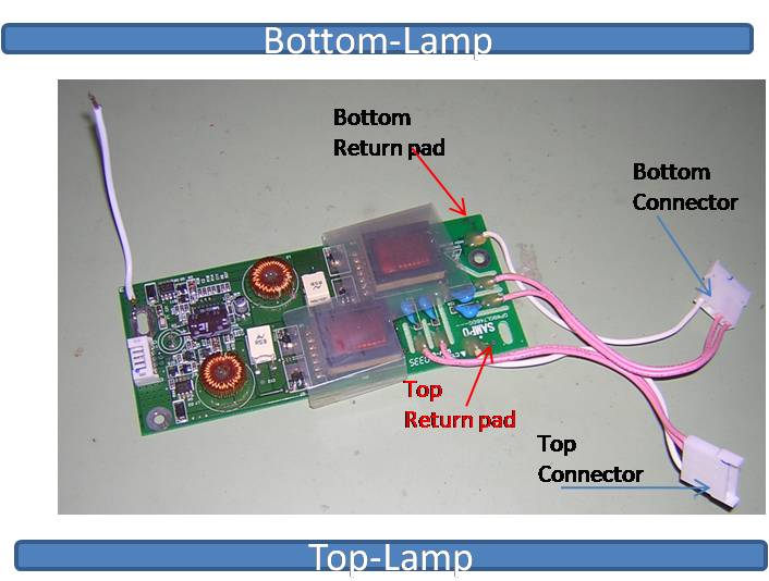

            #45
            Re: Mag 780 LT776S Not working....cap question on inverterboard
            ok. I think my nomenclature on the last post was a little wrong so i am going to re-do the measurements (see below with correct nomenclature):
            Red probe from meter on Vreturn pad and Black lead connected to Vgnd wire.
            Note: See enclosed pic for defn of the following
            Bottom-lamp
            Top-Lamp
            Bottom-connector = connector on invert. board that goes to bottom lamp
            Top-connector = connector on inverter board that goes to top lamp
            Vreturn bottom
            Vreturn top
            Experimental setup:
            Bottom-lamp connected to Bottom Connector
            Top-lamp connected to Top connector:
            Vreturn(Bottom): 3.01V AC
            Vreturn(Top): 2.15V AC
            Experimental setup:
            Bottom-lamp connected to Top Connector
            Top-lamp connected to Bottom connector:
            Voltage values "STAY" with the lamps..........
            Switching the connectors does not change the voltage readings.
            • Welchs101
              • Sep 2008
              • 979
              #46
              In my last post i made this statement
              "Voltage values "STAY" with the lamps..........
              Switching the connectors does not change the voltage readings."
              I dont think this is right. The "return pads" essentialy stay with the connectors.
              Top-connector/Top-lamp: Vreturn top measures return voltage of top lamp.
              Bot.-connector/Bot.-lamp: Vreturn bot. measures return voltage of bot lamp.
              Top-connector/Bot-lamp: Vreturn top measures return voltage of bot lamp.
              Bot.-connector/Top-lamp: Vreturn bottom measures return volt of top lamp.
              The "return" voltages stayed the same as i swapped lamp connector combinations......so as the lamps change the return pad voltages stay the same so the measured voltages follow the board NOT the lamps.
              Did i get this right? I think so......helps to use the picture.
              • PlainBill
                • Feb 2009
                • 7034
                #47
                That is correct; the difference follows the board. Now the problem is to figure out why the voltage reading is different on the two sides.
                PlainBill

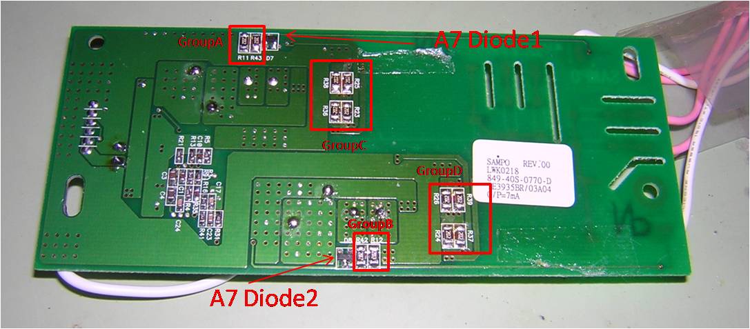

                      #50
                      I am enclosing a pic for reference.
                      The resistors in group A and group B. Each resistor separately measures 0.971KOhms.
                      The resistors in group C and group D. Each resistor separately measures 0.496KOhms.
                      All resistors have the same package marking.....so i dont know why groupA,B are different than C,D.
                      Diode A7:
                      Diode1:
                      Pin1-Pin3 diode voltage:0.45V
                      Pin3-Pin2 diode voltage:0.59V
                      Diode2:
                      Pin1-Pin3 diode voltage:0.52V
                      • PlainBill
                        • Feb 2009
                        • 7034
                        #51
                        Diode A7:
                        Diode1:
                        Diode2:
                        By any chance are the resistors marked 202? If so, they are 2K resistors. It looks like those in groups C and D might be in parallel.
                        Do you have Chip-Quik on hand? That would make it easy to remove the diodes and test them out of circuit. I don't know if the difference is due to a failure of the diode, or further downstream in the circuit.
                        PlainBill
                        • Welchs101
                          • Sep 2008
                          • 979
                          #52
                          Yes, they do have the markings of "202" on them.
                          I dont have the Chip-Quick material......was thinking about getting some because soldering those little guys is "tough" for me anyway. So you would recommend this Chip-Quick stuff.
                          I can remove the diodes if you think i should........but they seem to measure ok.......but i can remove them if you think it would help solve the problem.
                          • PlainBill
                            • Feb 2009
                            • 7034

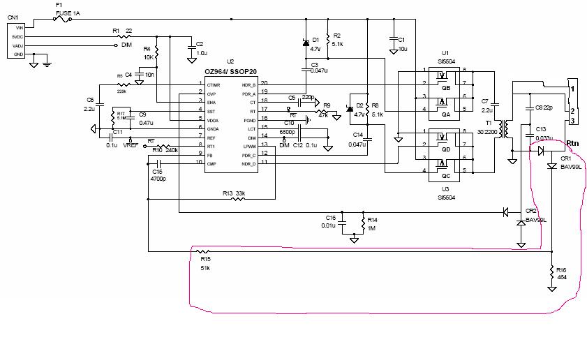

                            #53
                            Chip-Quik allows you to easily remove small surface mount components (or large ones, for that matter) without damaging them or the board. Without Chip-Quik I don't suggest removing the diodes from the board unless you can determine that the outputs of each side (pin 2) are tied together.
                            I've attached a schematic for a theoretical inverter SIMILAR to the one you are dealing with. CR1, R15, R16 form the circuit equivalent to what you are working on. Note that your inverter has two of these circuits. They are identical, you should be getting identical readings, but you aren't.
                            Check if pin 2 of the diodes in group A and B are connected together.
                            PlainBill

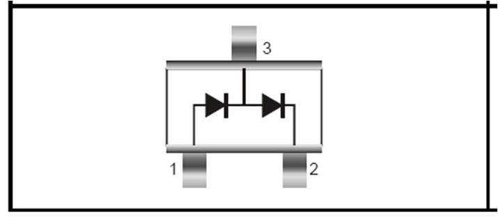

                              #54
                              Resistance from Pin1 of Diode1 to Pin1 of Diode2: 0.3ohm
                              Resistance from Pin2 of Diode1 to Pin2 of Diode2: 190Kohm
                              Resistance from Pin3 of Diode1 to Pin3 of Diode2: 1.975Kohm
                              Just to make sure we are talking about the same pin configuration i have included a pic of what i think the part pin configuration is for this part.
                              So the Pin1's are shorted together.
                              The Pin2, pin2 and Pin3 readings shown above are exactlly the same regardless of how i measure (red/black probes).
                              Does this help?
                              • PlainBill
                                • Feb 2009
                                • 7034
                                #55
                                Does this help?
                                Sort of. What is the pin 1 to 3 RESISTANCE in both directions on the two diodes?
                                PlainBill

                                        I'm of the opinion that the slightly low resistance is caused by either a leaky diode or a problem with the circuitry connected to the diode.

                                          ok. So do you think i should replace the A7 diodes? Or continue searching for other issues on this board?
                                          When i made the measurement in the previous post i was thinking that the low resistance equaled the resistors next to the transistors.....
