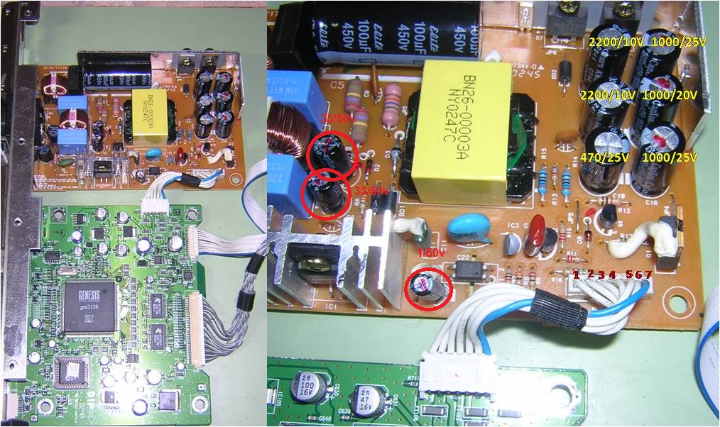

              I don't know if you ever got your E171FP power board to work, but I have fixed twenty to thirty of these power supplies. The problem is always the 50 volt caps I have circled in red.

                Re: Dell E171FP No power
                Hey guys (and gals),
                I just wanted to let you know that I replaced the capacitors that syclonejim was referring to and my monitor is working perfectly after being completely dead. Thanks for your help!

                  #48
                  I have a Samsung 151s monitor with this exact same boards. The Mosfet in bottom right corner was bad (see syclonejim's pic). I haven't replaced yet, as the Mosfet is no longer available (MTP2955V). I will also replace the caps as suggested. I just wanted to add the Samsung monitor to this tread so others when searching for that monitor will come across this.

                    #49
                    Hi, had a similar problem with an E171FP bought on eBay. On first power up there was a pop from the back of the monitor and a subsequent electrical burning odour. It was going to cost me postage to return to seller with no guarantee of a replacement or money back so decided on repair.
                    Opened it up and discovered bulging C5 (100uF, 400V, CapXon) and blown 3.15A fuses on power/inverter board. In addition found bulging 220uF, 25V, Teapo on CFL driver board.
                    Replaced C5 with 47uF, 450V (closest match available from local store) and 220uF caps. Couldn't get PCB fuses readily so replaced with 5A fuse wire links (naughty I know).
                    Monitor now working.
                      #50
                      I replaced all the caps on the power board and the mosfet Q1... monitor is now alive.
