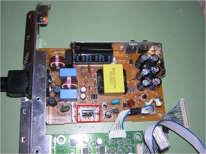

      Ok....I am enclosing a pic ture of the main board with one of the parts surrounded by a red box. Is this the part you want me to measure outputs on?
      I looked up this part (i also took a side view picture of part). The markings are "DP502T". I could not find this part but i did find a web address that mentioned this part.
      http://www.electronicspoint.com/sync...es-t64642.html
      In this web address they say this is a fairchild part similar to this "KA5Q12656RTYDTU ". I found this part on mouser and the datasheet is here
      From the data sheet:
      Pin1=Drain
      Pin2=Gnd
      Pin3=Vcc
      Pin4=FB (not sure what these are)
      Pin5=Sync (not sure what these are)

        That is not just a FET but it is also the PWM IC.
        It is a switching FET, PWM, and protection on one chip that's why it has 5 leads. So it seems that Topswitch isn't the only manufacturer making these anymore.
        Manufacturers use these compact switcher ICs to reduce the part count. All the better because it simplifies the troubleshooting process.
        Measure the secondary voltages as Plainbill said if you get nothing.
        If the bridge rectifier died then there's a chance the PWM section of the chip got zapped through the VCC pin. Sometimes fuses just aren't fast enough to stop semiconductor damage.

                !!!! There are two ways to solve this.
                1. Measure the voltages across the caps on the right side of the board - the six caps in a group. You should get two sets of voltages - one about 5 volts, the other probably about 12 volts.
                2. Measure the voltages on the cable linking the power supply to the logic card.
                The power LED is controlled by processors on the logic card. I spent too many hours assisting people who thought they had a power supply problem when it was actually a reset controller problem.
                PlainBill

                      You're right, 7.71 is very low. Also, 4.11 is slightly low. That points to an excessive load somewhere. Does the inverter connect to the logic card?
                      PlainBill
                      • Welchs101
                        • Sep 2008
                        • 979
                        Re: Dell E171FP No power
                        Yes, it does. How did you know that? I have included a picture for reference.

                              First of all, there are no absolutes with the limited test you just did. A more refined test would involve putting a 2 ohm power resistor across the 5V output and testing the power supply at full load. But the odds are that the power supply is fine, so let's go with that.
                              The next test would be to hook the logic card back up to the power supply, but leave the inverter disconnected. Then repeat measuring the voltage. There is no need to measure the voltage at the caps, measuring at the connector is fine. If the voltages are still 5V and 12V it improves the odds that the problem is in the inverter (Case A). If it drops again, then it is either the power supply or the logic card (Case B).
                              In Case A, hook the inverter back up and carefully feel for any point that is getting unusually warm. I'm guessing that the bad part is dissipating something in the order of 5 watts.
                              In Case B, it is not necessary to hook the inverter up, just check the logic card for any part that is getting very hot.
                              Do this fairly quickly; don't leave the power supply on for more than a minute when the 12V output is down around 7 volts.

                                    Darn!! Maybe it is the power supply. One more thing to check: What is the voltage at pins 3 and 4 of the 'power switch' (the 5 pin device you measured in post 7) with the logic card disconnected and with it connected?
                                    PlainBill
