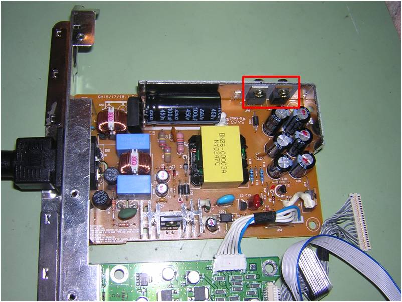

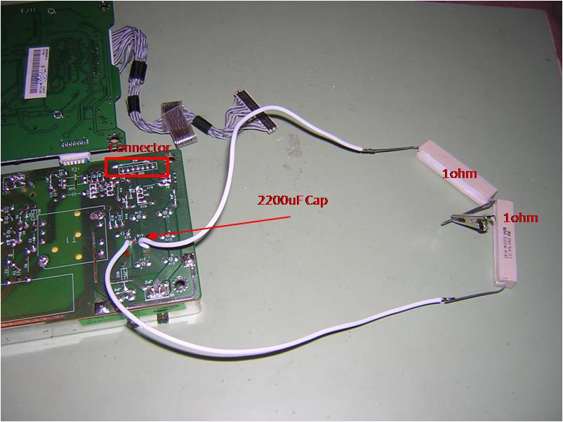

                Re: Dell E171FP No power
                ok. I have the two 1ohm 10watt resistors. They are big.....guess they might need to handle a large current!
                I am attaching a pic to show you how i set it up based on what you had said. Want to make sure i have it setup correctly.
                Procedure:
                1) Make sure power supply board is NOT connected to logic board.
                2) Plug in power cord to power supply
                3) Measure voltages at the connector as i have done in previous posts.
                4) record voltages and post to bad-caps
                Is this the correct procedure?
                  ok. I assumed it was connected correctly and went ahead with what i thought was the procedure.
                  Here are the voltages i measured. Note: Logic board was disconnected. Setup as shown in the previous picture except i decided to solder the two resistors together instead of using the banana clip.
                  Voltages measured at connector:
                  With logic board NOT connected and two resistors in parallel with 220uF cap:
                  At 1: 4.96V DC
                  At 2: 0.089V DC
                  At 3: 0.004V DC
                  At 4: 0.004V DC
                  At 5: 0.004V DC
                  At 6: 26.58V DC
                  At 7(Blue): 26.57DC
                  I was surprised by the 26V DC voltage on pin 6 and 7. Had not seen this before.
                  Any comments?

                    Several.
                    You did a good job. The hookup was correct, and you proved that the power supply is working correctly.
                    26 volts on the 12 volt line is a little surprising; I expected it to be in the 14 - 18 volt range. Obviously, the transformer has fairly loose coupling.
                    I'm not optimistic about being able to repair the logic board. There are also questions about the various outputs of the power supply. If you want to continue I will need good quality pictures of the back of the power supply, and of both front and back of the logic board.
                    PlainBill

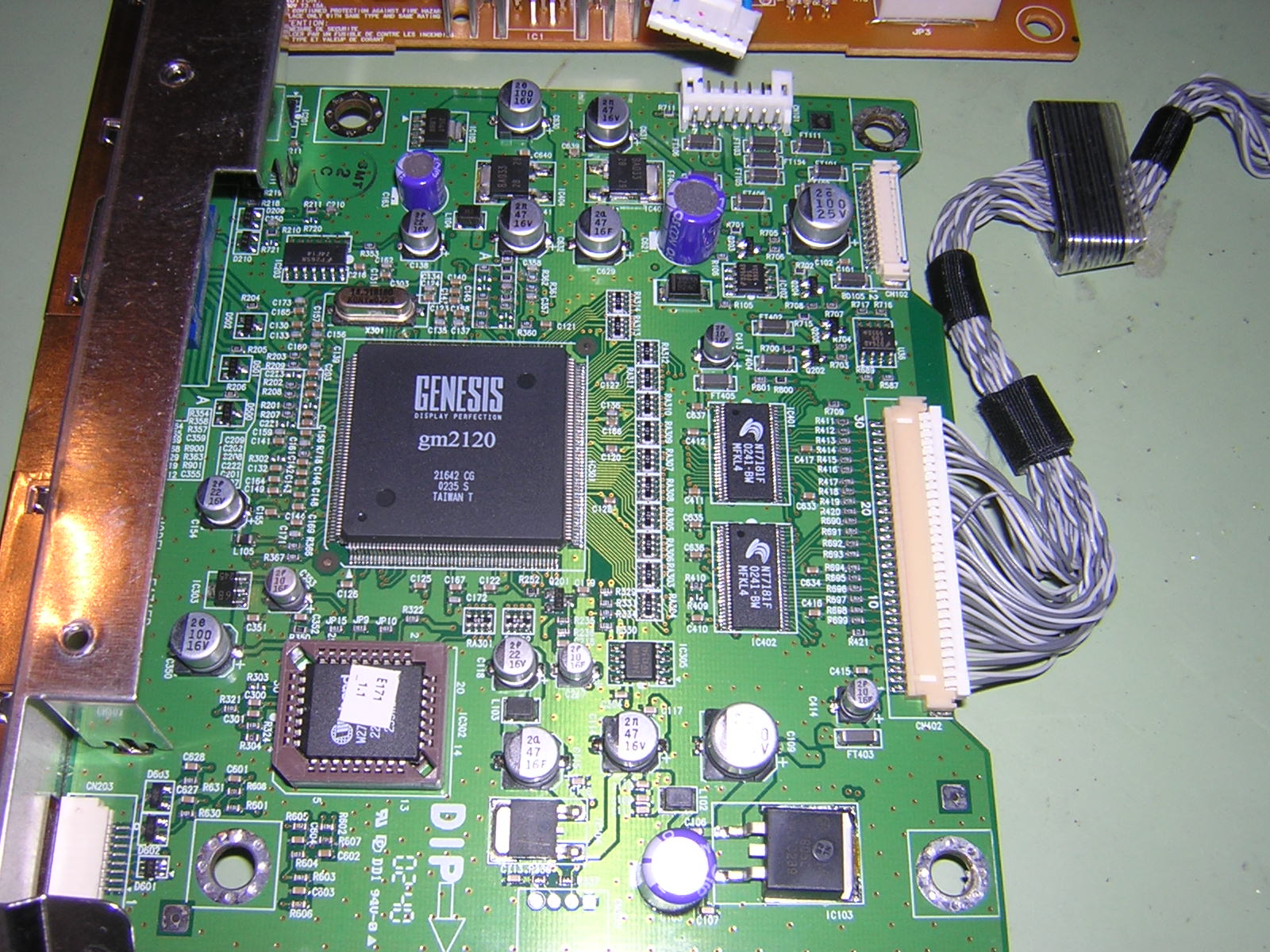

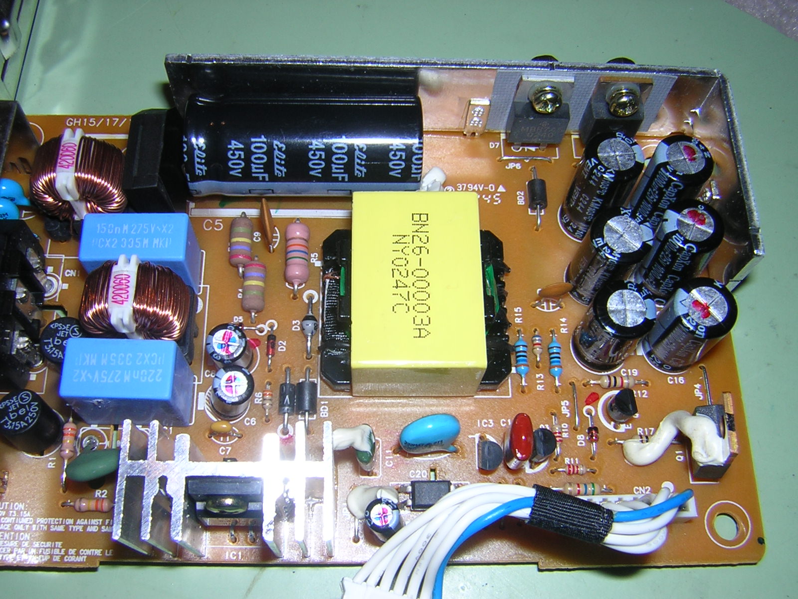

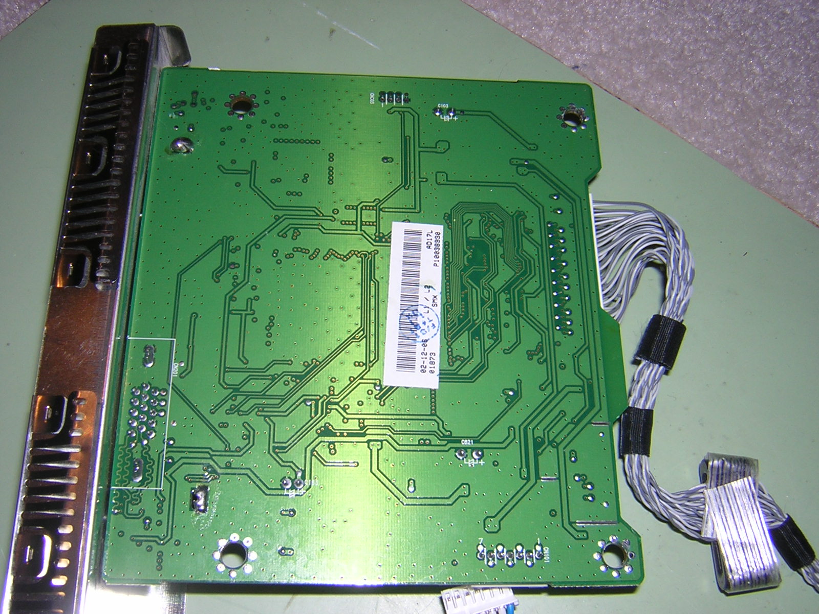

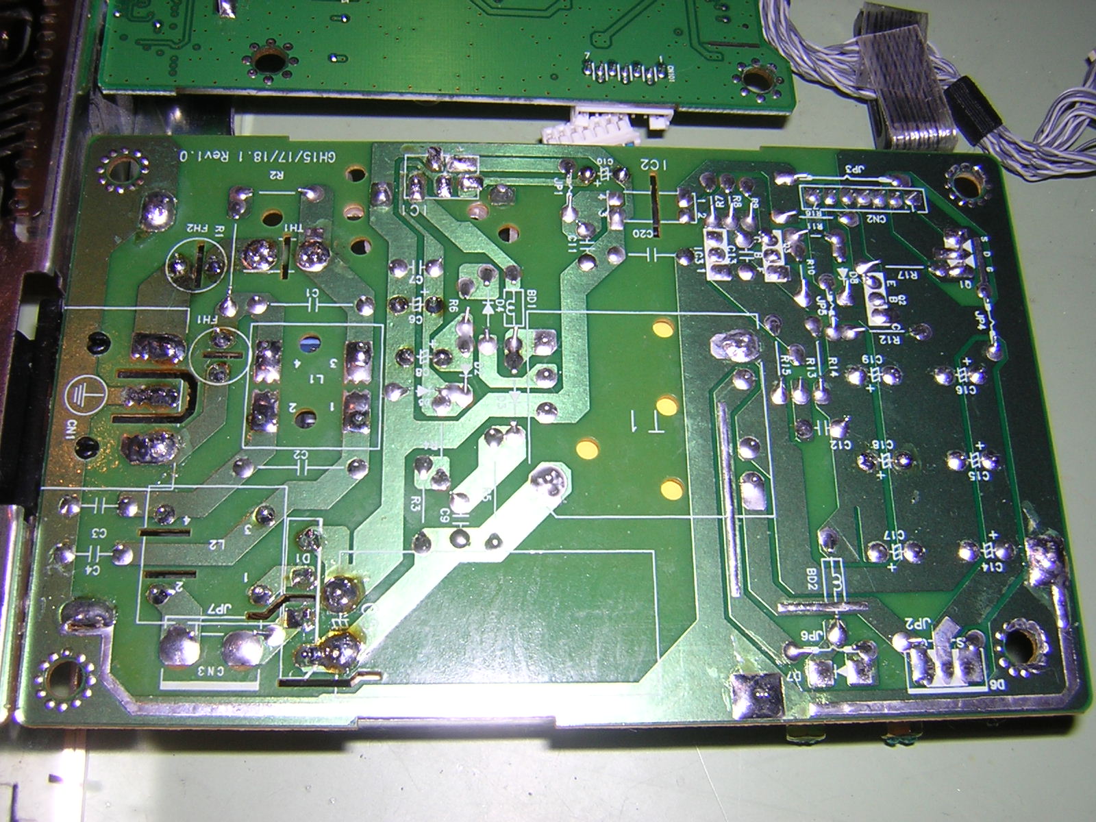

                      I am enclosing what i think are good pics of frnt/bck of logic and power supply board.
                      I wanted to ask you another question if i may. See the pic titled Measure points. There are two devices highlighed in a red box. One of them (on the left) is a two terminal diode, the other is a 3 terminal schottky diodes.
                      When i measure the "resistance" across the diode it starts out around 50ohms and increases. It does this regardless of which probe i put where. I have a video of me measuring it so you can see the multi-meter readings.........is there a way to post this video so you can see it?

                        The voltage increase like that is normal - the meter is charging the main filter caps.
                        On the logic board I have identified 5 ICs. I believe these are all voltage regulators. What are the part numbers of them?
                        PlainBill

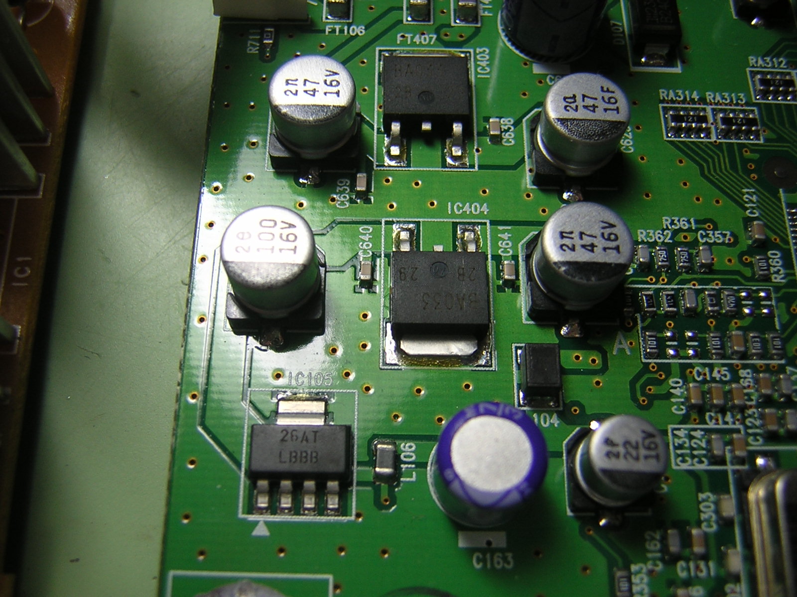

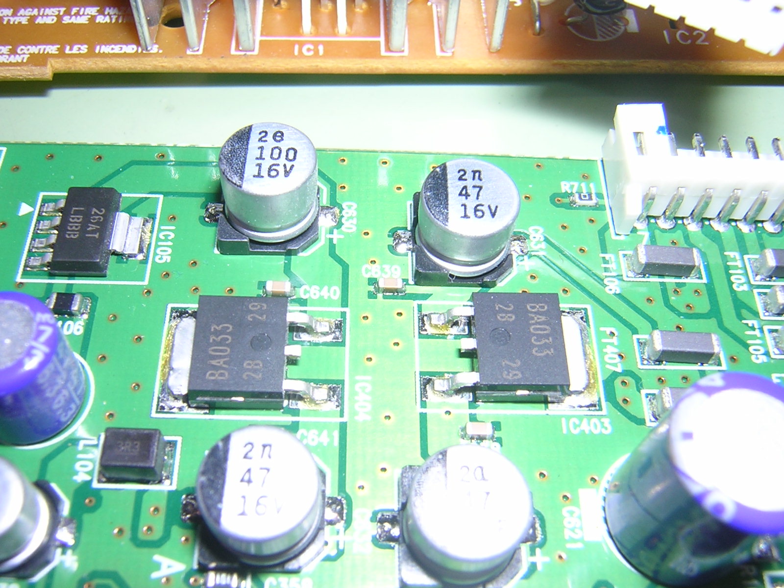

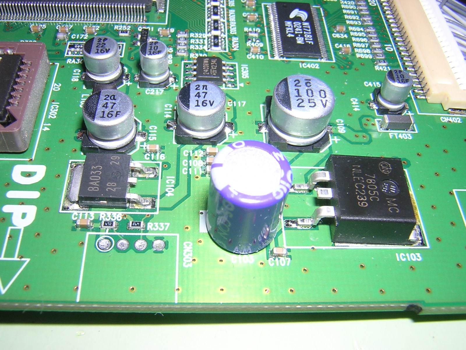

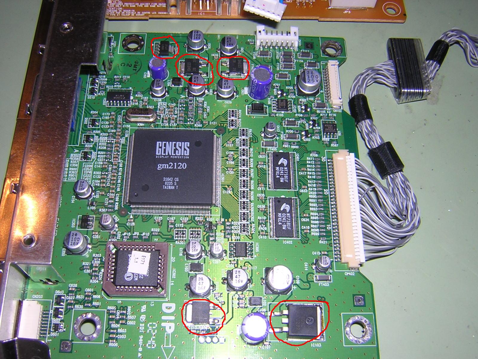

                          I have included pics as well because i am notorius for looking at a partnumber and getting it wrong.
                          From what i can tell with magnifying glass:
                          Part1)
                          26AT
                          LBBB
                          Parts2)3)4)
                          BA033
                          2B 29
                          Part5)
                          7805C
                          NLEC239
                          If this does not answer your question or you need more info just let me know.
                            #33
                            Part1)
                            26AT
                            LBBB
                            Parts2)3)4)
                            BA033
                            2B 29
                            Part5)
                            7805C
                            NLEC239
                            26AT is unknown (Darn!)
                            BA033 is a 3.3V regulator
                            MC7805C is a 5V regulator
                            The four parts identified all have the same input / output configuration. Referring to IC104, pin 1 is the pin closest to the camera; the pin closest to R337. The same position applies to IC103. It is also the input pin. With an ohmmeter check if pin 1 of IC103 is connected to pin 1 of IC104, IC403, and IC404.
                            Another test is to check which pins of the power supply connector are connected to pin 1 of these ICs.
                            PlainBill
