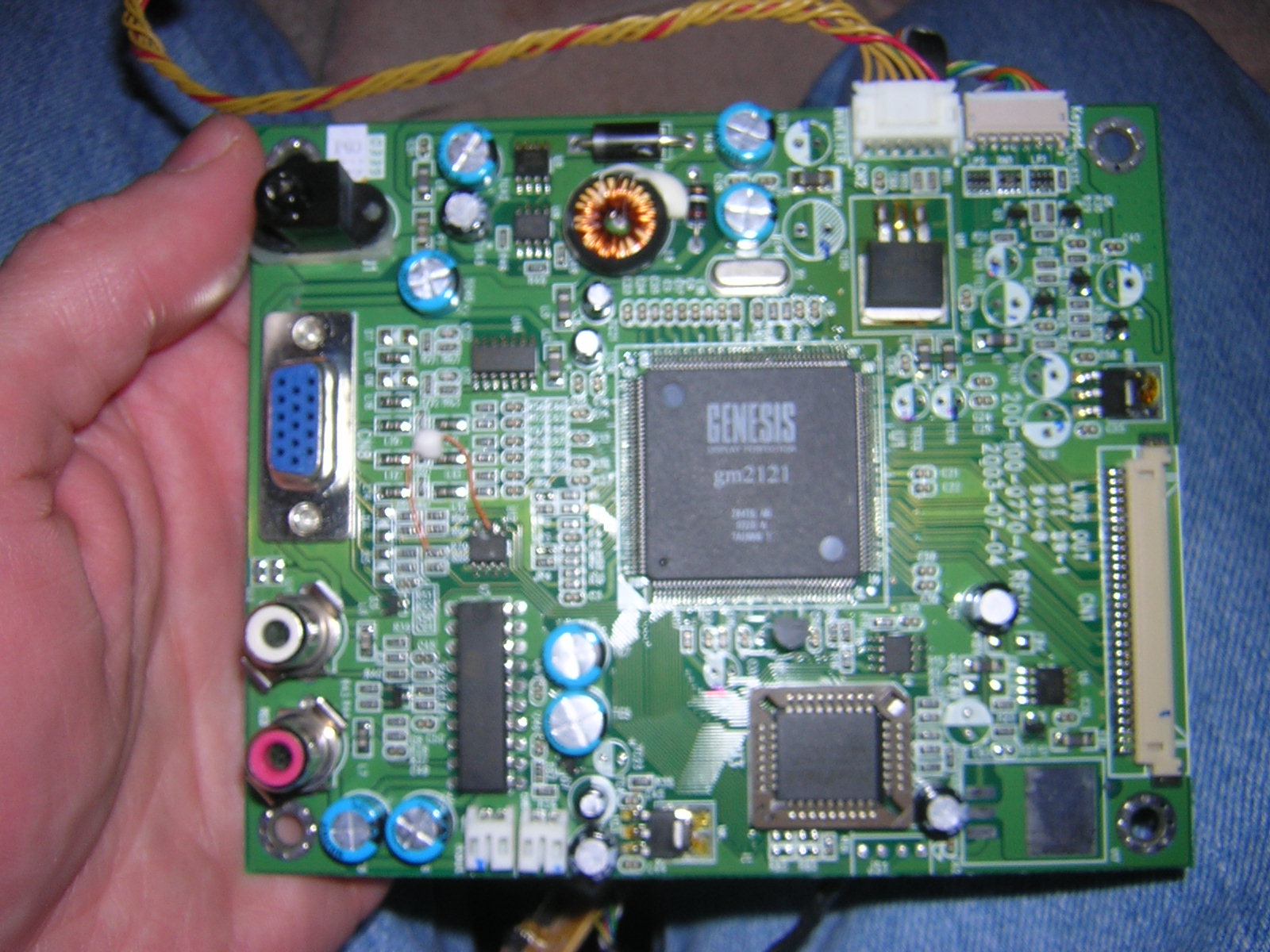

    I have a really small cap
    Diameter: 8.2mm
    Height: 5.71mm
    Any idea where i can find similar caps. The cap in question is a "through-hole" cap. But the only ones i can find which are similar in size are surface mount............not sure how to use a surface mount where a "through-hole" is supposed to go.
    Any ideas?

                      I thought i would show a few pictures of the board which has the caps i want to replace. If you look at the pic the caps i wnat to replace are the "light blue" caps.

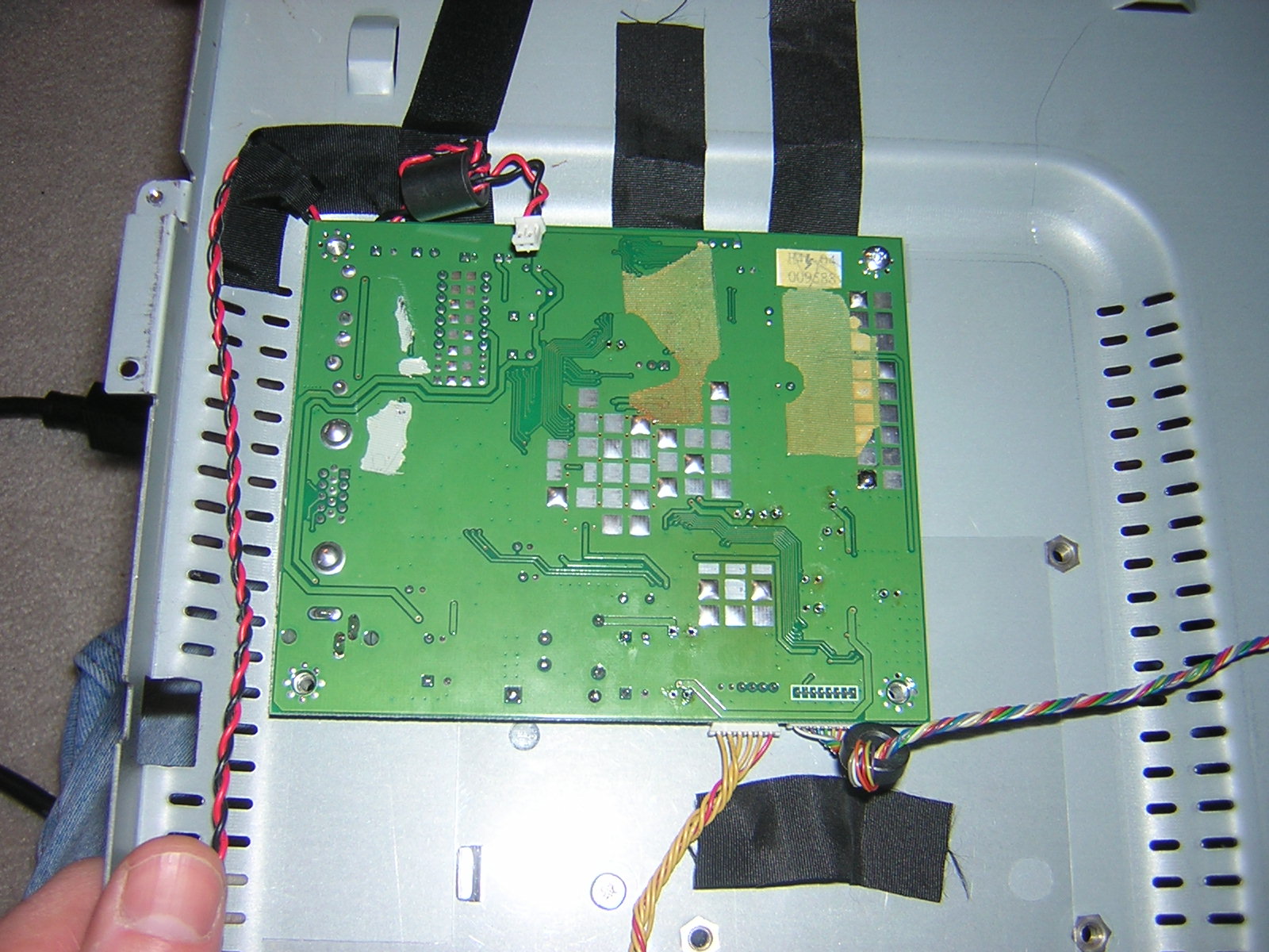

                      I also show how this board is mounted into the unit.

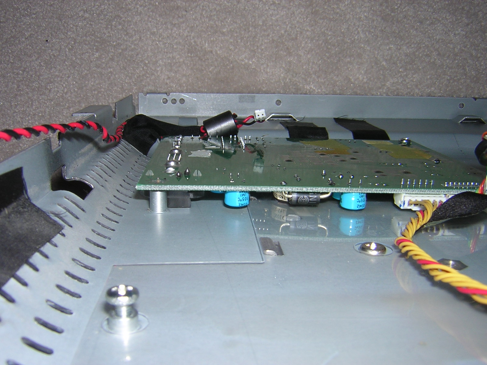

                      I also show (or try to show) from a side view how much room is available.

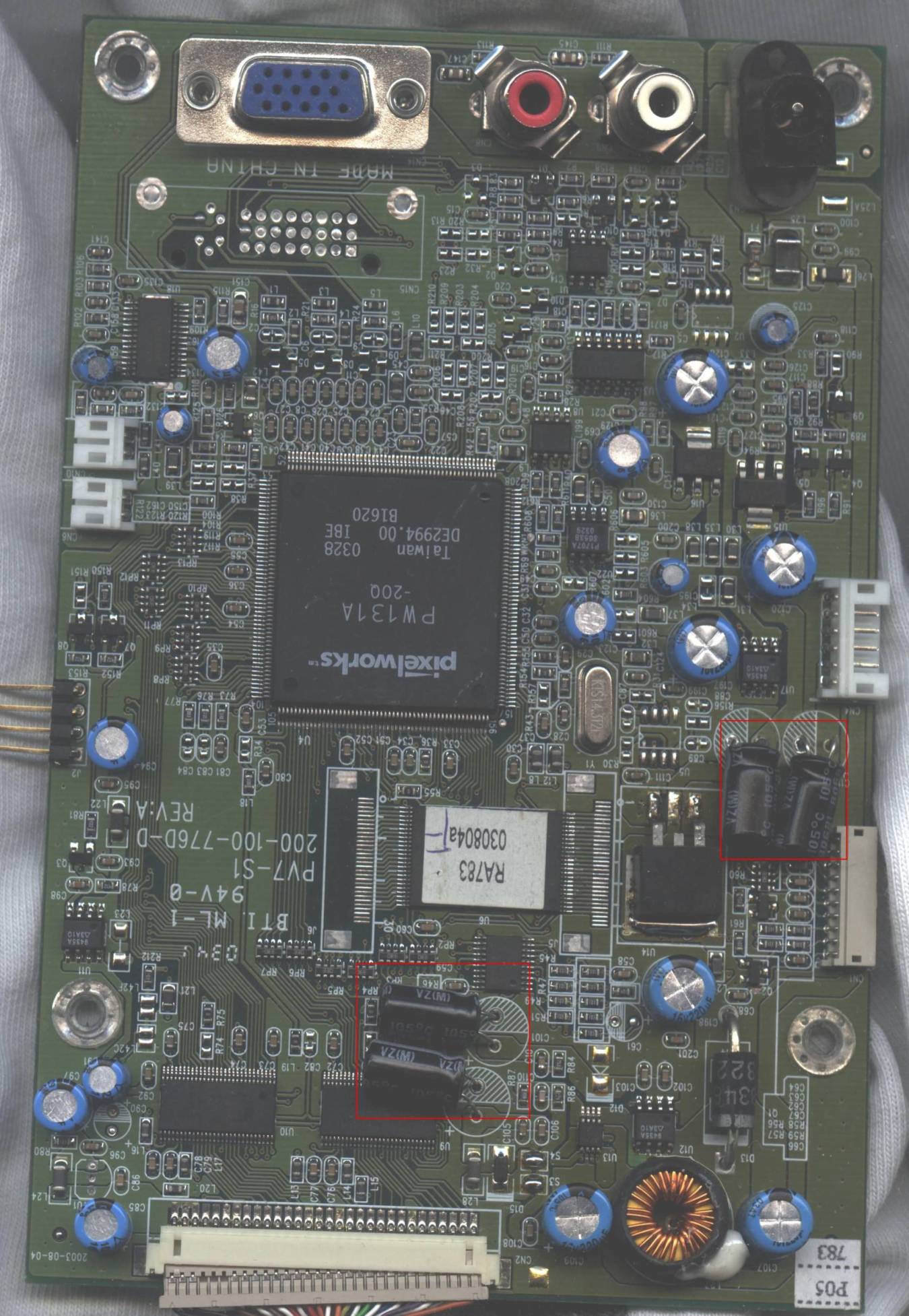

                        this is a Xerox monitor XG-71 or XL370b. I had the same problem. I had to lay down the all caps I replace (6.3 x 11) I know I'm repeating the same information again.
                          Re: 220uf/16V small cap.......where to find replacement
                          This is froma Mag 780 monitor
                          Can you indicate how you laid them down.....cause i dont see it. I must be missing something simple.

                                OK, HERE is a picture of my XG-71D video board. I had the same problem when replacing those low profile caps. I search everywhere but no luck. So decided to lay down the caps as picture. I install the board with into the casing with no problem.
                                hope this help

                                  the pic helps! thanks. I think i can do the same except for a few locations. But thanks a lot.
