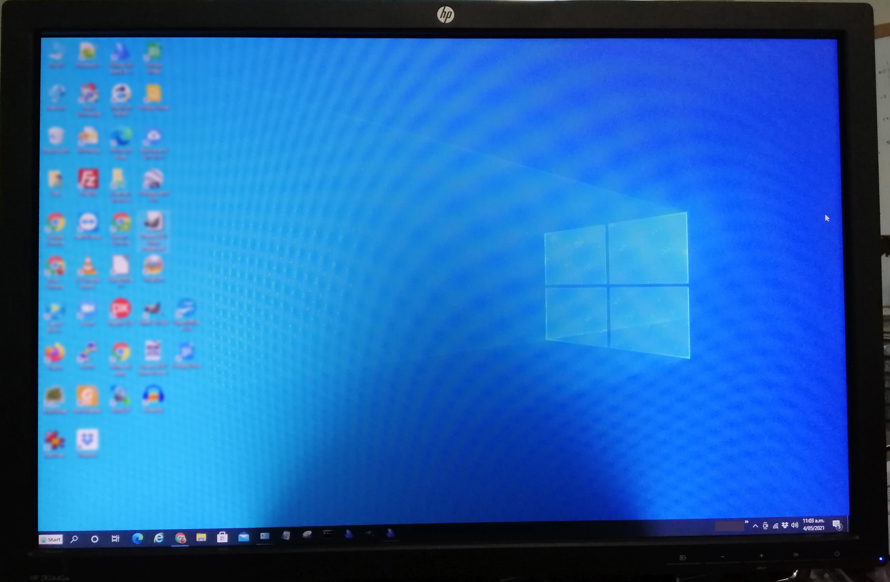

    I have several of these around the place and I like them, mainly because they run cool, which I figure translates into a longer life. Anyway I have one that has developed a dark area on the screen (see pic). I assume that this is due to a failure of some LED strip in the panel.
    So my question:
    Assuming that a dud section of LEDs is the problem, does anyone have any experience with replacing these?

      Hi, thanks for the reply. I had seen that post, but it seemed to deal more with capacitor issues, which I figured was unlikely to be the cause as that fault would tend to affect all the LEDs.
      I saw somewhere (I think) that these panels are put together in such a way as to make replacement of the LEDs difficult and I was looking for someone who could advise about that before I strip the thing down.
