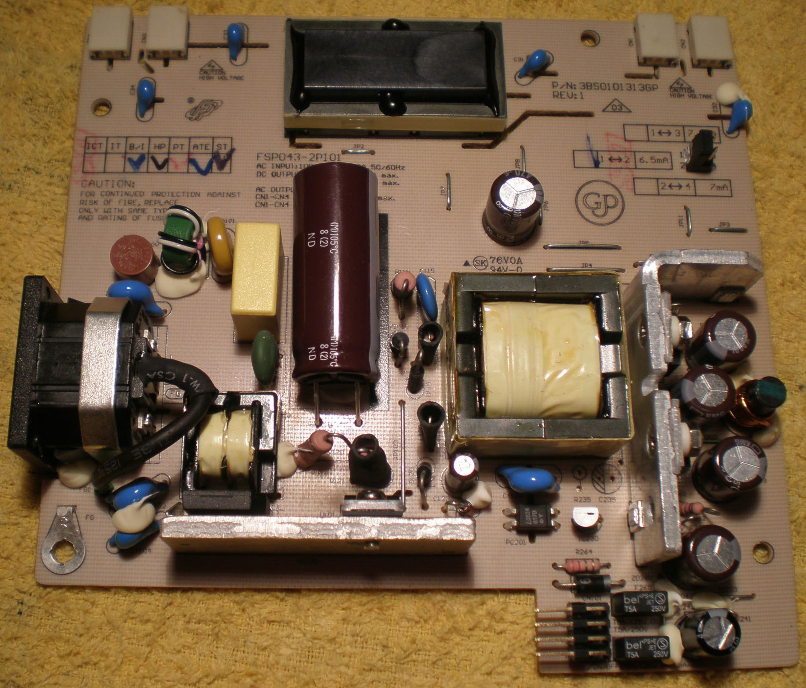

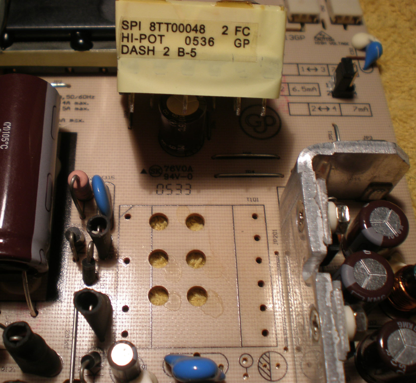

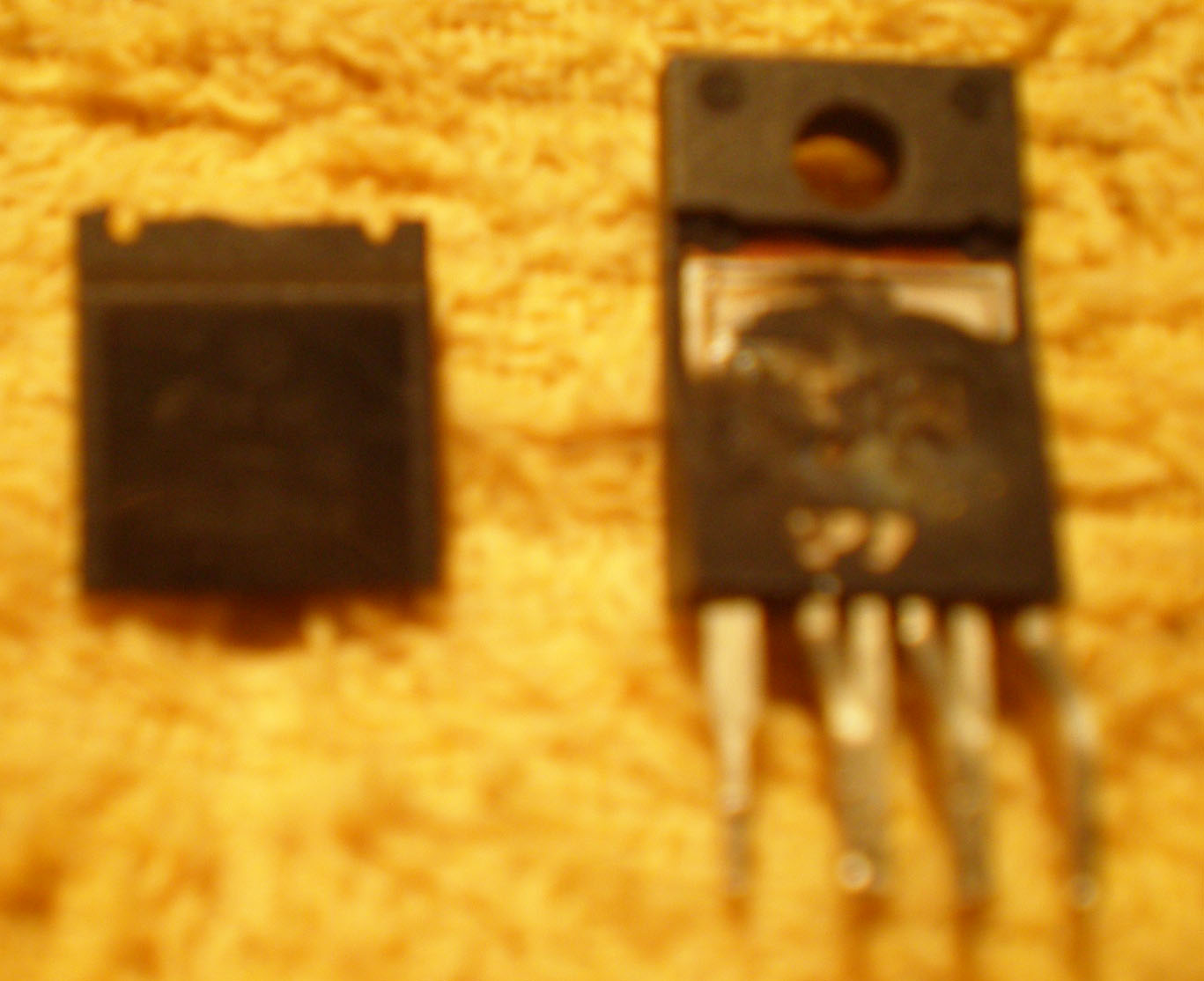

    I had my ACER AL1916b blow up on me the other day and ever since have been trying to repair it. So I've been doing a fair bit of reading on the forums and followed the advice given to others, but unfortunately struck a dead end.
    Basically the problem began with a bang that almost knocked me out of my seat. The LCD immediately switched off and couldn't be turned on anymore. I inspected the power board and noticed some bulged caps (CapXon) as well as the mos-fet chip (FSDM0565r) which had been blown apart (see pics which are all post-cap replacement). It took me a few days to find the rest of the chip as shown in the picture
    I swapped all the caps on the board for new ones and also put in a new mos-fet chip.
    However the monitor is still completely dead. I then checked voltages across the power board and noticed that the input side is apparently working well. There is 330V through the 400V capacitor. But there is no power at all on the output side after the transformer.
    Therefore I suspect the transformer has shorted, which might explain why the first mos-fet exploded, although I don't understand why it didn't also blow the new one ive installed. The pins of the primary winding give a resistance reading of 0 ohms, as do the secondary winding pins.
    Any suggestions on what to try next, or any other ideas in general?
    I've tried looking for a suitable replacement for the transformer but it is hard to find.

    While it is possible the transformer is shorted, that is unlikely. I would check my soldering work, then check the datasheet for the FSDM0565r and see if the voltages on the pins are reasonable. Also check if the diodes are shorted, in particular the one on the winding which provides running power.

      check the 3 fuses and all the pink resistors.

              Good News!
              I finally got around to replacing the two zener diodes and the monitor is back to life. Thanks to those who helped and the badcaps forum in general.
              An interesting note. A few weeks before the monitor crashed I noticed an unusual white blurring in the top left corner of the screen. Now that the monitor is repaired the blurring has disappeared.
              The transformer now makes a whining sound that goes when the screen comes on. It may have done this before the repair.

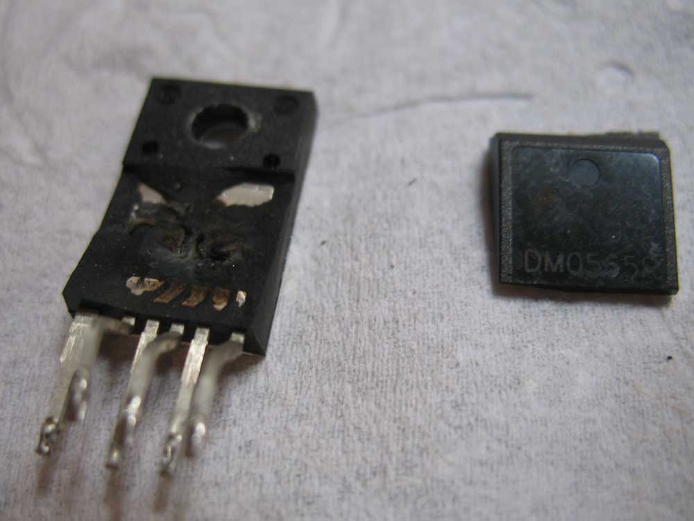

                I have the same issue...
                All the caps except the big one have been replaced in the past, when this monitor was in warranty repair, and they are all good.
                The FET (U101) blew up (blew half of it off, exactly like in OP's post), and also the 10V and 22V Zeners around it blew (ZD121, ZD120).

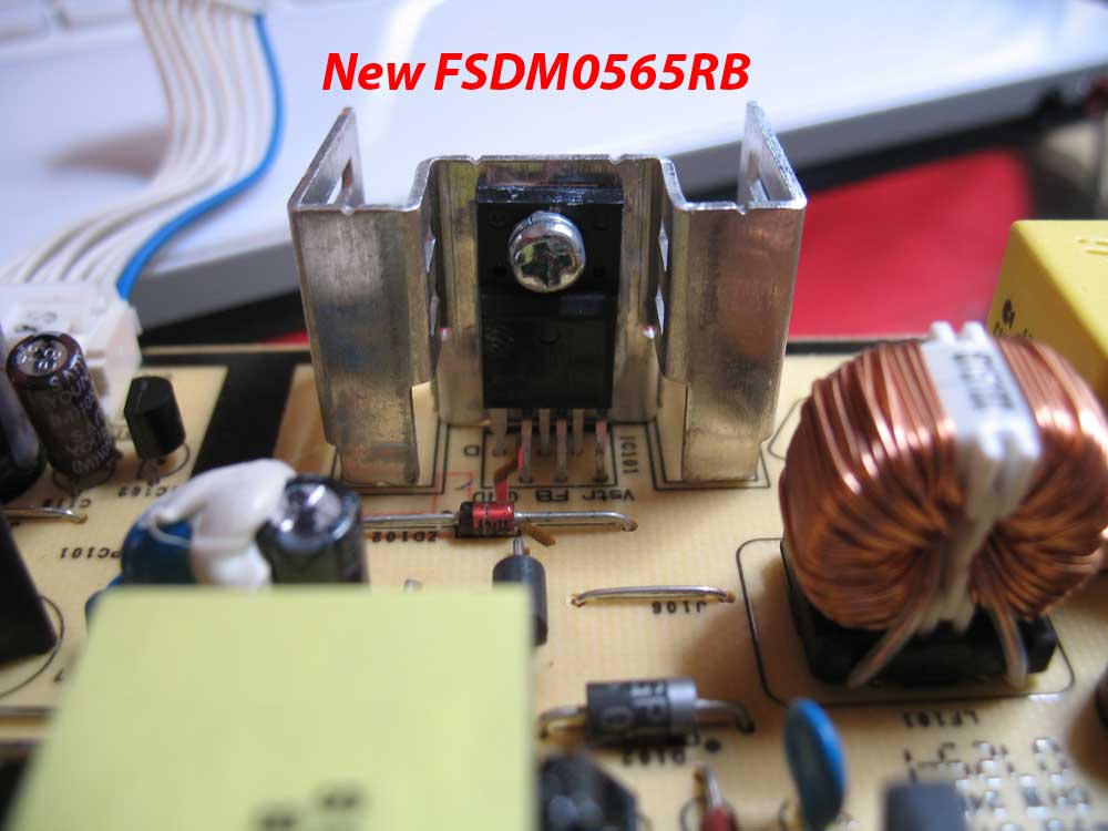

                I replaced the FET (FSDM0565RB) and the diodes (10V and 22V 1W).
                Now the monitor powers up fine, but after a little time it starts power cycling.
                Turns out the FET gets very very hot and enters thermal shutdown... the heatsink is also very hot (I applied thermal grease, so it's not a head conductivity problem).
                Any ideas what else to look for? What to test?

                  I would suspect every semiconductor, cap, and resistor associated with the gate drive on the FET.

                          ARGH!!! Please don't post images inline!! It REALLY creates problems when responding to a thread. Instead use 'Manage Attachments' below the text entry area.
                          In the datasheet schematic, it's C104, D101, and R103.
                          In the power supply schematic it's C115, D110, R113, R114, and ZD110.
                          I would say that you would have real problems testing these properly. They are operating at voltages and currents that most test equipment cannot simulate. If the resistors read the correct value they are most likely good. As for the cap, diode, and zener - who knows? If you have a parts list, I would suggest taking the shotgun approach and replacing the complete set of parts.
                          However, please note Rtech's comment. Are you sure you have received the correct part?
                          PlainBill

                                You were right.
                                On my board I do not have a separate R113 and R114.
                                I have them as one resistor - R113.
                                And measuring across that resistor measures 0hm both ways.
                                That means either ZD110 is shorted, or R113 and R112 are both shorted.
                                I suspect the diode. I will desolder the components and see where the problem lies.
                                Thank you!

                                    I verified R113, it reads the correct resistance.
                                    Changed ZD110 and D110.
                                    Still the same.
                                    Turns on and starts cycling because FET overheats.
                                    I did not replace C115... it is a ceramic capacitor...
                                    Although I noticed that when I flex it back and forth on the board I hear a sound like something is cracking slightly, none of the other caps do that.
                                    Perhaps I should replace C115 as well...
                                    But at this point, I pretty much feel like giving up. I don't see myself repairing this board.

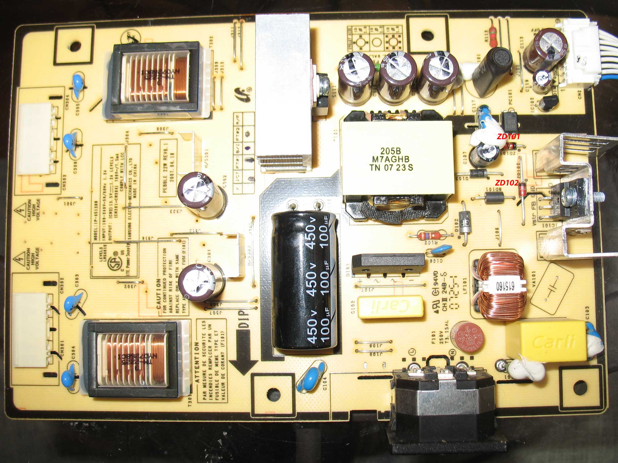

                                    • neclicpasici
                                      • Aug 2011
                                      Re: LCD fried - transformer to blame?

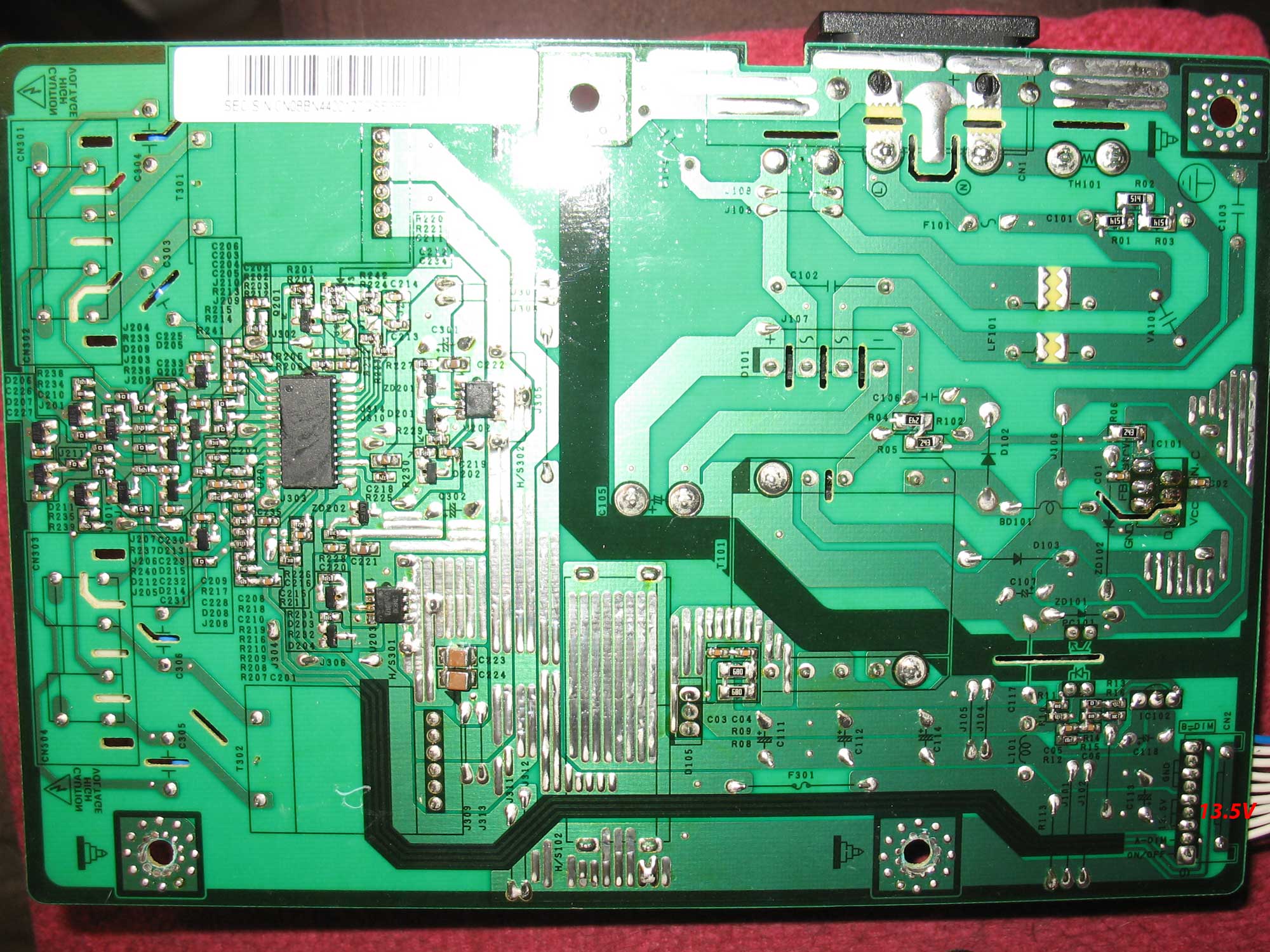

                                      I had the same problem (a big BANG!) but on a different screen (Samsung 2232BW)
                                      It has the same MOS-FET chip (FSDM0565r). I replaced it, but the screen was still dead.
                                      Then I read your discussion, and I observed that my power board was very similar to your power board.
                                      I did not have 13.5V at the output of this card.
                                      So I replaced ZD101 and ZD102.
                                      Now the screen works perfectly!
                                      Thank you!
                                      Sorry for my English
