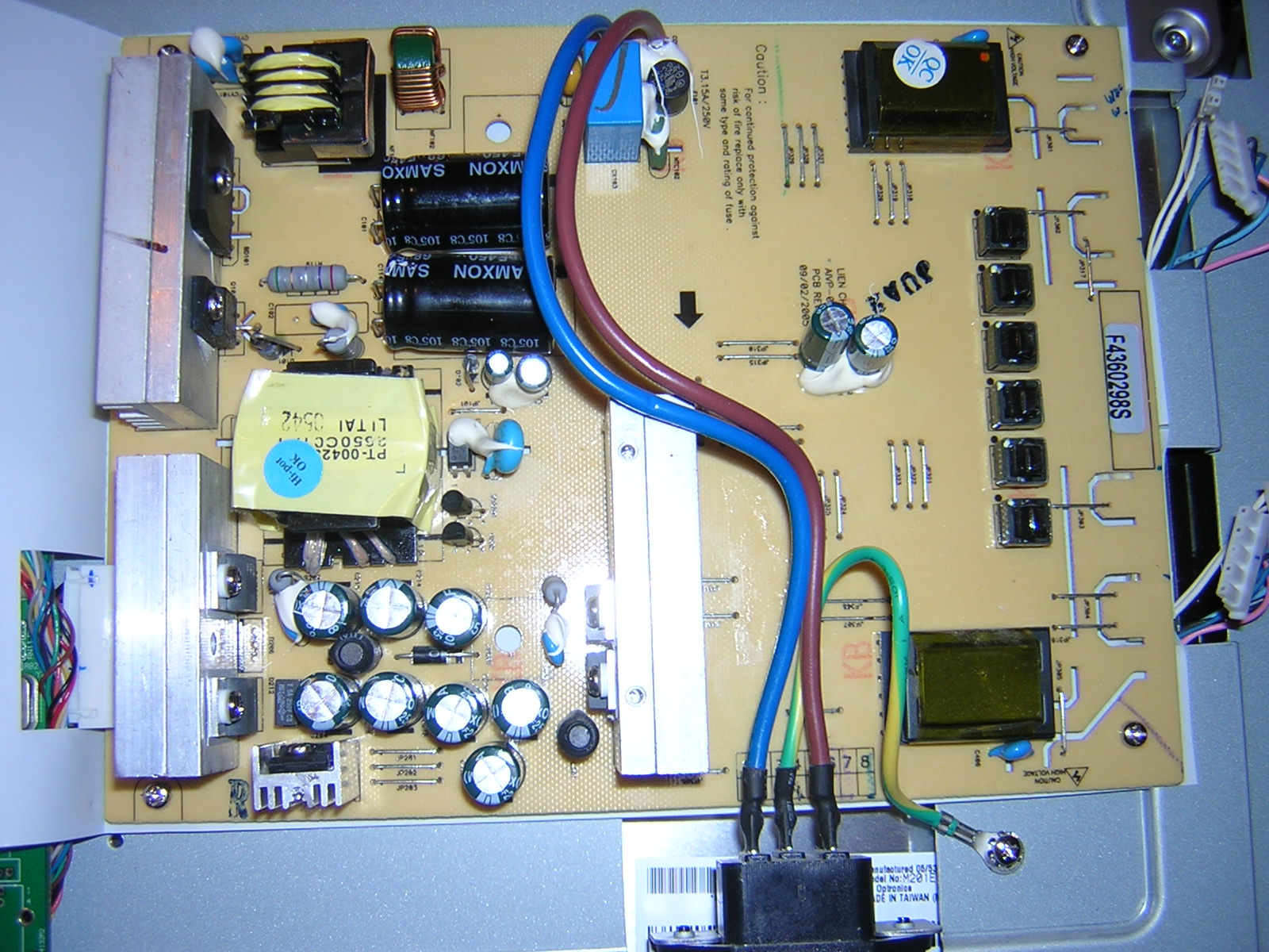

              These caps came off a power supply board from an lcd monitor. Does this help?

                What is a PFC circuit?
                Power Factor Correction. It's a 'front end' often found on LCD and plasma TVs. I don't think they would be used on a normal (< 24" ) monitor, but why not post pictures of the monitor and we can be sure.

                  here is a pic of the power supply board.....is this what you wanted?
                    Yes. And to my untutored eye, they just used a pair of caps in parallel to reduce the height of the assembly. No special low ESR caps required. Still, an ESR of 85 is WAY too high.

                      Re: How to determine ESR from datasheet for SAMXON 68UF/450v
                      Then this one does not utilize PFC. Cap away.
