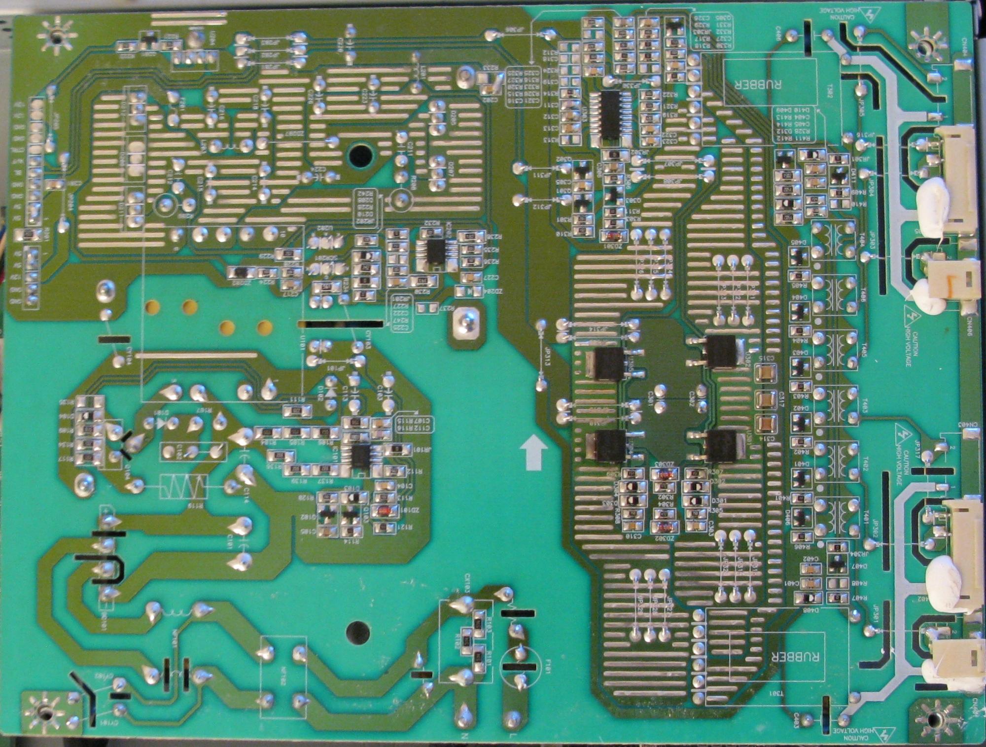

    Hi again everyone! Finally got around to cracking open the dead (no power light at all) Gateway, and recapped all of the 220uF and 470uF SamXons. It still doesn't fire up -- there are no 5V or 12V outputs. When measured, it fluctuates between 0.5VDC and 1.2VDC or so on both lines.
    Measured input voltage, steady 119.5VAC. The big boys (68uF 450V) measure 165VDC. Measured IC101 (identified as 200A6) pin 6 measures at 8VDC and pin 8 at 150-160VDC, which brings me to the power supply caps C103 (47uF 25V) and C113 (10uF 50V). These were not replaced in the first round, but parts are on order and should be here in a few days.
    Are there any other tests that will help diagnose in the meantime? U301, U302, U304, U305 on the bottom side (identified as AOD405 and AOD408, two each) have scorched the PCB pretty good, but not sure if there's damage. What's the best way to test these? Thanks!

    Thanks for providing the documentation. That makes it easier.
    That fluctuation can be caused by two things. The most likely is a defective cap on the Vcc pin if the SMPS controller (pin 6). This is particularly likely because it appears they may have used a tertiary winding on the SMPS transformer to provide power for the SMPS controller. The other possibility is excessive load on one of the outputs. A simple ohmmeter test is the best way to check for that. Oh, a reversed cap would also do it.
    As far as the inverter driver transistors, check them for shorts between all three terminals of each device. This can be done in circuit.

      Thanks PlainBill. I'm assuming the cap you are referring to on the Vcc pin would be either C103 or C113 (the ones that I am replacing)? I'll have to wait until the replacements arrive to test that aspect.
      I saw in another posting (same monitor) where you were giving instructions on testing the inverter driver transistors. I will fill out the table for both continuity and bad junctions and report back later (wish I could bring this stuff in to work!).
      I also neglected to mention that I have the main board disconnected at this point since it doesn't seem to respond to the power button. Should I reconnect it for any tests requiring voltage measurement? I seem to remember a discussion in another thread about some power supplies needing a load in order to start up.
      Thanks again for all of the help, I'm learning more than I ever could imagine and having fun doing it!

          It's always a good idea to have some sort of a load hooked up. In general a SMPS requires a load of at least a 10% of rated capacity to be stable.
          In spite of other's opinions, shorted diodes on the output of these power supplies are quite rare. Bad caps are much more likely. A shorted diode would result in one output not even twitching. I don't think it's the inverter transistors, but they are easy to check.

            Update: Inverter transistor measurements.
            Code:
            Continuity test (200 ohm setting)
            Transistor  G – D D – S G – S
            U301 (AOD405) OL  OL  OL
            U302 (AOD408) OL  OL  OL
            U304 (AOD405) 32.9 0.04 33.0
            U305 (AOD408) 5.3  0.9  4.9
            Bad junctions (diode test setting, black on first lead, red on second)
            Transistor G – D G – S D – G D – S S – G S – D
            U301    OL   OL   1.303 0.571 0.970 0.628
            U302    1.331 0.938 1.794 0.565 1.715 0.629
            U304    0.033 0.033 0.033 0.000 0.033 0.000
            U305    0.005 0.005 0.005 0.005 0.005 0.001
              Re: Gateway FPD2185W
              Either I've forgotten everything about basic electronics, or this board is totally hosed (or both!). Measuring the diodes on the board results in the following:

                      u304 and 305 are shorted!

                          Absolutely right -- probably obvious to most everyone here (but me) based on those measurements, but it took several weeks of poking and probing (and asking an expert privately). Once these two inverter transistor leads were clipped (U304, U305), voltages stabilized to the main board at 5V and 12V. So PlainBill was right waaay back in post #2 about the excessive load (transistor short) shutting down the DC voltage.
                          Just in case anyone else runs into this with theirs, all four transistors were replaced as follows:
                          U301, U304 (AOD405) -> AOD417; Digikey P/N 785-1106-1-ND
                          U302, U305 (AOD408) -> AOD484; Digikey P/N 785-1114-1-ND
