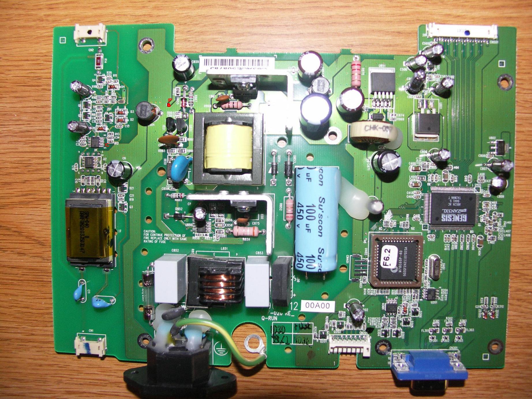

    Hello everyone. I have a dell E153FPf monitor that decided to stop working. I did a search and didn't find much info on my monitor that has the all in one board like the link below.
    click here for picture
    The monitor turns on and has a solid green light but the backlights don't turn on. The backlights never flicker on at all. The capacitors looked good but I swapped the large ones out anyway and I re-soldered every joint on the board. I am not sure if it is worth replacing the little 47uf/16v caps as well. Nothing changed with the new caps and re-solder job. The main fuse (T2A/250V) looks to be good as well. This is where my limited abilities end and I look to consult others. I don't see anything obviously damaged so I need so help on where to start checking things out.
    I included two pictures. The back of the board has a little bit of rosin that needs to be cleaned up but no burns, dark areas, or cracked joints. The top looked normal to me but maybe someone will catch something.
    Thanks.

    It's a little hard to tell anything from those pictures. Try this: https://www.badcaps.net/forum/showthread.php?t=1868 There may be a fuse between the 12V supply and the inverter.
    PlainBill

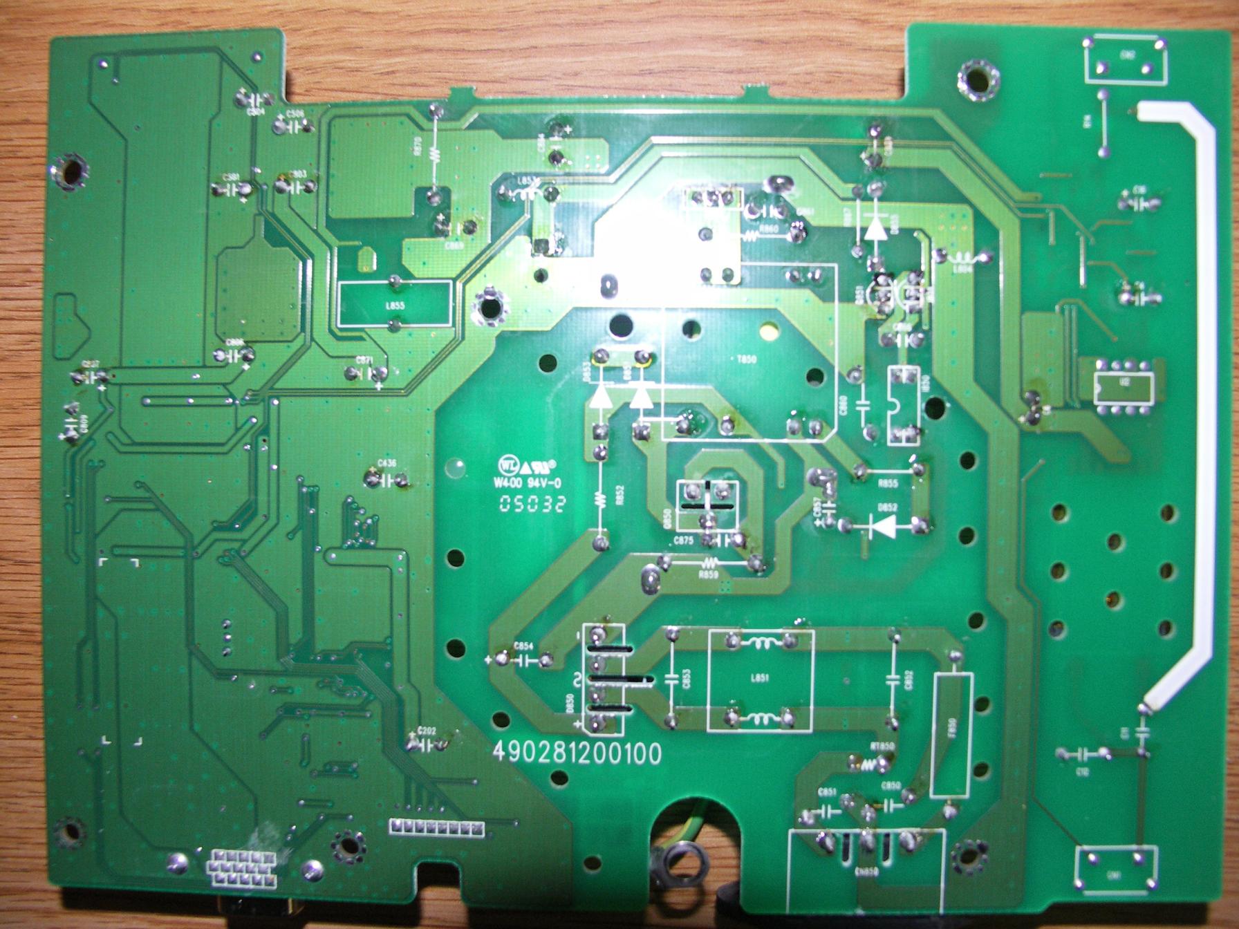

        Hopefully better pictures....

          Much better, thanks. This design makes troubleshooting a lot more difficult, but here's a try. First of all, you didn't explicitly state that the power LED responds to the power button.If it does, continue.
          Next, hook it up to a computer and verify that you can see the desktop (or other computer generated display) when a bright light is shined on the screen. If you can, you definitely have a backlight problem. Again, continue.
          These tests must be done with the power ON, and preferably the monitor hooked to a working computer. Please be very careful, while it is unlikely you would get a fatal shock, it could jangle your nerves.
          On the bottom of the board I have labeled two points 1 and 2. These should be the On / Off and brightness signals from the the display controller on the other end of the board. Try to measure the voltage on these points relative to ground (the mounting hole above and to the left of the points). Try this with the power LED on, and again with it off. Also, there is a heavier trace also coming from the display controller. What is the voltage on that point? And rounding out the bottom of the board, there is a very heavy trace just to the left of PS, 1, and 2. That appears to be the supply for the inverter drivers. What is the voltage there?
          Now for the top of the board. Just to the right of L804 is a point I have labeled IP and marked with a red circle. What is the voltage there? And lastly, I have marked U1 with IC in red. That is the Inverter Controller. What is the part number?

            Sorry, had a bunch of stuff come up.
            1. Power LED responds to power button. Works like normal.
            2. When hooked up to a computer the image is displayed on screen like normal but no back light.
            3. I am not sure if I am doing it right but I received no readings using my multimeter on the spots you highlighted. Front or back. I put the ground on the empty screw hole and the positive in the little hole. Nothing...... Tried ac and dc with monitor on and off. Zip. Like I said though, I am probably doing something wrong. I will try again tomorrow just to be sure.
            4. ic is:
            0Z9RRAC <- or G not sure
            0452A1
            42114912
            Thanks.

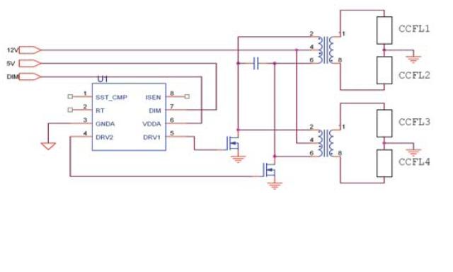

              1 and 2 are good news. You have a backlight problem.
              We will have to investigate the problems measuring a voltage. It would be nice if there was no voltage to measure; power supply issues are easier to troubleshoot than inverter issues.
              The inverter controller appears to be OZ9RRAG, but other than a notice of patent infringement, I have had little luck finding information on it.

                The OZ9RRAG and the OZ9930 is the same chip. I have seen these chips on Dell E177FP and swap the two to confirm that they are indeed the same chip. So I confirm that the OZ9RRAG and the OZ9930 work when I swap either chip from the inverter circuit. I also made measurement to confirm and noted pin out on both during operation. But there is very little data on the OZ9930 too. But I have a pin out of the OZ9930 I will post later in the evening
                Hope this help

                  Tried it again and got results. I had to hold the tips just right to get a reading.
                  1 = 3.30v dc on and 0v dc off
                  2 = 3.30v dc on and 3.30v dc off
                  PS = 5.02v dc on and 5.1v dc off
                  Thick trace = 12.24v dc on and 12.24v dc off
                  IP = 12.24v dc on and 12.24 dc off

                            sorry for the late post. here what I have on the oz9930 pin out
                            Hope this help
                            ecking767

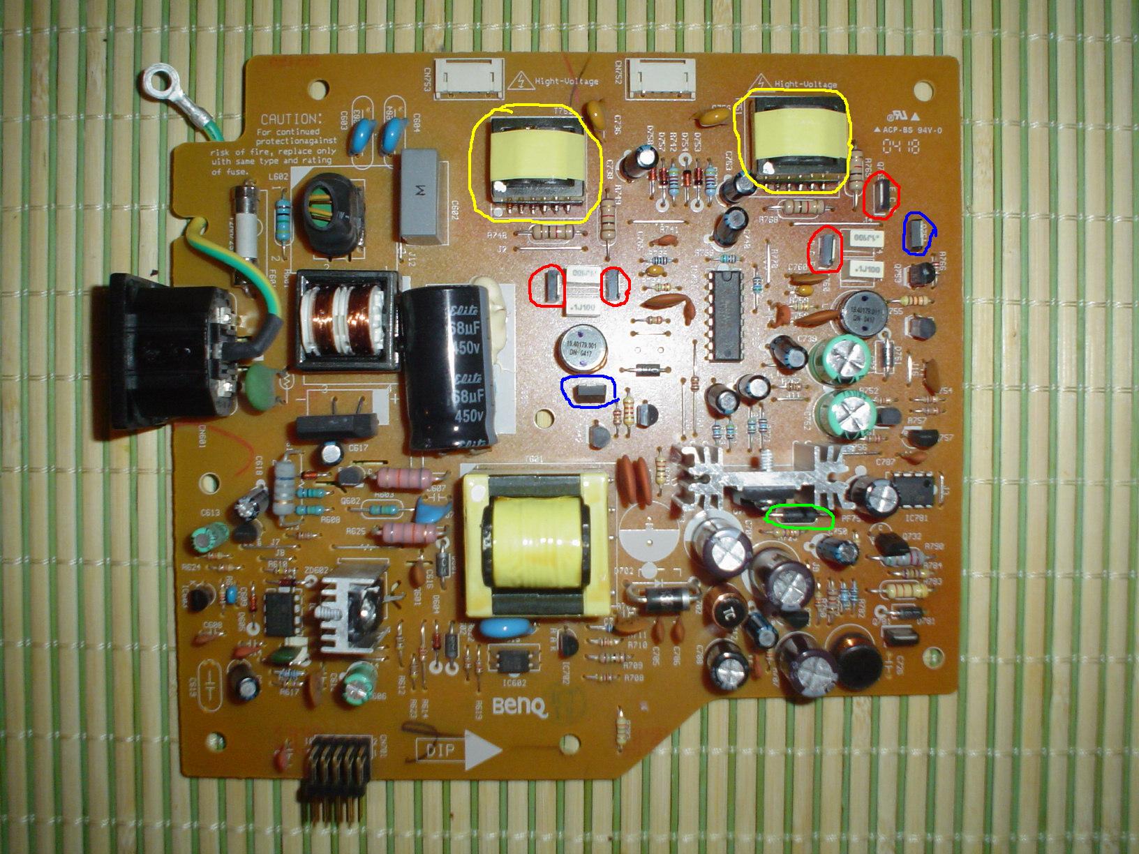

                                        You must apply the same repairs we suggested to Maluko75. I have attached a corrected picture.
                                        RED circles 2SC5706 or 2SC5707. Test; if shorted replace with 2SC5707.
                                        Blue circles FU9024N. Test, if shorted replace with FU9024N.
                                        Green circle 3 Amp Picofuse. Test, if open replace with 3A, 125V picofuse.
                                        Yellow circles - resolder all pins on the transformers. This is very important.
                                        A complete kit of parts is available here.
