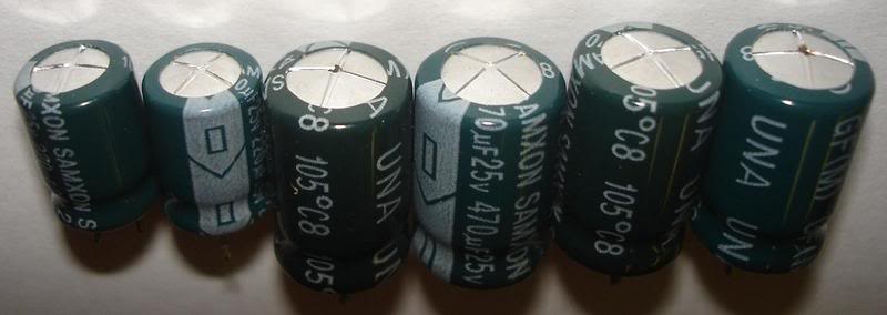

          Originally posted by weirdlookinguy
          My December 2007 (bought in January 2008) Flatron L196WTQ-BF has Samxon GF in it.
          Samxon GF are CRAP replace them on sight. I've had plenty of Gateway LCDs with nearly all the Samxon GFs bulged.
          Here's a pic of them I posted back in 07 from the secondary of a Gateway LCD every single secondary bulged.
          I thought Samxon discontinued that series? This is why I stick to Panasonic, Rubycon, Nichicon, and Chemicon. I'm still wary of the Chinese companies.
          I usually leave Samxon caps alone but if I see this series it's an instant replace on sight.

            I should probably replace them before my favorite LCD fails on me... problem is that this LCD has RoHS soldering and I don't think my iron (40w) gets hot enough.
            EDIT: also Samxon may have discontinued the series for all we know; my monitor is starting to get old (I've had it for two years and a month now) and we all know two years is a long time in the world of electronics.

              you can solder lead-free with 25w.
              • Krankshaft
                • Jan 2007
                • 2328
                Re: LG Monitors, how are the caps?
                Just put some leaded solder on top of it to help wet it. That will help the braid suck it up.
                I used a 20W unregulated Hakko Dash for years and that's what I had to do.
                You don't have to solder lead free on the board just use leaded for the new components I always do.
                Now that I have a regulated FX-951 station I don't have to do stuff like that anymore I can just use the braid directly on the lead free. I can't believe what I was missing.
