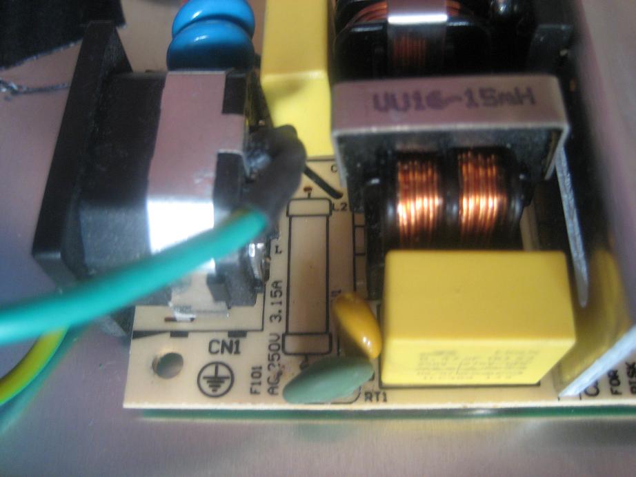

    I noticed a little chunk broken away from the thermistor (?) early in the AC power circuit. I don't know what this does but could this be a problem?

              That is a NTC thermistor. It's resistance decreases as it heats up. Measure thee resistance when it's cold; it should be something in the range of 10 - 50 ohms. If it's lower, it's shorted. I'd order a new one when buying parts.
              PlainBill
                #47
                Re: Soyo 24" stopped, help!
                The thermistor is measuring 3.7 Ohm at room temp. Diode D1 is good measuring .48 V in one direction only.

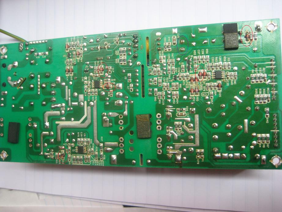

                The picture shows a big brown thing that I can't identify in the picture. Point G is one side and D is the other. Point J is one lead of the resistor to the right of the big capacitor. Point H is the negative lead of the big capacitor.
                  #48
                  There are a number of surface mount diodes and one zener diode (Top right corner but I don't really know the difference) that measure shorted when tested with the DMM diode function in circuit. I have circled them. There is one diode (circled in purple) that is a normal diode on the top side of the board that is reading shorted.
                    #49
                    If they're reading shorted, they probably ARE. But the only way to truly know is of course removing them from the board and testing them that way.
