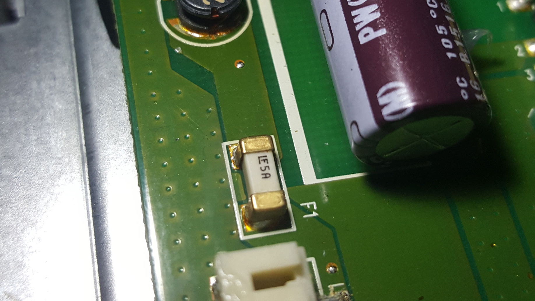

                      Your meter batteries must be low since you are getting 29.9Vdc feeding the inverter board, it should be around 24VDC.
                      The inverter fuse has to be bad, open circuit, because you are not getting the 24VDC on the two filter caps on the inverter board.
                        Re: Gateway 24" LCD Model LP2407
                        I'll go pick up a new 9V and post the readings again, but it was a new battery when I bought it around 1 month ago or less. Could be a bad one, could have left it on... we'll find out.
                        What does the inverter's fuse look like? Can it be swapped? Would make sense since the spark that jumped out of the socket when I messed up was about 3 inches long HAHAA

                          Fuse (White body with gold ends) designator is F1 as printed on the board right next to the inverter connector.
                            Cool. How can I make sure I order the right one? And can it be soldered in place?

                              Does it show very high resistance? If it does,then you may have done bad power MOSFETs the 8-pin SMD devices, that are shorted out. You will need to get the P/N so you can test the resistance between Source and Drain pins for low resistance readings.
                                How do I test the resistance for the fuse? If I set the multi to continuity and connect the gold sides and I get nothing
                                  I did the same at all Ohms ranges of the multimeter and got nothing on the fuse when touching both gold ends
                                    So you have blown fuse, so next thing you need to do is to check resistance between the two legs of those two filter caps to find out if it is showing >10 Ohms, if it does, then it can be solder bridge dues poor soldering works, shorted out power MOSFETs, you need to get the P/N of those MOSFETs.
                                    If they are shown as shorted circuit, then you need to get then new inverter board because I do not believe you can do surface mounted repair.
