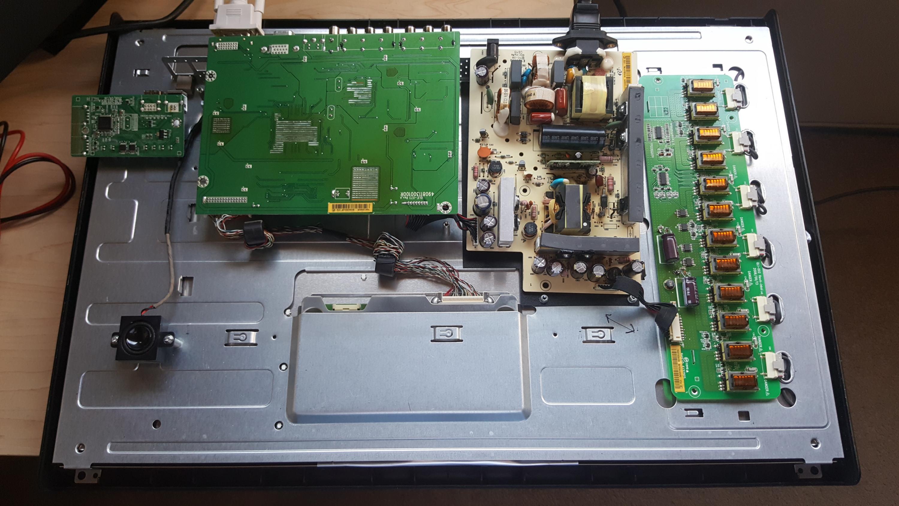

                Well I am pretty sure I am the worst solderer EVER... I swapped all the caps I mentioned and I am still getting the same, the buttons light up but I have no image.
                Is there a way to test whether I even got a connection on my two first (and WORST) solders? I couldn't get the pin to slide out and I made the horrible mistake of cutting it thinking it would be easier to pull out the little bit left in the hole.
                After a seemingly successful replacement of all power unit caps (way easier for some reason) I went back to try to pull the pin and it just wouldn't come out. I might have fried the board trying to heat it up but no matter what I tried I just couldn't, so I rigged the whole thing trying to get the pin from the new cap to make contact with a lot of solder... frankenstein still wouldn't wake up.
                It is clearly too much to ask, but try not to laugh at the second pitcure
                How can I test with a multimeter if it is the power unit or the LCD board that is giving me issues?

                  I would guess it has to do with the screen itself... I get no image with a DVI or with a component.
                  The lights of the menu turning on and off lead me to believe everything MIGHT be working fine but the LCD remains black.
                  I would love to test wether there is a good connection on those two suspect soldering jobs

                    Hi USchabon,
                    Recheck connection on your Nichicon 470uF 35V cap near C1,C2.
                    Do you remember the original cap position, where the white stripe
                    part goes to on the pcb? refer second picture on post #67.
                    Noticed at C1 there is a '+' sign, normally a '+' sign is positive, which
                    refer to the cap lead side with no white stripe. The white stripe is usually
                    for the negative cap lead side.

                        Hi USchabon,
                        Refer back your picture on post #59, on the original bulging
                        Nichicon 470uF 35V cap near C1,C2 - please desolder your new cap
                        and follow the original cap position in your new soldering job. While desoldering, when the solder is melting maybe you can try a small plier to pull off the extra leftover pin.
                        Since you are eager to know whether there is a good connection on those two suspect soldering jobs, the easy way is to test for continuity from your multimeter(DMM). Set your DMM to diode/continuity test, put one cap pin to your black probe and red probe to your pcb track. Then swap the probe. If the
                        connections are good, you should get both same readings.
                          #72

                          Thank you very much Mickey! Ok, so I reversed that cap. No, it still looks like crap I wasn't able to make it better
                          Good news is I tested it like you said and I get a beep when I put the negative to the pin and the positive to the third pin from the bottom on the power connection at the bottom left (next to the yellow sticker with a barcode). So it looks like there is a good connection.
                          On to the bad news... when I plugged it in I heard a quiet crackle noise. I am 90% sure it was the solder on the bottom of that LCD board touching the metal beneath. I applied electrical tape on the metal chassis and tried again, no crackle... BUT... and here is the really annoying BUT...
                          #$&$%!!! It looks like the plastic was very brittle from being exposed to heat for many years and it cracked pretty badly when I tried to plug it back in.
                          Now I am going to have to order this cable and I will have to wait to find out if I fixed it, or if I fried it Can someone please help me order that cable?

                            I tried plugging it in anyway, carefully, and I almost crapped myself when a big ass spark came flying out of the broken cable socket.
                            1. How can I test if I fried the power control unit?
                            2. Where can I order a replacement for that cable?

                              .... Mhhh... No. You will have to work a lot harder if you want that title . Believe it or not, I have seen worse.

                              Could you tell more specifically what you mean by "no image"? Black screen, gray screen, white screen? Does the screen turn OFF after a few seconds? What about if you connect it to a signal source - same thing?
                              Set multimeter to continuity (beep mode)... typically, this is also diode test.
                              Put one probe on a trace on the board where the capacitor lead connects and another on the capacitor lead's solder joint. If you get a beep, you got a connection.

                              If you have cutter pliers, you can still pull it out. Looks like you have the clearance on the side of that. So simply grab the pin with the cutters and use the board as a leverage to pull the pin out. Of course, while doing that, also heat the pin with your soldering iron on the other side of the board.

                              No, you can't really fry the board like that. The only damage you can do is lift or rip traces off. That usually happens more often if the iron is too weak (i.e. not hot enough) than too hot. So it looks like your 30 Watt iron is just not strong enough for the inverter board or any other multi-layer.
                              I guess I should have guided you a little better and recommended only the 60 Watt iron.
                              That said, have you tried using the provided rosin flux with your iron kit? If not, definitely give it a try. From the pictures of that kit, it looks like the flux comes as a solid. That means you need to chip small pieces each time you need to use any and dissolve the pieces in a few drops of IPA (Isopropyl Alcohol). Then, with the dissolved flux, you apply it on all of the joints you are struggling with and heat them up with you iron again. The flux should improve the heat transfer from the iron to the joint greatly. But make sure you iron has been plugged in for at least 5 minutes prior to that.
                              If you continue to struggle with that 30 Watt iron, there are auctions on eBay just for a 60 Watt iron and no accessories. I think those could be found as cheap as $3-5 (or you can try the irons from Home Depot I suggested previously). Having the right soldering iron for the job is really important. I've seen people who have never soldered before solder like a Pro when given the proper equipment. Same people struggled quite a bit before that with a cheap iron. Actually, I sort of started like that too.
                              If it was the power board, you wouldn't get power.
                              Just to rule out the inverter board... when you plug in a signal into the monitor, do the screen backlights come ON ans stay ON? What about the power LED on the monitor? Does it turn ON / change color to indicate that the monitor is receiving a signal?
                              I also have not seen pictures of the LCD logic/video board yet. Could you post a few? Some monitors have badcaps on those as well. The worst thing about it is that the caps there are usually small and almost never show signs of being bad. But if the logic/video board has hot parts or has been running hot, those caps can get toasted and eventually cause all sorts of issues too.

                              Oi! Is your new cap not bulged yet?
                              Typically when you install caps in backwards, it takes only a few seconds for them to go bad when you apply power.
                                We usually don't ask people to change them simply because most of the time those caps are not always critical and the logic/video board has really thick copper traces - makes it really hard for novices to change the caps on it. I would NOT attempt it at all with anything less than a 50 Watt iron.
                                Lots of hot spots on this monitor. The LCD board was a different color towards the bottom, and the logic board as well around the chips. See below.

                                  All caps look OK, the only one that could be slightly bulged is marked with a red arrow, but it may be pseudo confirmation bias... take a look. I do have extras for all of them since I ordered enough for 2 monitors.
                                  Also adding a detailed photo of the cable with the leads that are loose now... Only one of them has no plastic housing, the other three can be placed back in the remains of the plastic.
                                    Man, this thing looks like it came out of an oven.
                                    I'm pretty sure that the caps you see in this picture...
                                    https://www.badcaps.net/forum/attach...2&d=1466290679
                                    ... have dried up from all of the heat. They are Teapo brand too, which is well known for going bad on hot equipment. But again, we will get to this matter after checking the PSU (power supply unit).

                                    So, I assembled the whole thing and rested all the components on the metal chassis... The problem is that the underside of the power board may have touched the chassis (99% sure it did)...
                                    Well, I looked at your pictures carefully, and it appears that the power board is raised on metal stand-offs from the metal surface of the chassis. So unless you didn't trim the cap leads to proper lengths, that power board should bot be able to touch the metal chassis of the monitor. If you fear that it does, you could use either electricians tape or clear plastic from food container packaging... or cardboard (but I wouldn't leave these last two as permanent fixes).
                                      I think you are underestimating the level of stupidity I was exercising while sleepy and starving (cause I was too excited to do this that I didn't cook anything when I got home, lol...
                                      I literally had the board resting crooked and sideways at an angle so that the the part of the chassis that has the holes for the I/O inputs could make a better connection between just about any pair of soldering points on the underside of that board, yay for idiots with soldering guns! hahah...
                                      But I will not let this discourage me! I am having way to much fun
                                      I can prevent that from happening again by (as you said) resting it properly on its intended mounting points. There already is some kind of isolation mat under the power unit, so that's that really. Safe.
                                      I can also prevent contact with the chassis and the LCD board by laying down a double layer of electrician's tape where the Frankenstein soldering points are (this is already done and dusted). There is no doubt at all whether there was contact or not, it is 100% certain that it did happen. there is about 1.5mm of clearance and I needed about 2.5mm or more.
                                        ... to what I've been calling the LCD board (the one with the Frankenstein soldering job )
                                        If you are referring to this board:
                                        https://www.badcaps.net/forum/attach...1&d=1466290679
                                        https://www.badcaps.net/forum/attach...4&d=1466217947
                                        ... that would be the LCD inverter board. What that board does is it takes low-voltage from the power supply (typically 12-24 Volts) and boosts that to 700-1000 V (but high-frequency AC) needed to light up the CCFLs (cold cathode fluorescent lights).

                                          Ok, I completely removed the LCD Inverter and the little USB board, I plugged in the logic board to the power board (flipped and on the back of my mouse pad) then I plugged in the power board and took all the same measurements as before:
                                          LCD INVERTER CN ON THE POWER BOARD (left to right towards LCD Inverter):
                                          1. 0V
                                          2. 3.28V
                                          3. 0V
                                          4. 5.18V
                                          5. 0V
                                          6. 0V
                                          7. 25.9V
                                          8. 25.9V
                                          LOGIC BOARD CN ON THE POWER BOARD (starting from the red cable)
                                          1. 5.18V
                                          2. 5.18V
                                          3. 5.18V
                                          4. 5.18V (also red)
                                          5. 0V
                                          6. 0V
                                          7. 0V
                                          8. 0V
                                          9. 3.28V
                                          10. 0V
