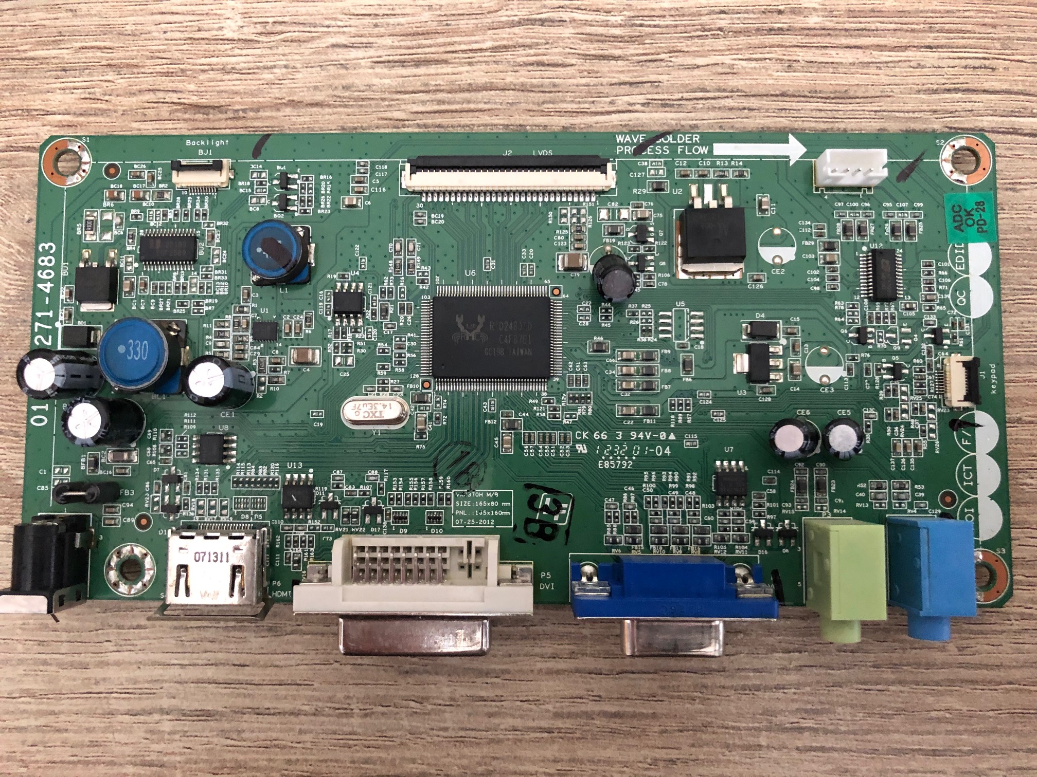

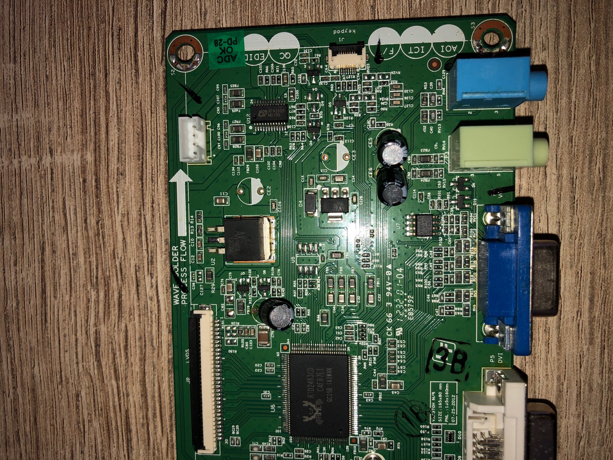

    I have a viewsonic monitor, model VX2370Smh-LED - a older unit, but I am fond of it and feel like this may be fixable.
    1/3 of the LEDs on the light strip for the backlight do not work when powered on, or, rather, they flash on for a half a second and then cut off.
    I've inspected the LED board and found that they all look ok, however running a continuity test with my multimeter shows some of them do not light up as 'steady' as some of the others in the strip, just a FYI, maybe a red herring?
    Because all lights light up for a half second before 1/3 do not, I think it may be the mainboard.

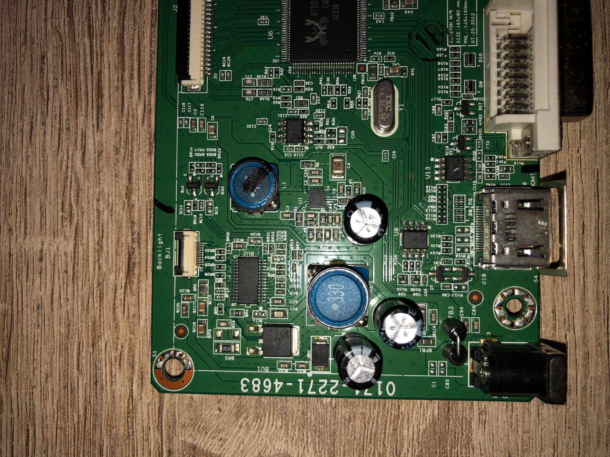

    As a FYI, there is a marker on the LED board at LED number 16 indicating LED (I mean, that makes sense since it's nothing but LEDS but anyway ) and there are clearly three segments on this board so that is why I am thinking it's a cap - especially how in the image of the board there are three caps near the power feed for the backlight..

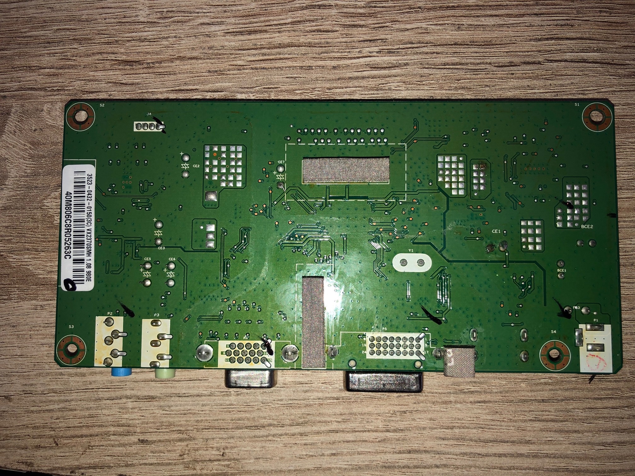

    I've had a search for schematics for the mainboard, but have had no luck.
    The number on the mainboard is 0171-2271-4683
    I've attached some photos as below to assist in any ideas. My gut feeling is a cap that is not able to hold its charge, however it has been more than a few years since I did this kind of thing so any help welcome!

    The caps are not for each led line, they are likely for the boosted led voltage which is common to the 3 strings, the caps are not the problem, you likely have one bad led on the string that won't light. One end of the led string connects to the boosted voltage, the other end (return) is controlled by the ic. If one led is open/shorted in the string the ic will detect the wrong current draw and shut down.

                And last but not least, those three bigger electrolytic caps on the main board by the "330" inductor appear to all be cheap brands. While they may not cause any issues anytime soon (or maybe never if the board runs cool and they are not over-worked), you could also try replacing them with quality Japanese brand caps if you intend to keep this monitor for a long time (and if you have the tools and time to do the soldering, of course.) Otherwise, you can just leave those caps as-is.
