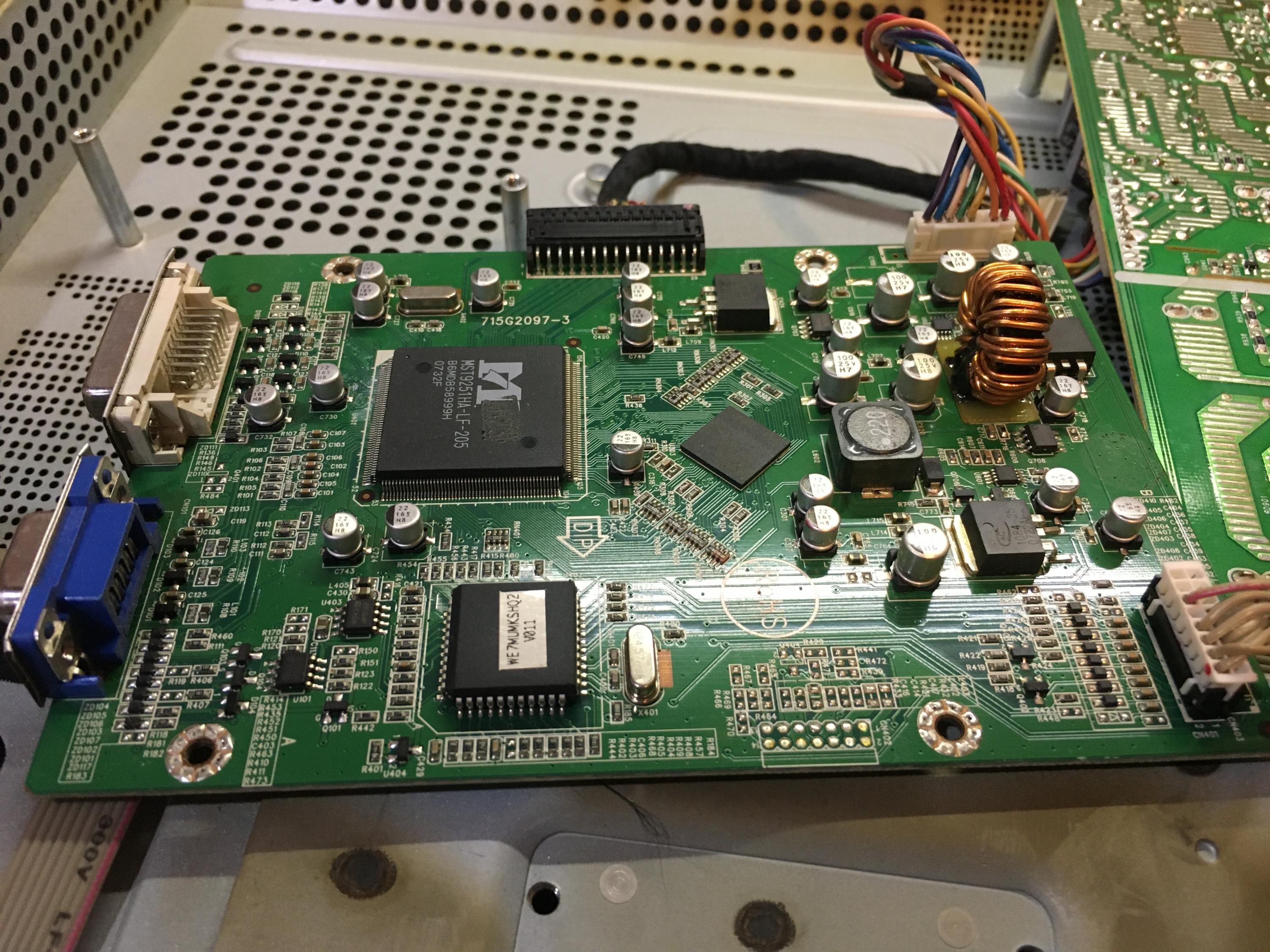

    Hi everyone. I have an AOC(?) Envision 24" computer monitor, model TFT24W90PS, Product name G416. Its worked fine for years but now has a yellow tinge on the screen. I tried various adjustments via the monitor controls but no good. I swapped the monitor with another to see if it was the video card or video cable but other monitor looks fine.
    I have it apart right now looking at the boards. I have replace the electrolytic capacitors on the inverter board but still same problem. All of the electrolytic caps on the power supply (and inverter board) visually look ok, no bulges or leaks. I am not finding any replacement boards or schematics for this model anywhere.
    Before I begin replacing other caps I thought I would check to see if anyone has any words of wisdom. Thanks in advance for any help.

                    Post a in focus, good quality picture of the main board, some of these boards had a problem with the caps on the regulator ic's a noisy regulator may or may not effect only the vga output.

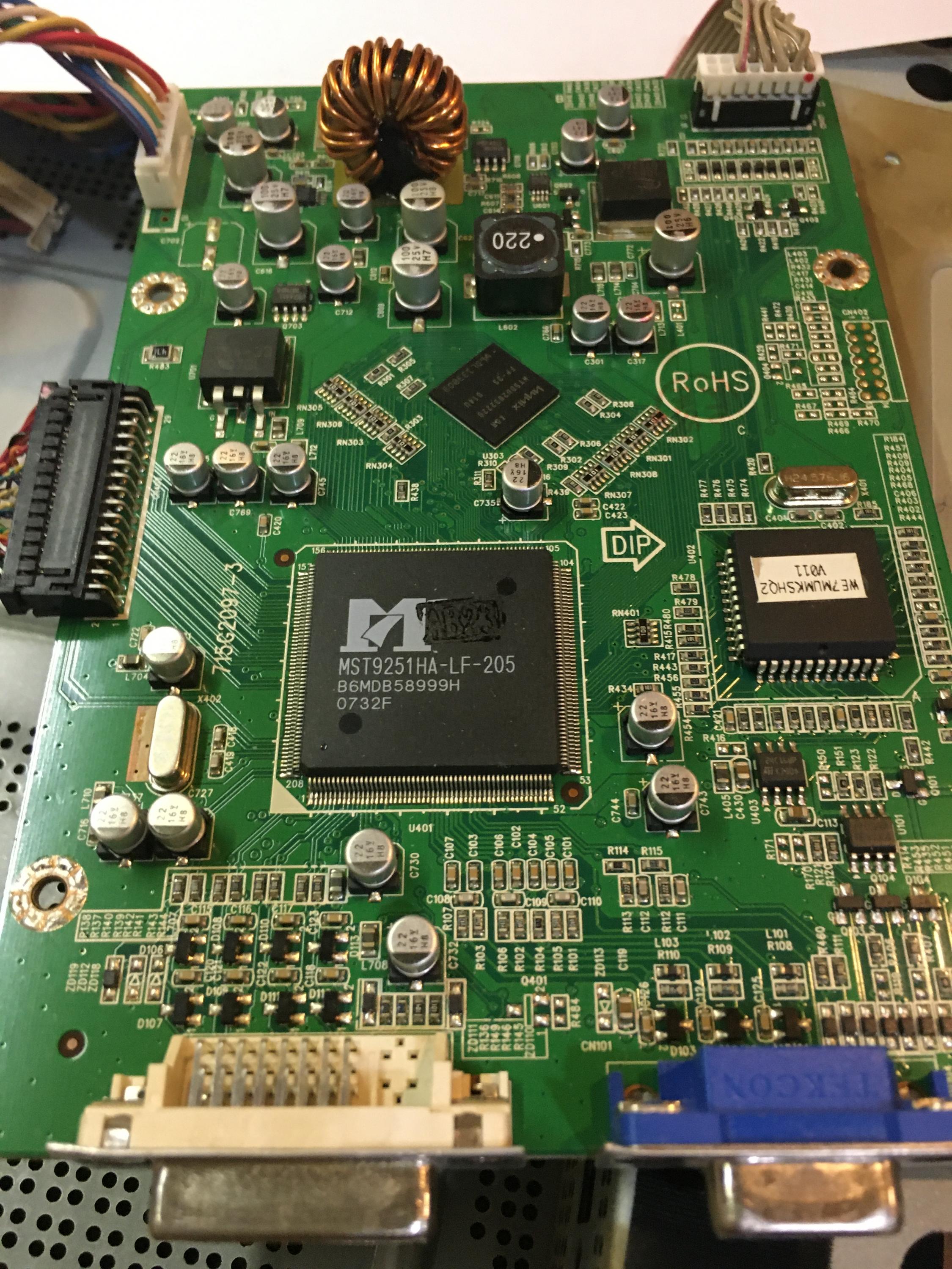

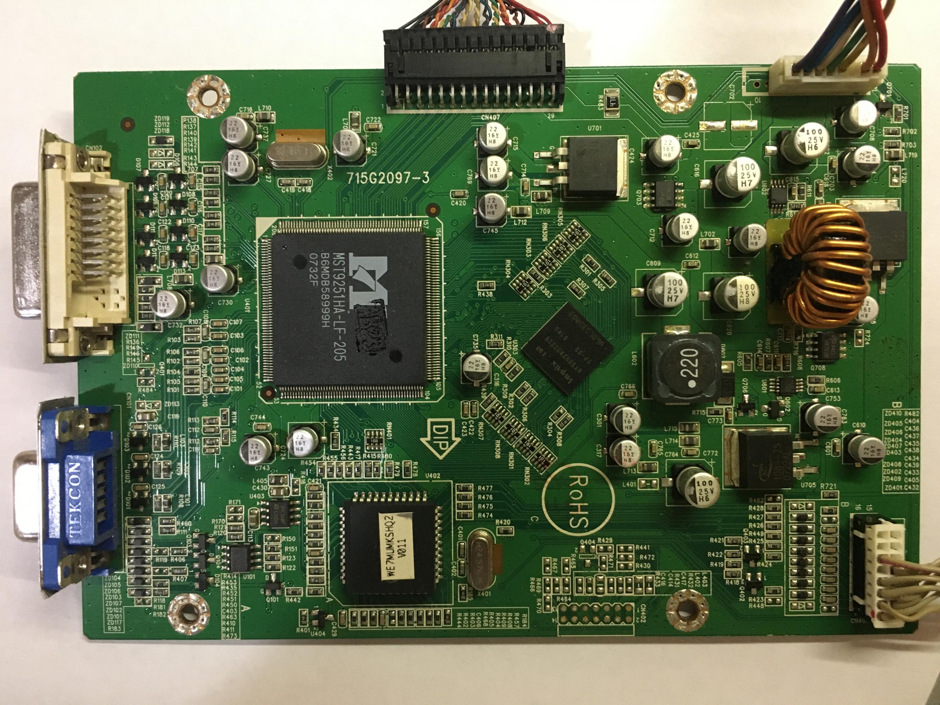

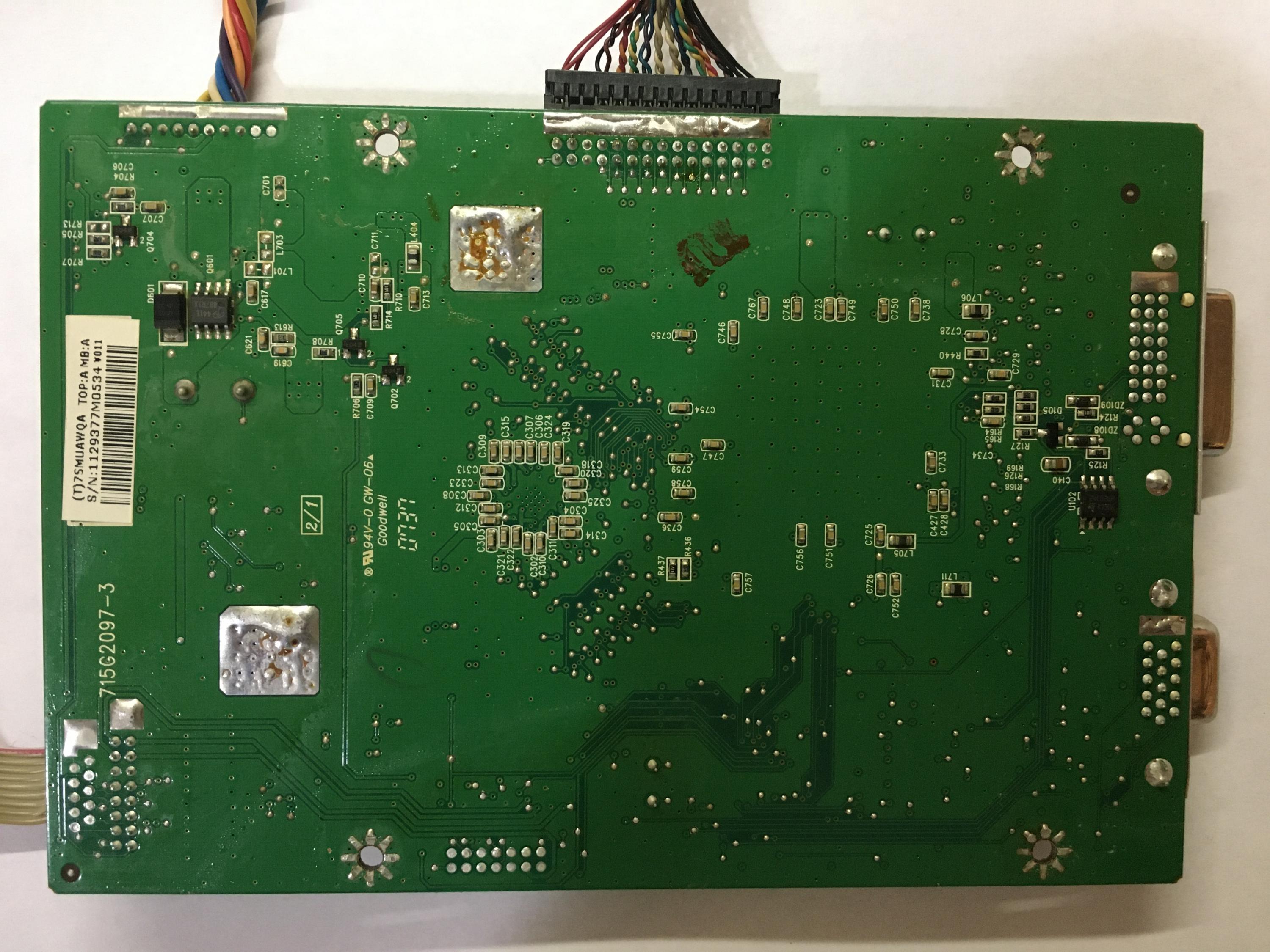

                      Thanks for your time. Here are 4 pics I took with my iPhone so hopefully you can see what you need to. If not let me know and I'll break out my other camera.

                            This is a different main logic board than I was thinking of with the cap problem. When I searched for pictures for this model it found a different board.
