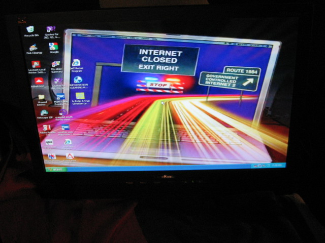

                  • junkmansam
                    • Nov 2009
                    • 51
                    Re: Viewsonic VA1912wb Recap
                    Or there MAY be nothing to troubleshoot.
                    PlainBill
                    Well Bill, you were correct in your assumption. Thanks a lot. Here is a pic of her all lit up.
                    One other minor problem. One of the bigger value caps is taller than the original and the top comes in contact with the metal cover. I was thinking of putting a piece of electrical tape between the cap top and the metal cover. Is that neccessary?
                      Necessary? Probably not. But a very good idea. Or glue on a piece of fish paper.
