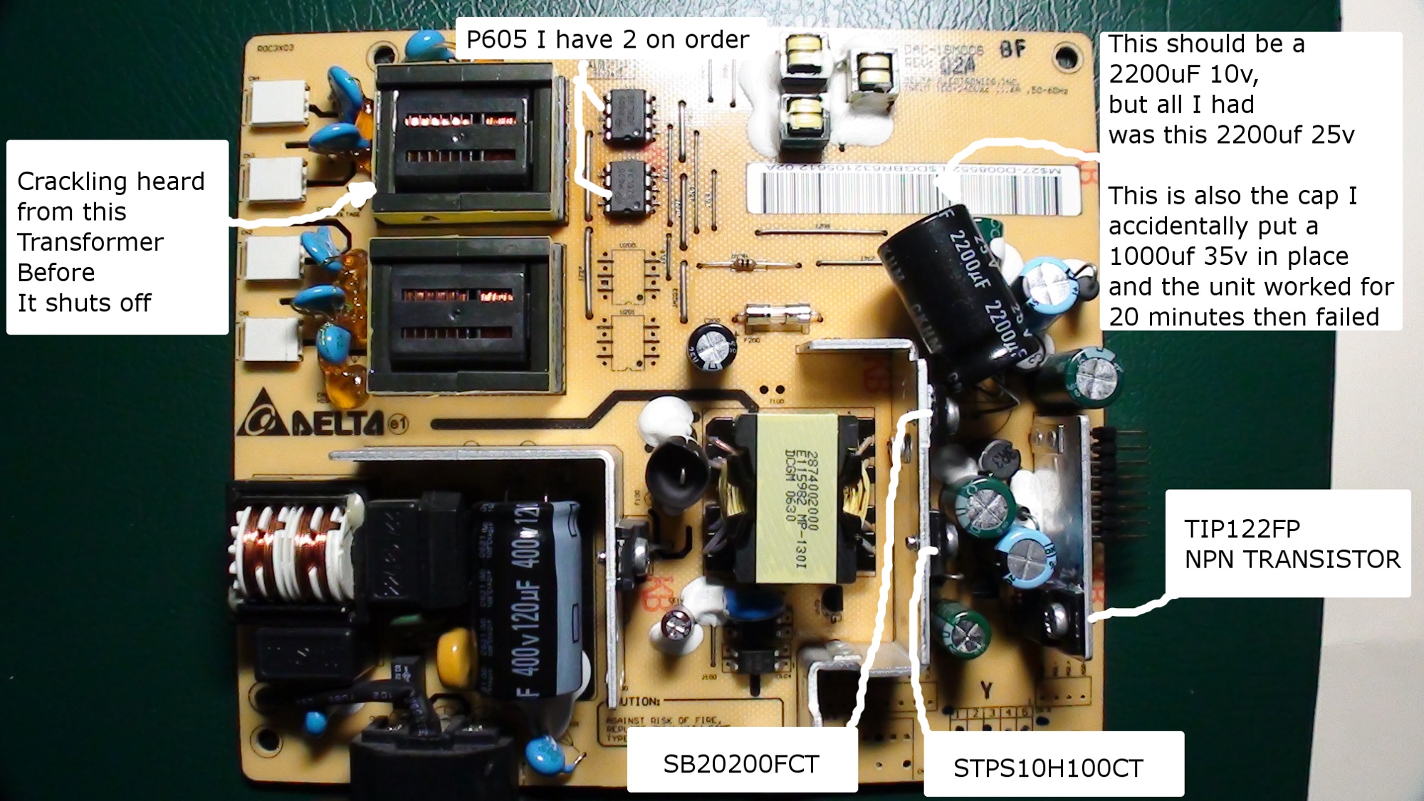

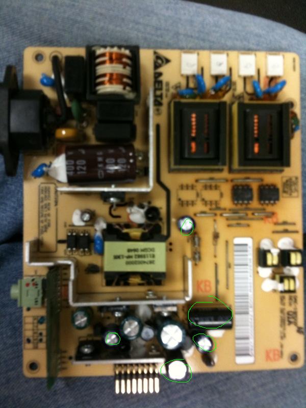

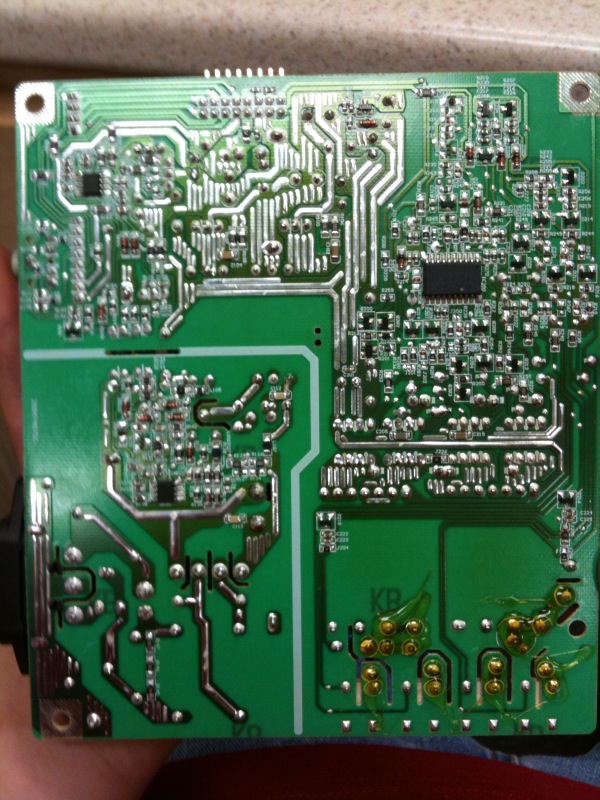

    This is my first attempt at fixing any kind of electroincs like this (I work with computers all day, but all we do is replace the whole thing.) I had to replace several caps on this unit and figured that was the cause of the problem.
    When I first plug it in the back lamps flash and then go off and dont come back on until i turn it off and back on again and they just flash again.
    any help would be great
    i posted pictures of the top and bottom and which caps i have already had to change because they were blown
    (If you need better pictures I can take some, those were done from iphone)

        @bradl450 -
        Replace the rest of the caps. Not the big one on its side though.
        Check the 2 transformers (side by side) with an ohmmeter and verify that their readings are the same.
        @capn_chris - Resolder the transformer connections to the board.

          Ok, I just desoldered and measured the two transformers that feed the CCFL bulbs.
          #1 transformer primary coil reads 1Ω
          #1 transformer secondary coil reads 360Ω
          #2 transformer primary coil reads 1Ω
          #2 transformer secondary coil reads 370Ω
          I am having a really hard time tracking down these transformers on the internet. I don't know what they should be reading. The markings on the side of them read
          2874001100
          M B 630 A
          they have a yellow band around them.
          Do those readings sound like your typical inverter circuit transformers?
            Re: DAC-19M009 Problems
            They match, they're most likely okay.
            The pics from bradl450 looks to show a brown "glue" around the trafos. Does yours have that also? If so, it's conductive and needs to be cleaned off. You've replaced the caps and now have improved the functionality so perhaps the tubes have failed? The unit may now be putting the correct power out to the old tubes and they can't handle it, causing the OC protection to kick in.
            Use a paper towel roll tube up to your ear as a stethoscope of sorts to narrow the sizzling sound. It's a high voltage leak or arcing that you're hearing. Also check the connections at the tubes.
            Clear pics of -yours- would be helpful.
              Ok,
              That was a brilliant idea about the cardboard tube as a stethoscope. I tried that and I think I can pretty well say the crackling is coming out of those transformers that feed the ccfl tubes. I am posting pics of my board. Tomorrow when everything is open once again I am going to try and get the exact capacitors that I need. I have fixed lcds before using higher voltage caps, and it usually works. In this case I did accidentally put that 1000uF 35v where 2200uF 10v belonged. It did work well for 20 minutes, but like I said now its on for 1 minute then off quickly. not sure which component I burned or screwed up with that mistake. Here are some better pics though. Hopefully my p605s will get here in the next couple of days.

                Whoops! I think I see the problem.
                What brand and series caps are you using? SMPS -require- low ESR caps. That big one you subbed and the little blue ones look like General Purpose (GP) caps such as you would find at Radio Shack.
                Please report all brands and series (usually a 2 or 3 letter code near temp rating). Include originals info too.
